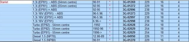

Glanza1996 Posted May 26, 2016 Share Posted May 26, 2016 (edited) Im after some new discs and pads for my glanza has anyone tried these and are they any good? Cheershttp://www.ebay.co.uk/itm/OEM-SPEC-FRONT-DISCS-AND-PADS-238mm-TOYOTA-STARLET-1-3-EP91-ABS-1996-00-/121756503357?hash=item1c5940cd3d:g:PioAAOSwHmhV8e8X Edited May 26, 2016 by Glanza1996 Quote Link to post Share on other sites
Glanza1996 Posted May 26, 2016 Author Share Posted May 26, 2016 (edited) I just noticed it dont say on there about abs and I got abs :/ Found some how are these ones? http://www.ebay.co.uk/itm/OEM-SPEC-FRONT-DISCS-AND-PADS-238mm-TOYOTA-STARLET-1-3-EP91-ABS-1996-00-/121756503357?hash=item1c5940cd3d:g:PioAAOSwHmhV8e8X Edited May 26, 2016 by Glanza1996 Quote Link to post Share on other sites
morgey Posted May 26, 2016 Share Posted May 26, 2016 Glanza brakes are 256mm. The abs thing shouldn't matter on the front as the abs pickup is on the cv joint not the discs. Rears on the other hand do have Abs and non abs Quote Link to post Share on other sites
Glanza1996 Posted May 26, 2016 Author Share Posted May 26, 2016 Okay nice thanks. I just found this. So im guessing these will do the job http://www.ebay.co.uk/itm/TOYOTA-GLANZA-STARLET-TURBO-EP82-EP91-FRONT-BRAKE-DISCS-PADS-/300410303287?hash=item45f1d97337:m:mRXQTfRPc2sMQVwNf1gd-Qw Quote Link to post Share on other sites
morgey Posted May 26, 2016 Share Posted May 26, 2016 Yep they should fit fine. Quote Link to post Share on other sites
