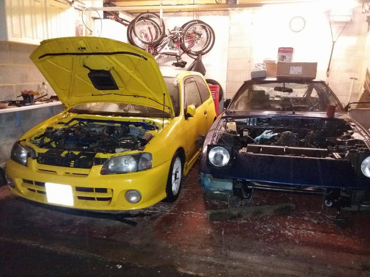

Ryncewind Posted January 31, 2017 Share Posted January 31, 2017 Ok so I've lost spark in my Glanza, Bare with me while I do my best to explain from the start. Yesterday I fit my JDM EP engine bay dress up kit, In the process i snap the breather from the rocker cover to the inlet, Ooops, Temporarily block the rocker cover hole with an o2 sensor bung till I can get a catch can on there. Finish putting the kit on, Start the car up, instantly revs to 3k, Bummer. Remembered i didn't plug the breather hole on the intake so i go and block that off too with some pipe and a bolt. Start the car up and idle is now at 4-500 RPM and not the usual 900RPM ish, I assumed it was down to the breather as that was the only thing different so I left it and didn't think much else about it, Well today I went for a drive, not a spirited one. Did Bradford to Leeds without any issue, parked car for half an hour and set off home, I'm coasting in 5th down Stanningly bypass, Look at the clocks and my RPM is at 0 (I'm rolling in 5th) Car won't start at all, + a few hours cars recovered back to my mates and we're looking around, No spark at the plugs, Coil is getting 11.6V, Nothing is coming out of the coil though, Stuck a screwdriver in the king lead and there was no arcing from it. Checked the ground on the coil and it seems good (assuming it does ground through the firewall bolt?) Having a read up on google and it seems to be pointing to the Igniter as that sends a signal to the coil I believe. Apparently this would also explain why the RPM's showed 0 even though i was doing 50 or so in 5th. Everything was fine before I put the dress up kit on, Maybe I've messed up the earth on the igniter and killed the unit or something? Anyone got any ideas? Thanks in advance, Sorry for the long post! Quote Link to post Share on other sites
