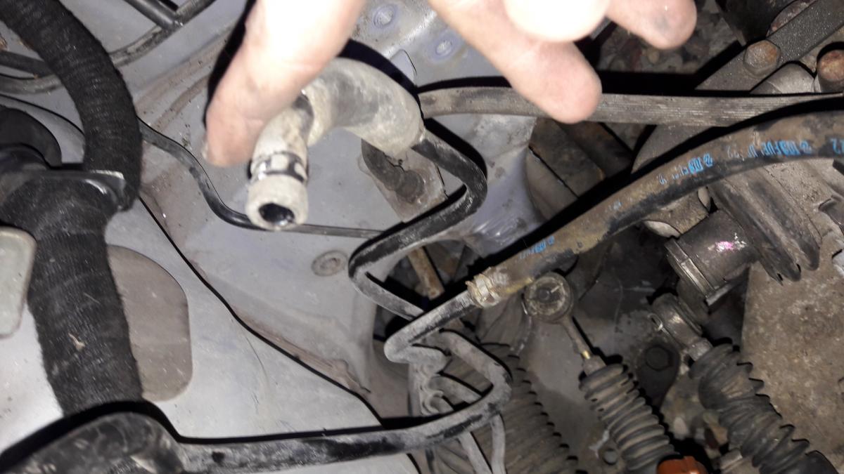

Bin all the charcoal canister stuff. I just put a bit of silicon pipe on the hard pipe that used to be connected to the canister and ran it back out under the car so it can vent out.

Is that the pipe that comes from the bunch of lines on the left and goes to the canister ?
Yes, I never thought of cutting mine back, would have been a good enough idea.
