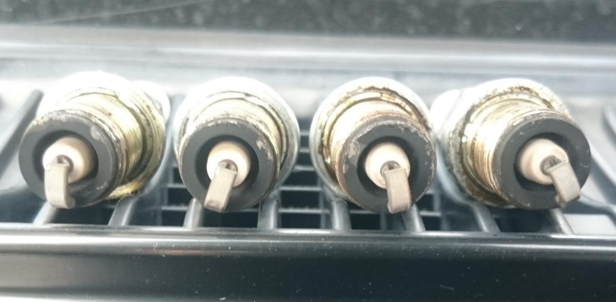

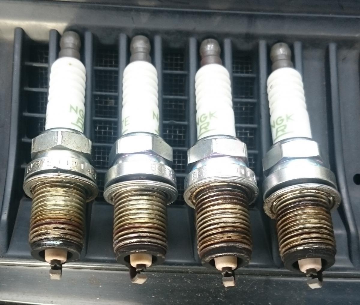

Nafeez2125 Posted May 17, 2017 Author Share Posted May 17, 2017 Im sure mine is overfuelling take a look at the spark plugs. it looks like its running rich. ive been told that the stock ECU is suppose to run rich. It doesn't smoke but when you touch the inside of the exhaust there is a layer of that black sooth Has any one heard of or use marvel mystery oil? Quote Link to post Share on other sites
