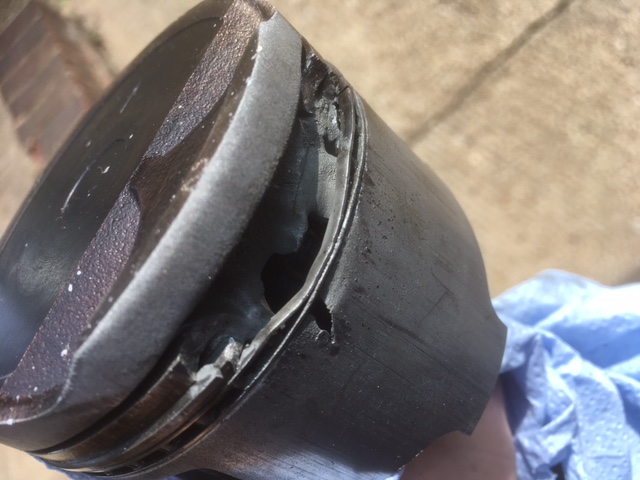

Ryncewind Posted May 24, 2017 Share Posted May 24, 2017 I suspesct my ringlands have gone after reading on the forums but would appreciate some opinions. Car was smoking like mad but only on idle, i blocked the pcv and it stopped snoking after 10 mins or so. The turbo isnt leaking ive had that off and checked it. Compression test results wereDry - 140 170 150 150Wet - 170 170 180 170I took the oil cap off with the engine running and its blowing through that like mad, I can feel it pulsing, my breather next to the oil filler is also drowning in oil. Appreciate any input. Thanks! Quote Link to post Share on other sites

gorganl2000 Posted May 24, 2017 Share Posted May 24, 2017 sounds like cracked piston ringlands...by the looks of it cylinders 1, 3 and 4 Quote Link to post Share on other sites
Socks Posted May 24, 2017 Share Posted May 24, 2017 If you had cracked piston ringlands. There would be a much more dramatic difference in psi on that cylinder. Quote Link to post Share on other sites

Kursaal Posted August 20, 2017 Share Posted August 20, 2017 My efte was breathing a bit, a bar of boost soon sorted it out! Quote Link to post Share on other sites
5e colin Posted August 20, 2017 Share Posted August 20, 2017 That's a bit more then ringland failed hey Quote Link to post Share on other sites
federalman Posted October 23, 2017 Share Posted October 23, 2017 Yeh the a bar of boost kills 4efte's rumour isn't a rumour. Quote Link to post Share on other sites
ramses Posted October 23, 2017 Share Posted October 23, 2017 a bar of a ct9 is not really a bar of vf35... what is your turbo? at what afr were you driving ? Quote Link to post Share on other sites
