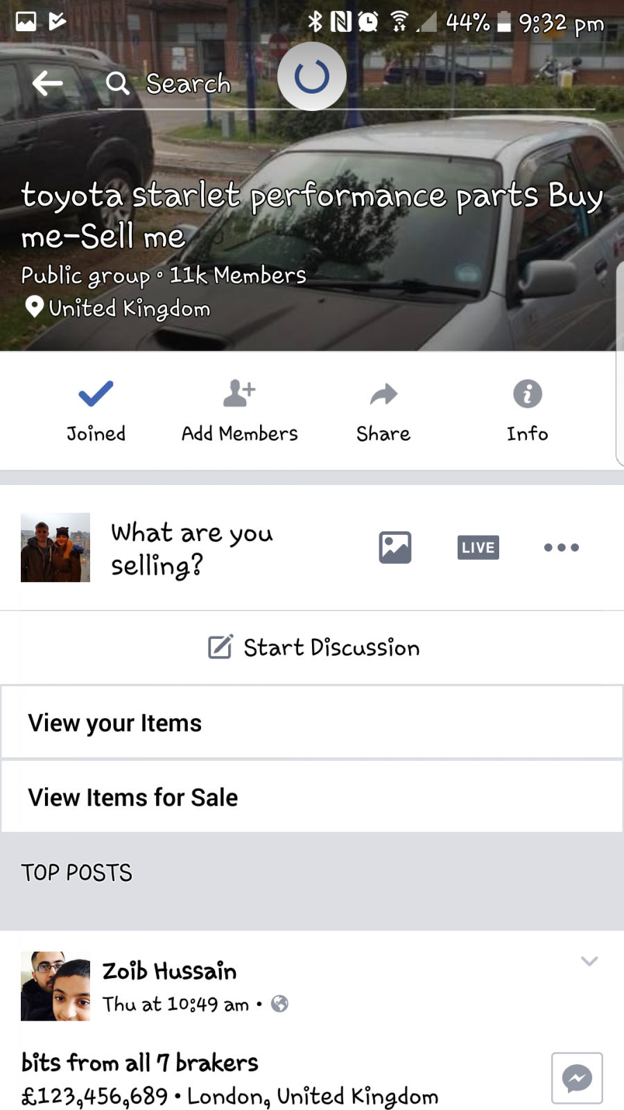

Get in contact with zoib on here or facebook he has a couple forged engines for sale from breaker cars!
James
Edit cant cant seem to paste links for you mate so screen shot them on here

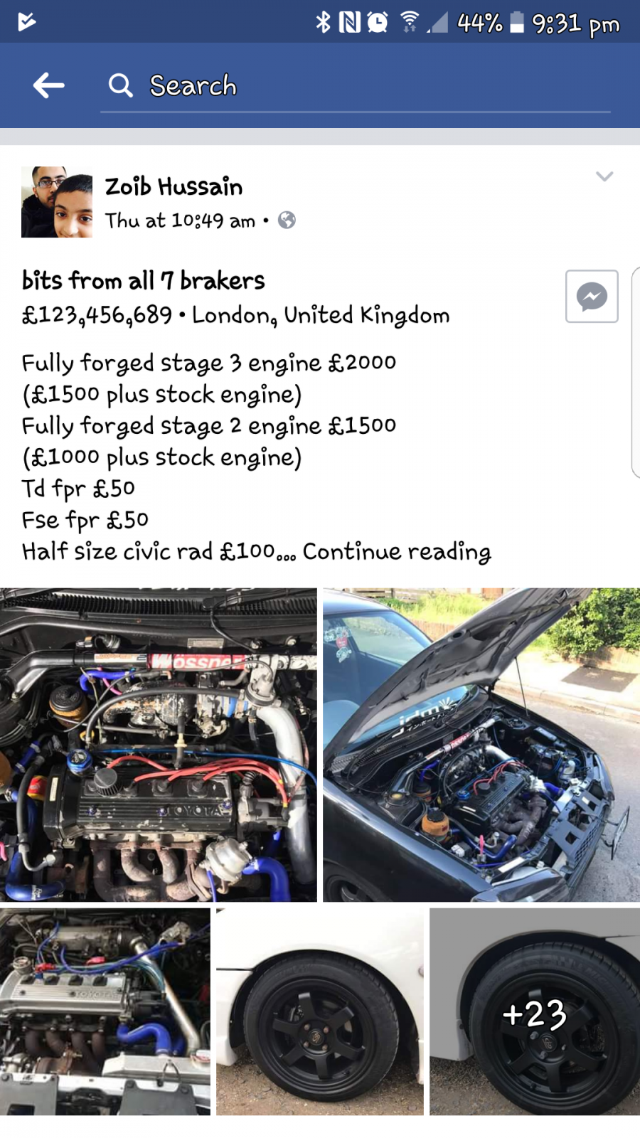

Well the chap in the pictures above selling a "Fully forged stage 3" for 2k. TD's stage 3 DIY kit comes in at £1,400. Just have to find an engine builder but i can't see them charging 600 quid to build it hah

I wouldn't be so sure, you'll need to factor in decking the block, checking the head over, honing and cross hatching and then reassembly, plus all the new gaskets and seals. You getting the head checked at the same time? May as well if you're going to drop all that cash on the bottom end tbh!
All the gaskets and seals come in the DIY forging kit from TD. Even if skimming the head and block and honing it and building the engine all comes in at 2k (including the parts) That's the same as Zoib wants for a second hand one. I suppose it makes sense to have a brand new one build instead of buying second hand, unless I'm missing something.
