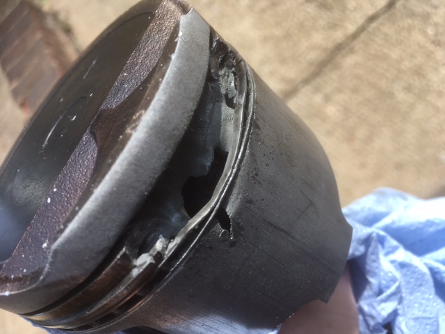

Its wrong answers bhp these are turbo motor's so stick to max boost 1bar is safe for tdo4 size turbo after that the ring lands start failing its a lottery some had ringland failed at a bar
Posted elsewhere but tired engines don't take to boost too well!post-15273-0-64391600-1503832456.jpeg

The power output is almost irrelevant and there isn't really a "safe zone", its the state of the engine, how its been setup and tuned that's key. I've seen engines with stock or even less hp let go due to a bad tune, bad setup or poor engine health.
If you are a careful and methodical tuner and you look after your engine then there is no reason why you can't run decent power reliably. The NZ record holding quarter mile of 11.75 was set 9 years ago using a 5e with stock 4e pistons and stock 5e rods. That engine is still unopened to this day albeit retired from drag racing and is a circuit car now. Saying ring lands will fail at a certain hp is not 100% true. Id be more inclined to look at the reason the ring lands have let go and you will find that in a lot of situations (granted not all) the tune or some other factor is at fault. Overly aggressive poorly planned ignition tables, or inconsistent afr's, or aggressive boost curves, or too high a rev limit, or even the type and config of the rev limit (fuel vs ignition cut and how it applies etc) etc all play their part. There will always be cases where there is no obvious reason why a piston has let go and the casting process can be a factor, but with a good tune there is no reason why you can't push some very reasonable hp numbers. I guess what i'm saying is listen to your engine as its being tuned and you will get a feel for what makes it happy. Keep it happy and it should stay reliable.
