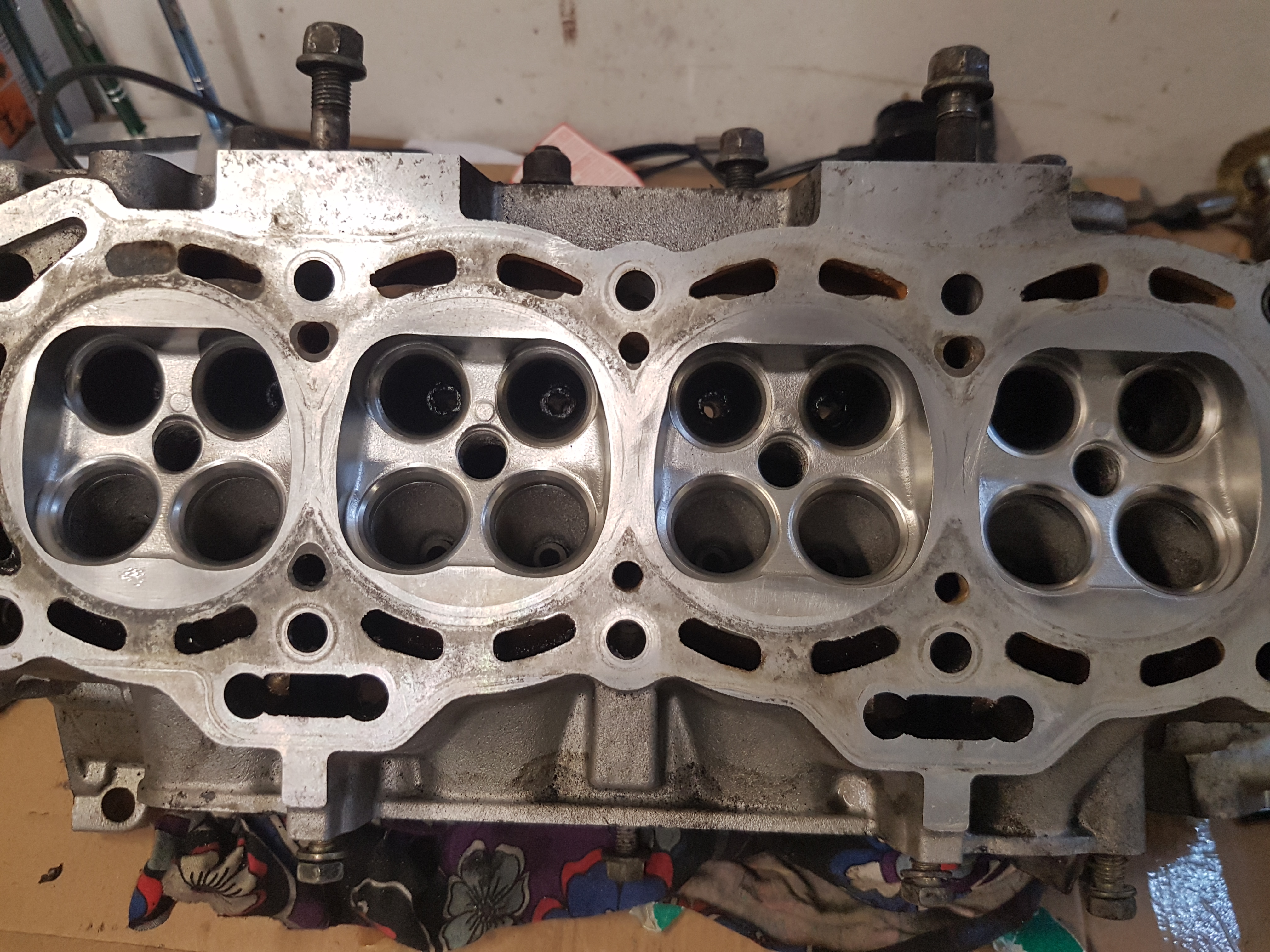

daniel_g Posted November 2, 2017 Author Share Posted November 2, 2017 I wouldnt say pointless either haha. He is a local engineer, top man, builds a lot of engines. Mine has already has a mild port to both sides by him. He said when initially building my 4e that head studs were a bit unnecessary aswell. He has build a few 4e engines that have ran over 300bhp with a stock head, and there are better ways to spend 1k area. Which i do agree with but i will have more headwork done at some point. Was just seeing what could be done, now i know most of the 4age stuff works so thats ideal! Quote Link to post Share on other sites
