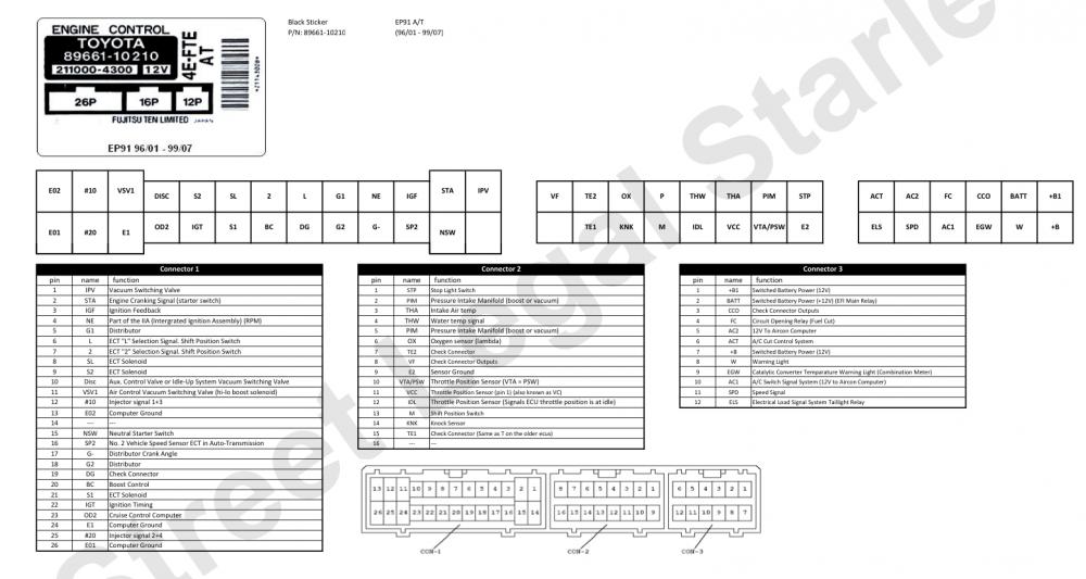

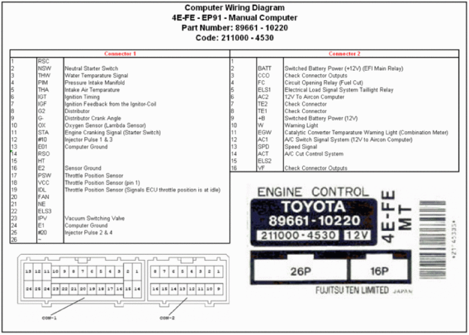

so ive not a turbo 4EFE just wired up the det 3 ecu and i cant get the ignition adjust to work. ive got the link for my pin out and when i cut pin 6-igt and wire the det 3 for igt in and igt out it wont start. ive tried all different setting etc on det 3 and nothing helps. i can get rpm read out when i wire just the ignition in wire to pin 6 but i cant adjust it. any one know about the ecu det 3? cut map wire and connected the det 3 to that and adjusting fuel works fine just the ignition side ive tried all sorts. any help would be good. thanks

Cut pin 6 (IGT) on Connector 1
Cut pin 4 (PIM) on connector 1
Det 3 ignition IN goes to the ECU side of the IGT wire
Det 3 ignition OUT goes to Engine side of the IGT wire
Det3 Analogue IN 1 goes to Engine side of PIM wire.
Det3 Analogue OUT goes to the ECU side of the PIM wire.
Then just connect switched power and earth to the DET 3.
Your done.
Yes it will work you just need to setup and pinouta switch or button for activation.
