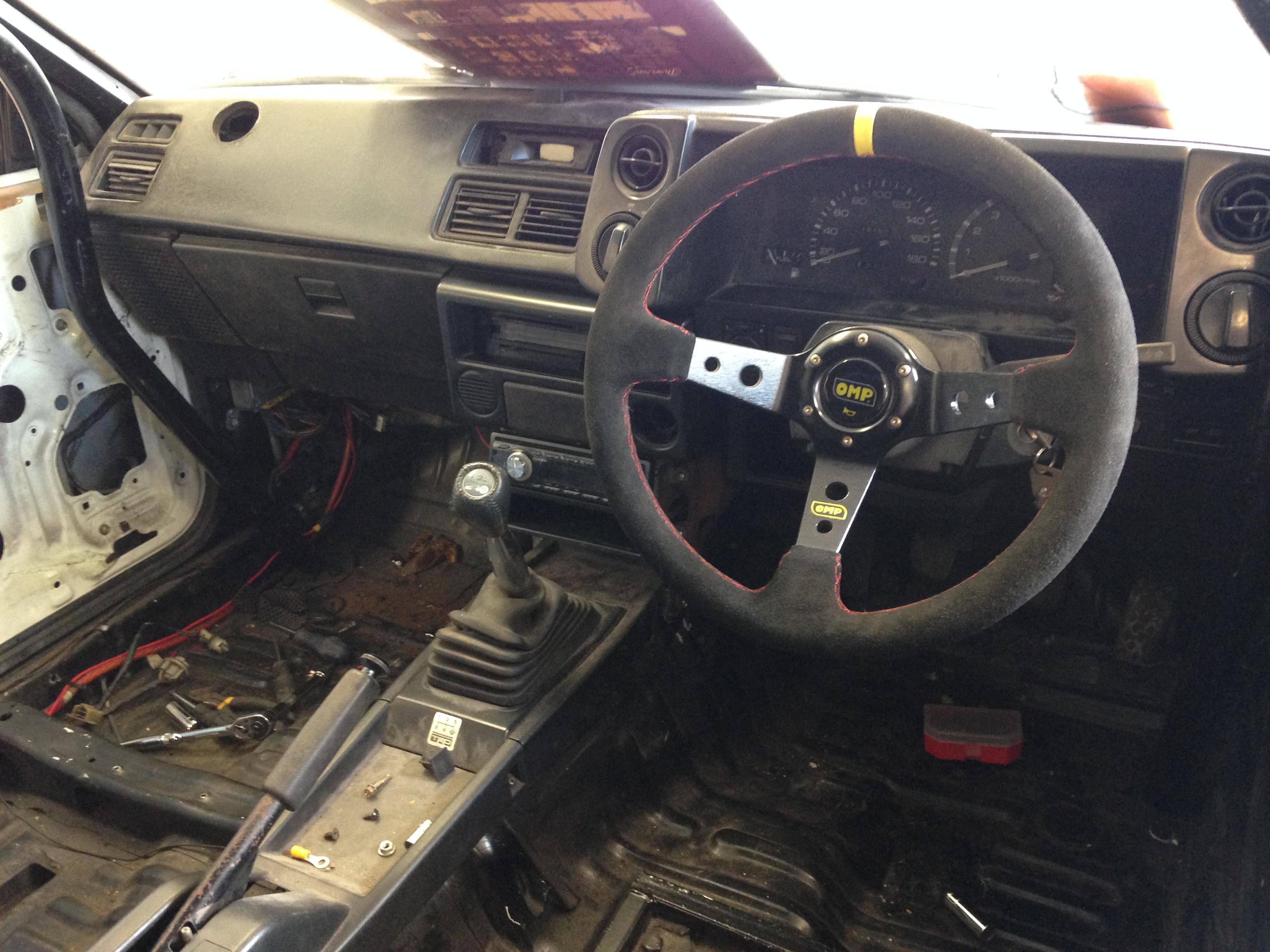

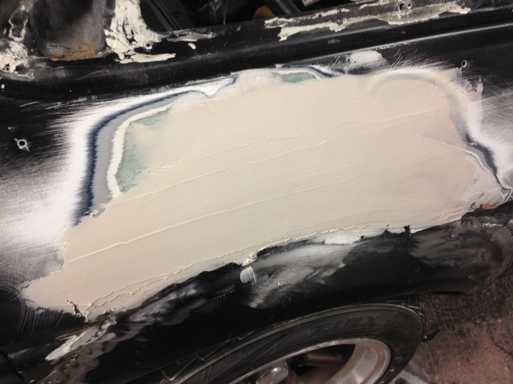

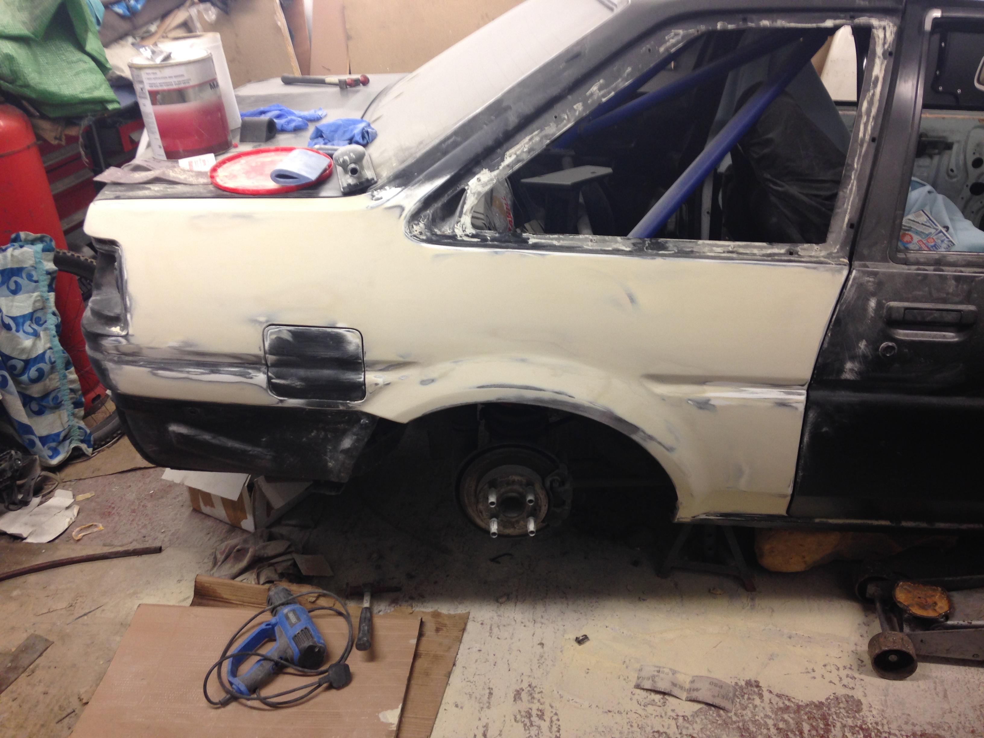

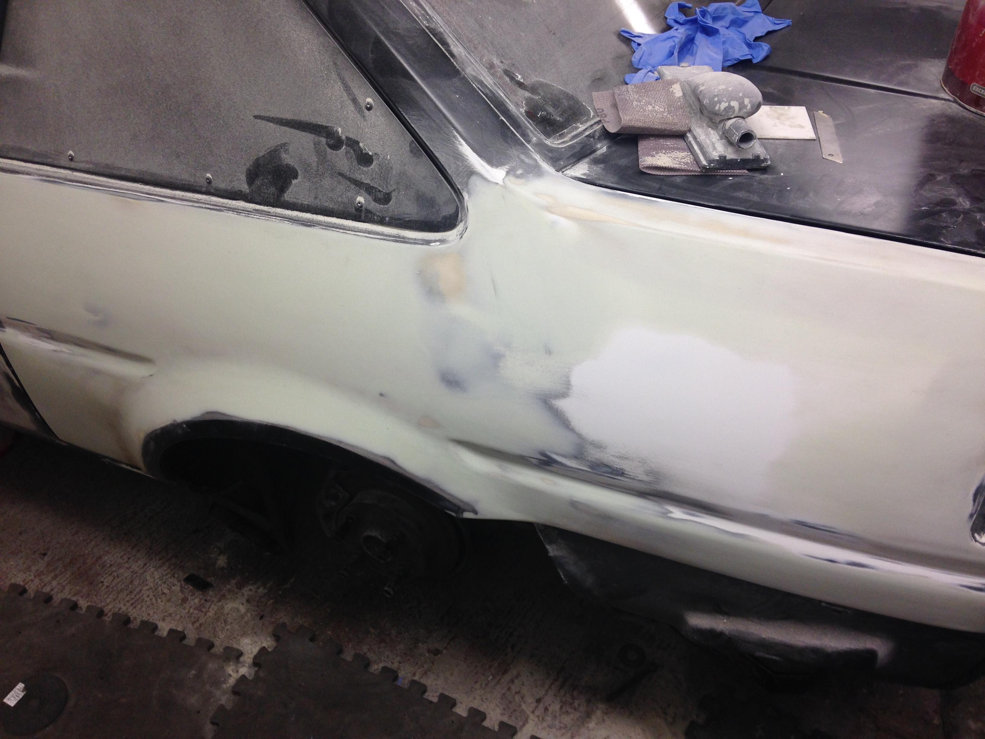

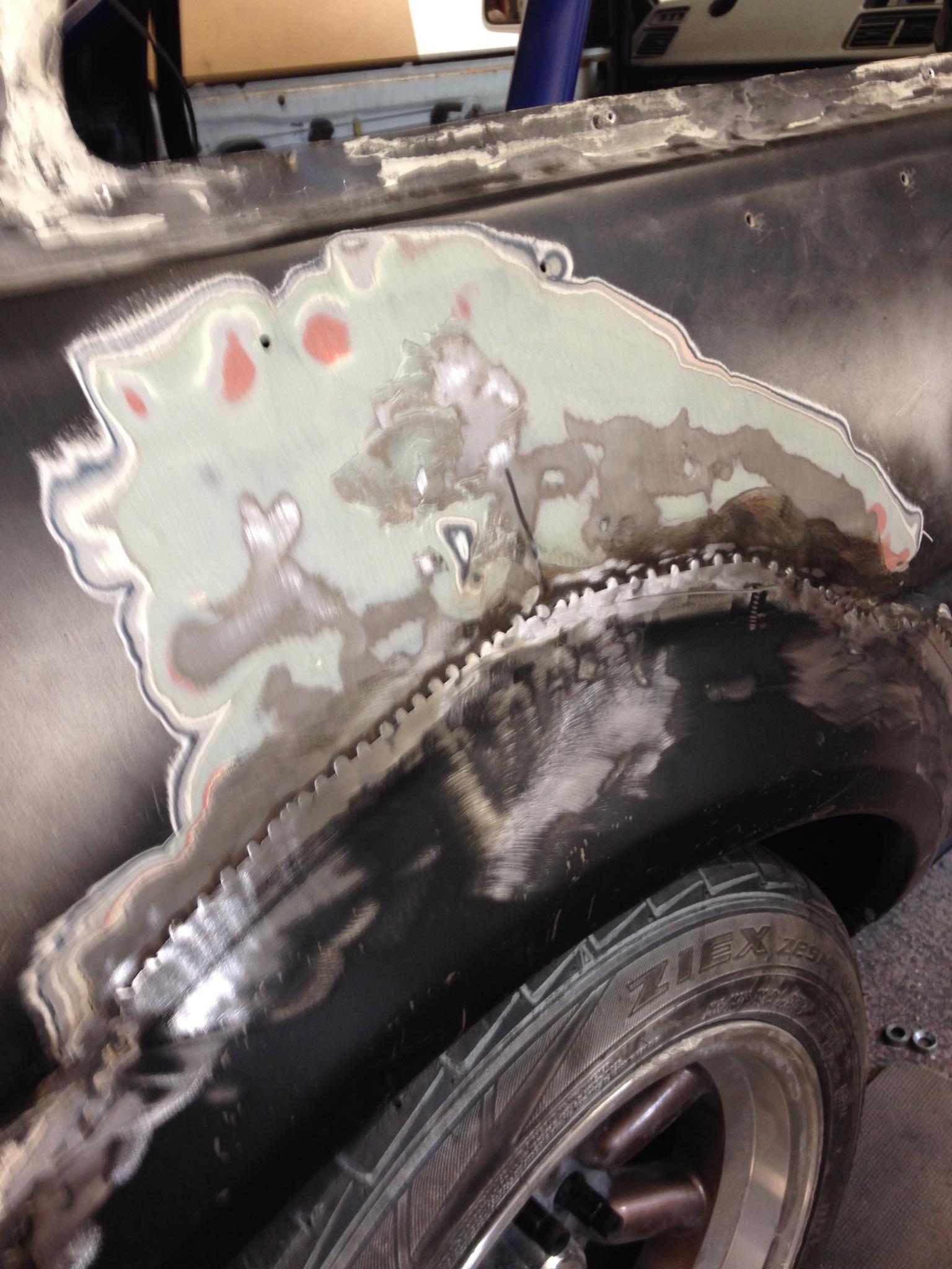

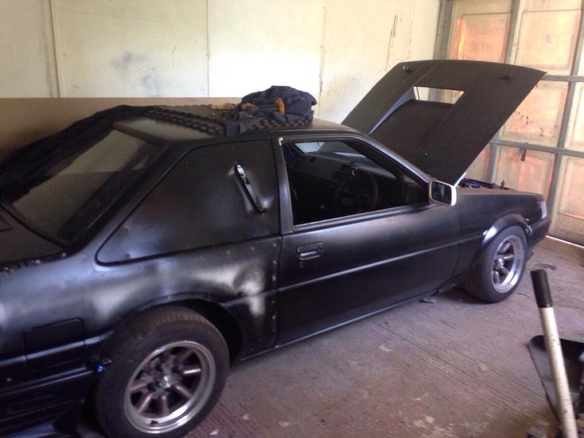

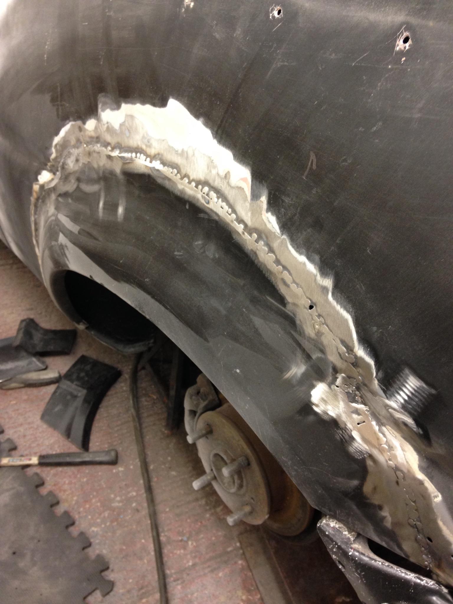

Kieran Barber Posted April 27, 2018 Share Posted April 27, 2018 (edited) So, I've had this ae86 for nearly 18 months now and progress has been slow, but progress is progress in my eyes, so here's quite a few pics of what i've done as of now. the 2 pics above are when i got it, it originally had overfenders on so we took them off and then we made some mk3 escort arches to fit in the pics below. after that, we got some filler on them as seen in the pics below. we then managed to get the heaters and vents all bolted back in, unfortunately, the previous owners were careless with removing the cables so they can't be operated. Edited October 12, 2018 by Kieran Barber reuploaded the pictures Quote Link to post Share on other sites

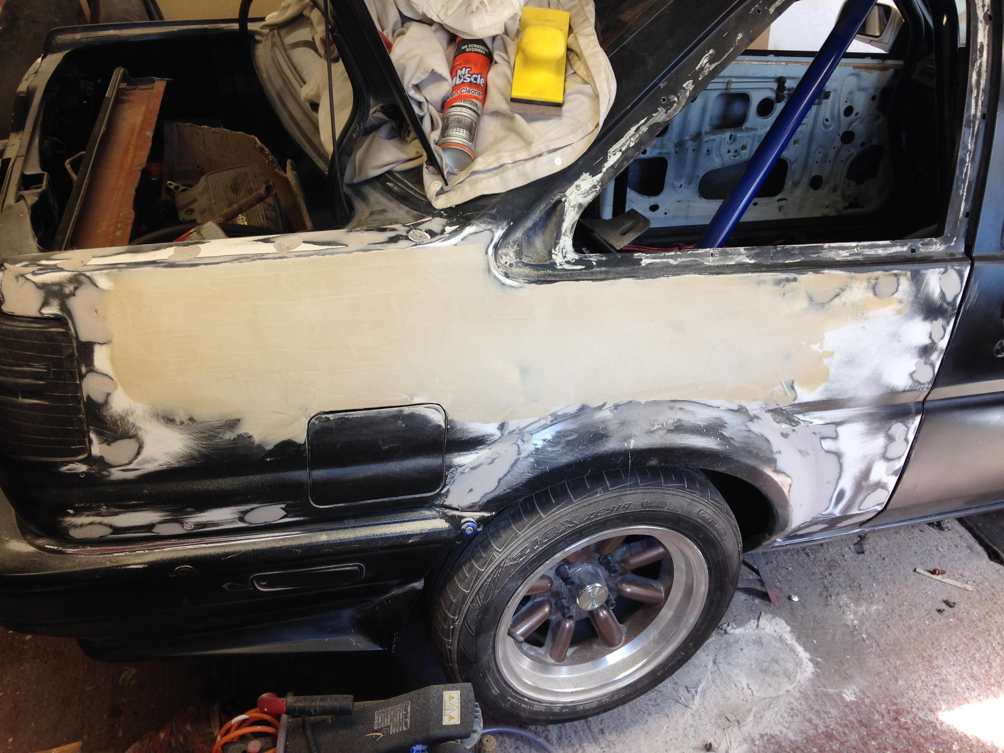

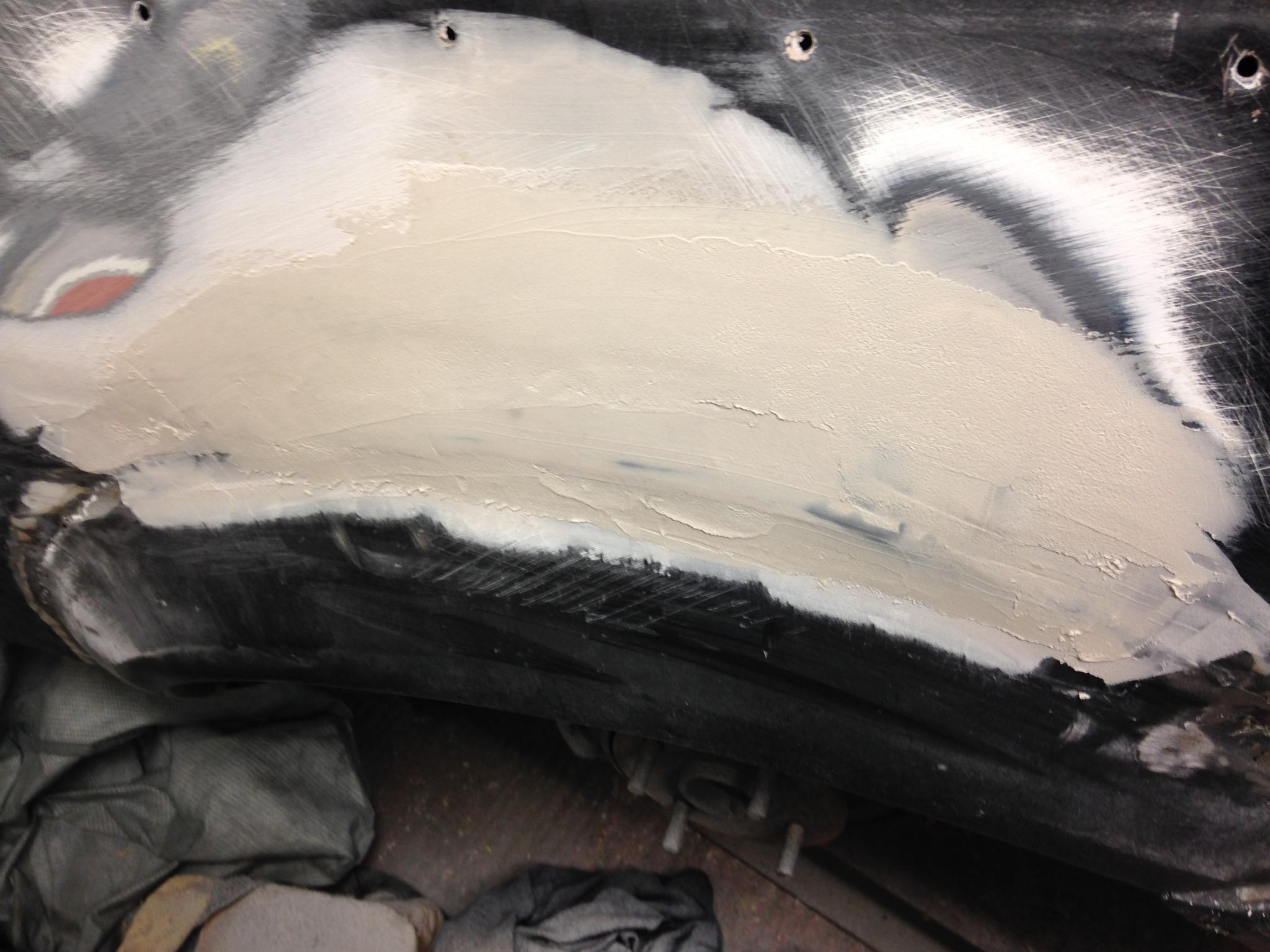

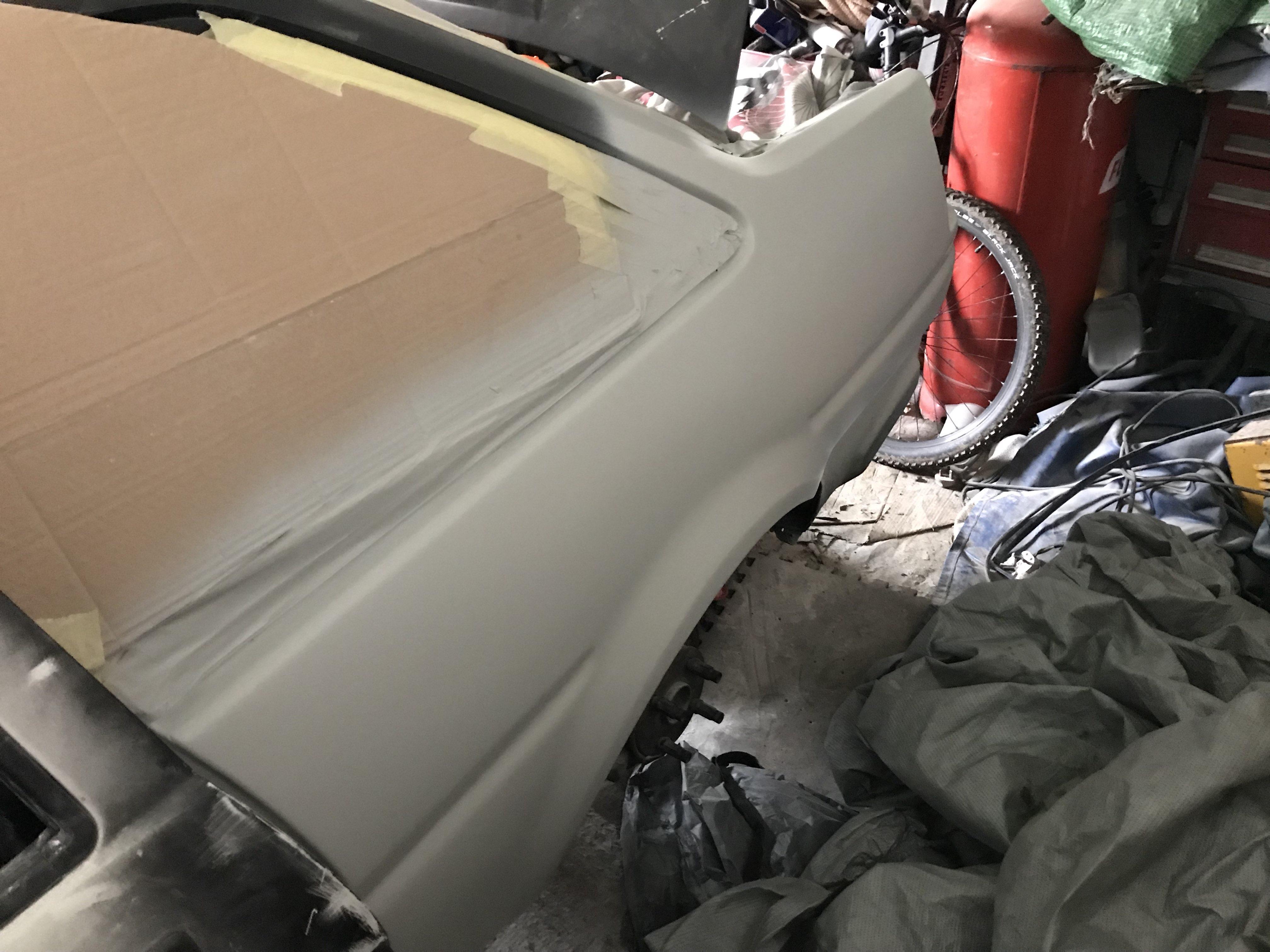

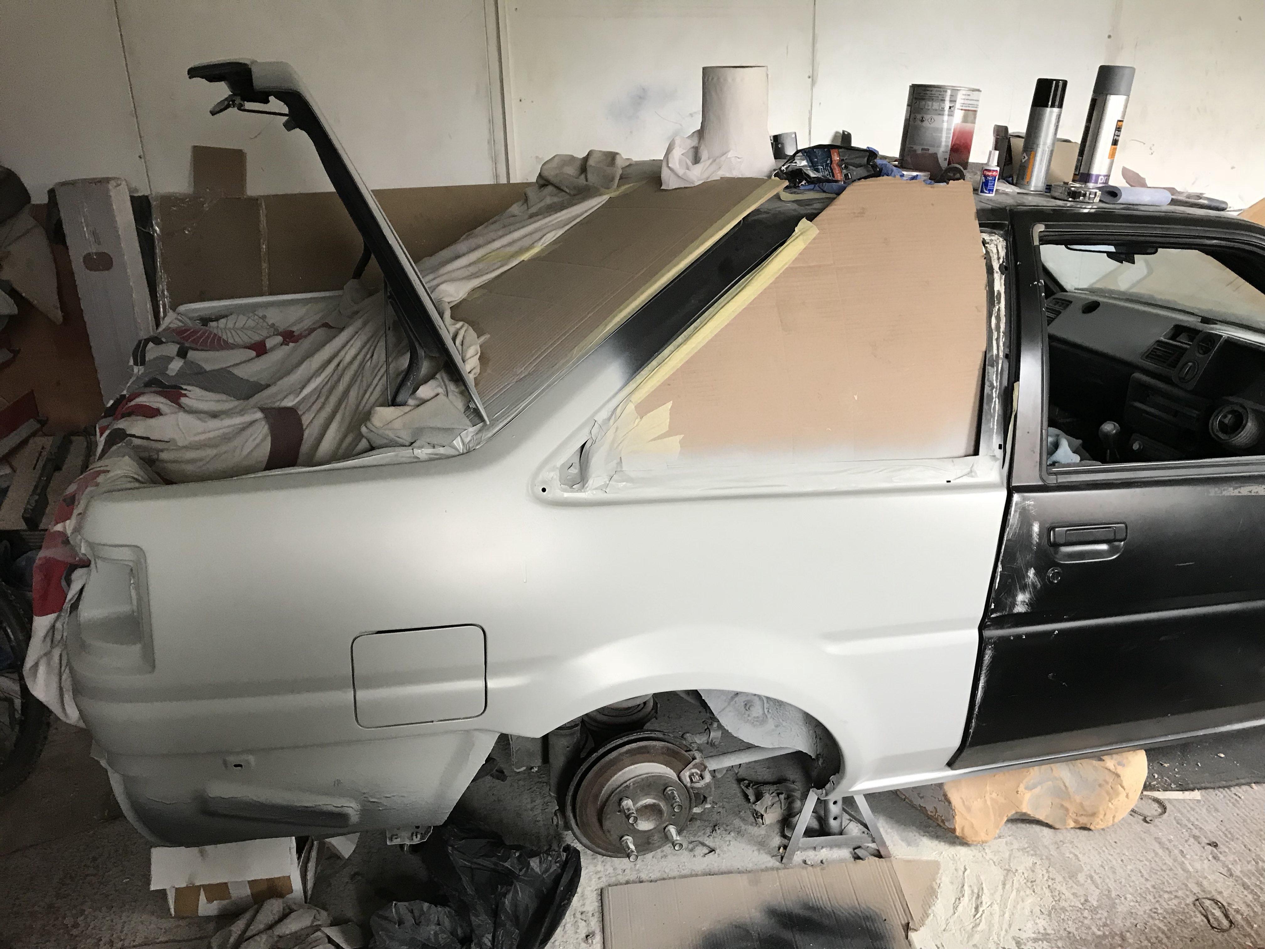

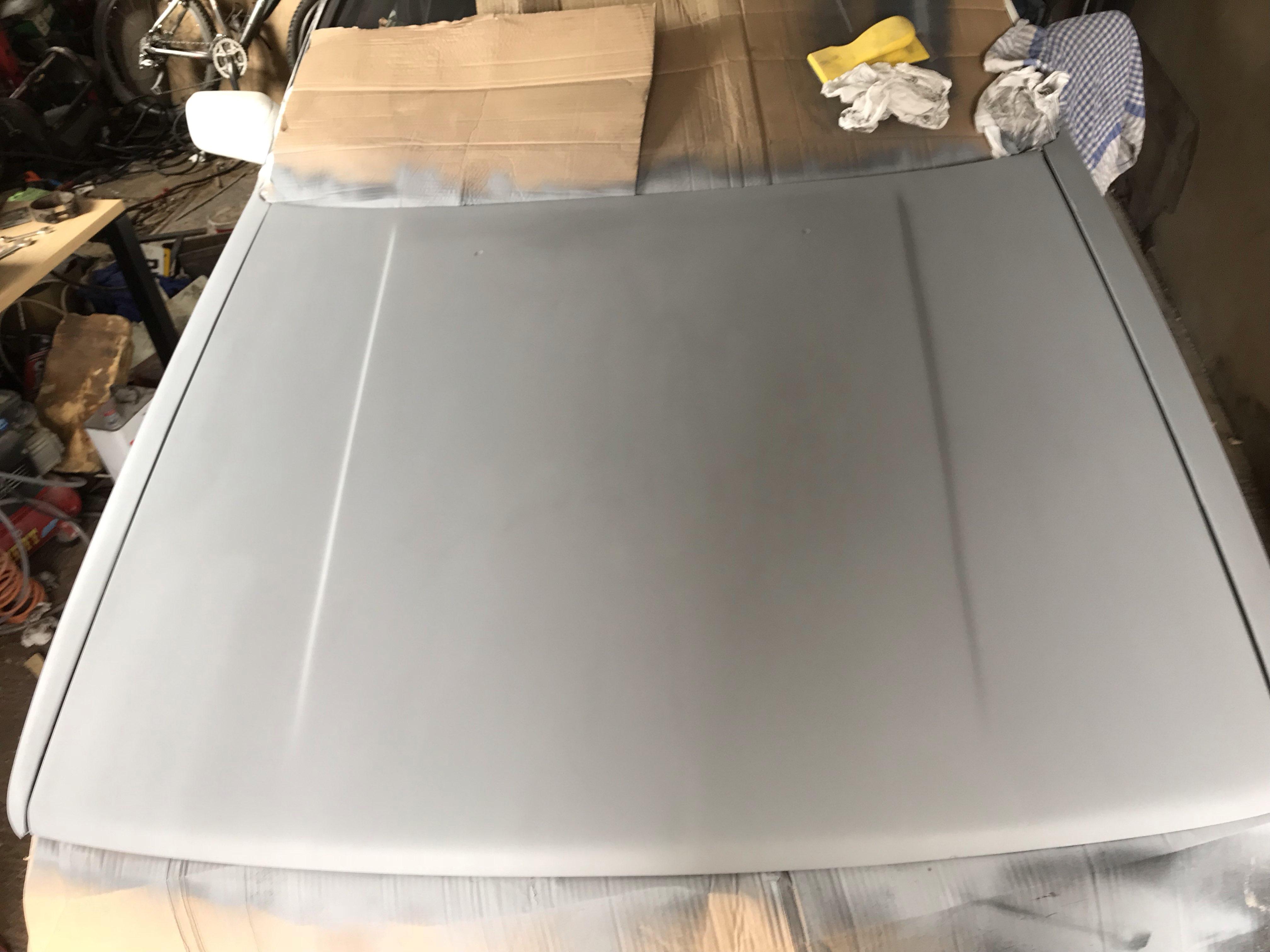

Kieran Barber Posted April 29, 2018 Author Share Posted April 29, 2018 (edited) more filling in the driver's side arch, it was the worst one out of the two. next, we replaced the runfree bonnet (was badly repaired on the corner and I wanted the original look), then I got a fibreglass bonnet for it and we put bondo in the arches as seen below. we then got them in primer and got the back more or less prepped for paint, main thing next would be to prep the rest of the body for paint. Edited October 13, 2018 by Kieran Barber altered the message and added the second half of the update here Quote Link to post Share on other sites
Kieran Barber Posted October 12, 2018 Author Share Posted October 12, 2018 So it's been a while since I've actually posted anything here (I didn't forget I set this up i swear). That and it's been a while since anything has been happening to my ae86, so i'll give a rundown and provide pics at a later date. So since that time, we've tweaked the front wings so the doors can open and close without actually catching. The front end which has been tubed wasn't exactly put on straight or made to look good, so we've pulled it back straight and started aligning the front end better, as well as add extra bracing so the light don't bounce all over the show (was a teeside drift missile basically before i bought it). The plan now is to mount the front and rear bumpers properly, clean the welds up on the bash bar, paint the tubing at some point, then the rest of the prep work can be done (flatted the doors and roof back ready for primer and paint) Quote Link to post Share on other sites

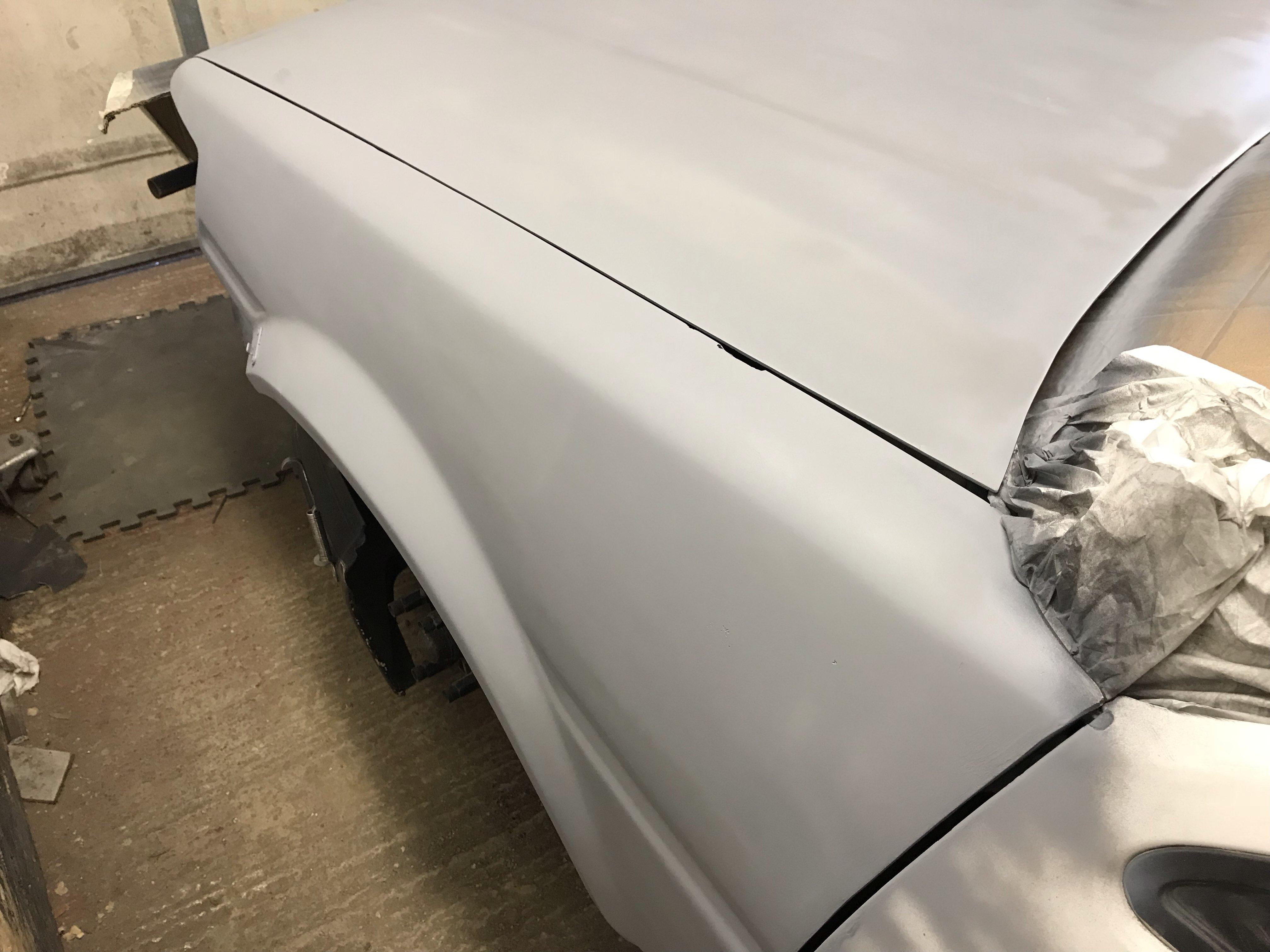

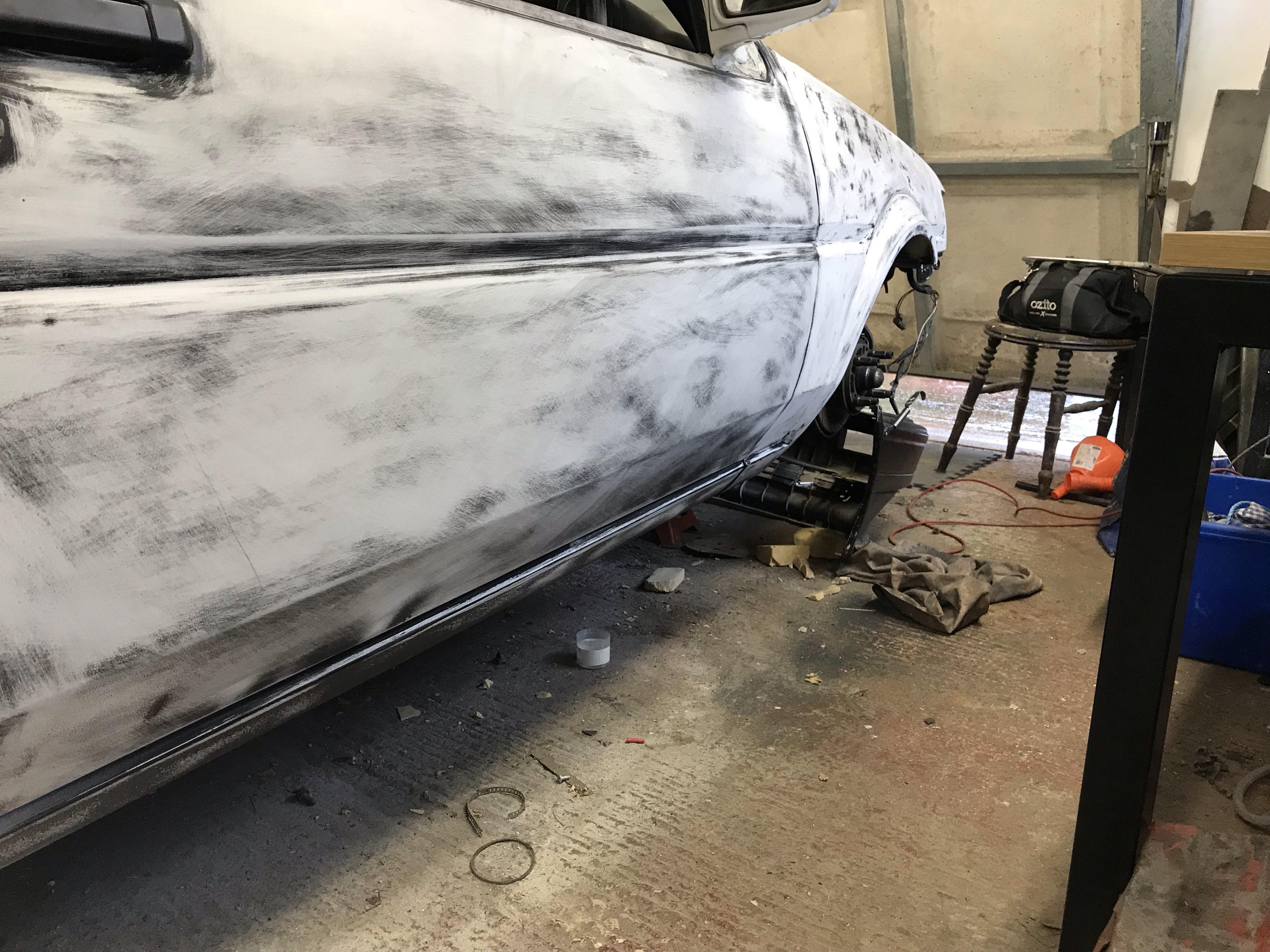

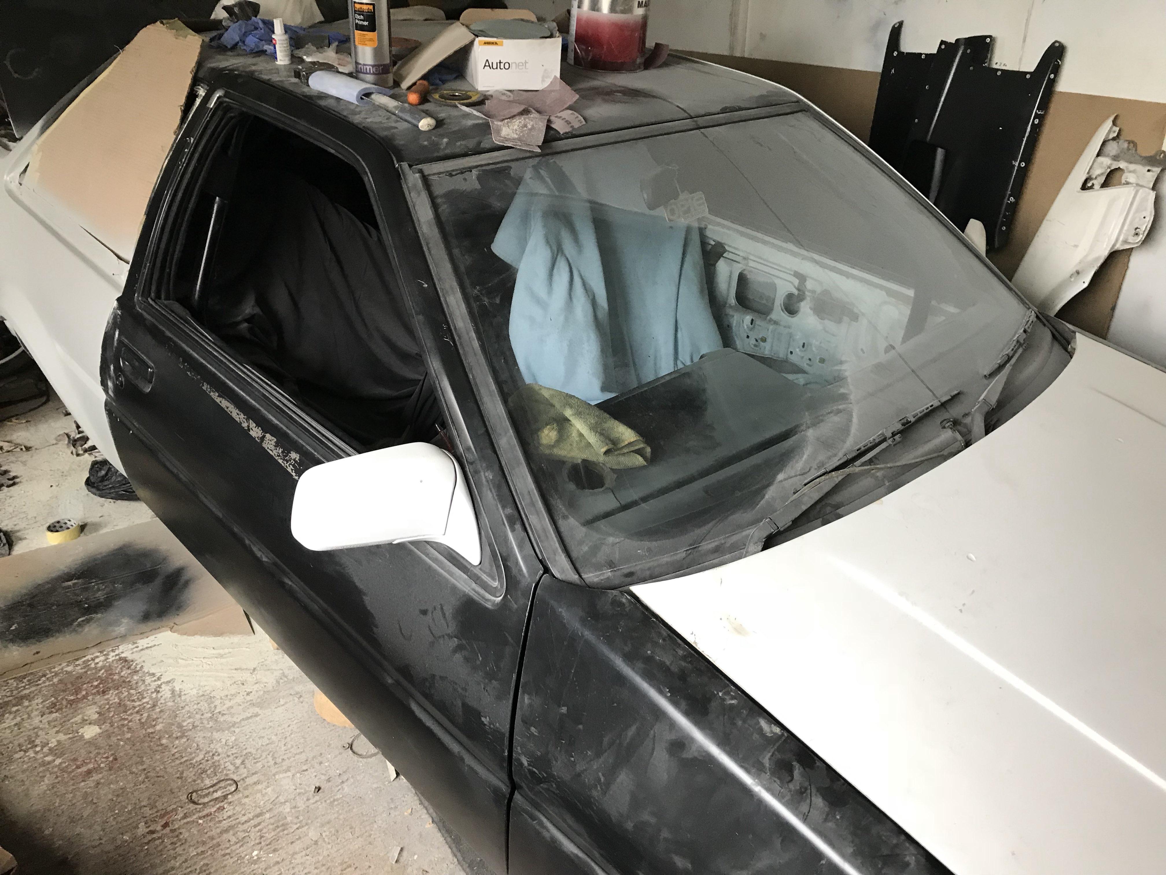

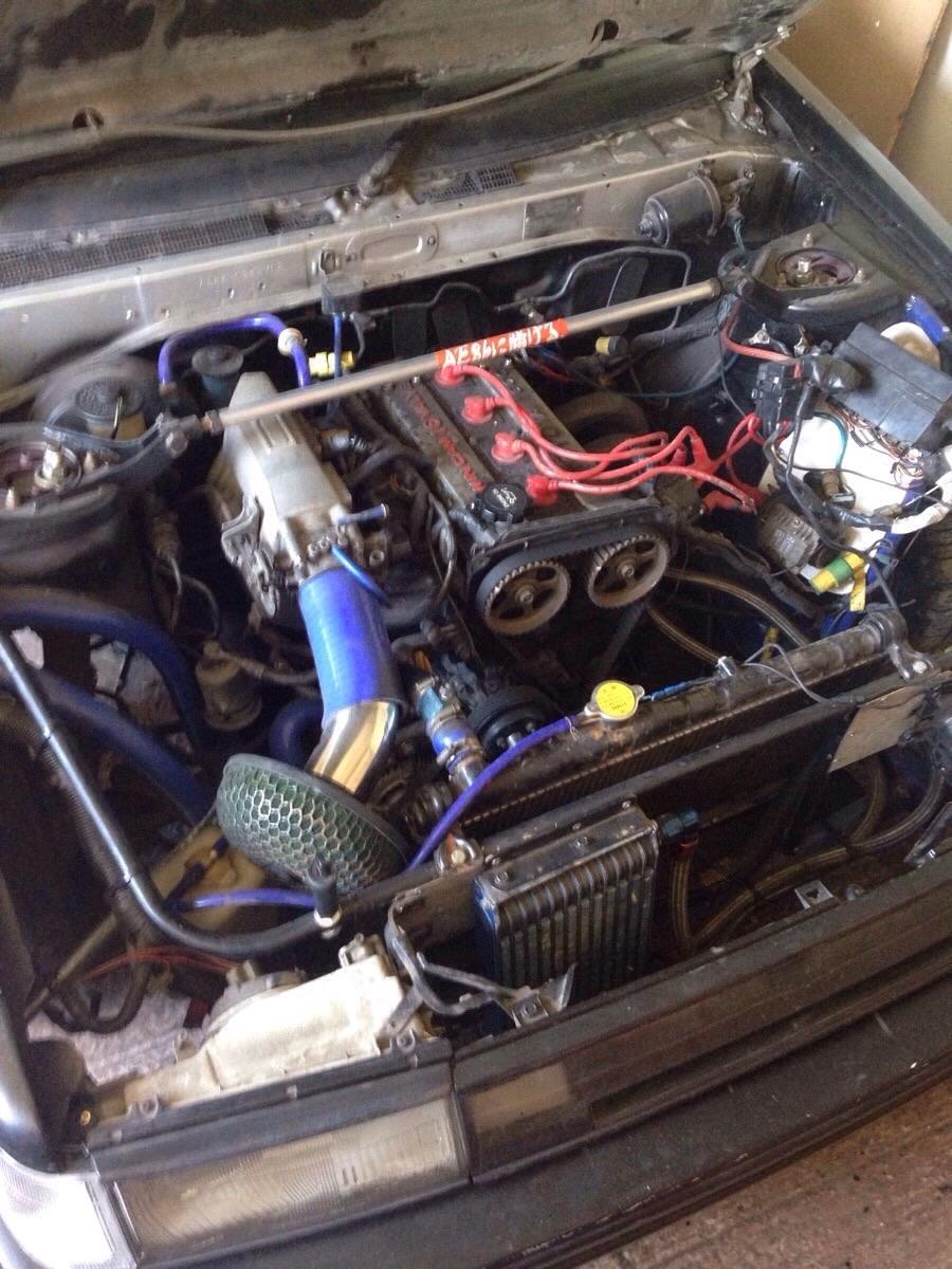

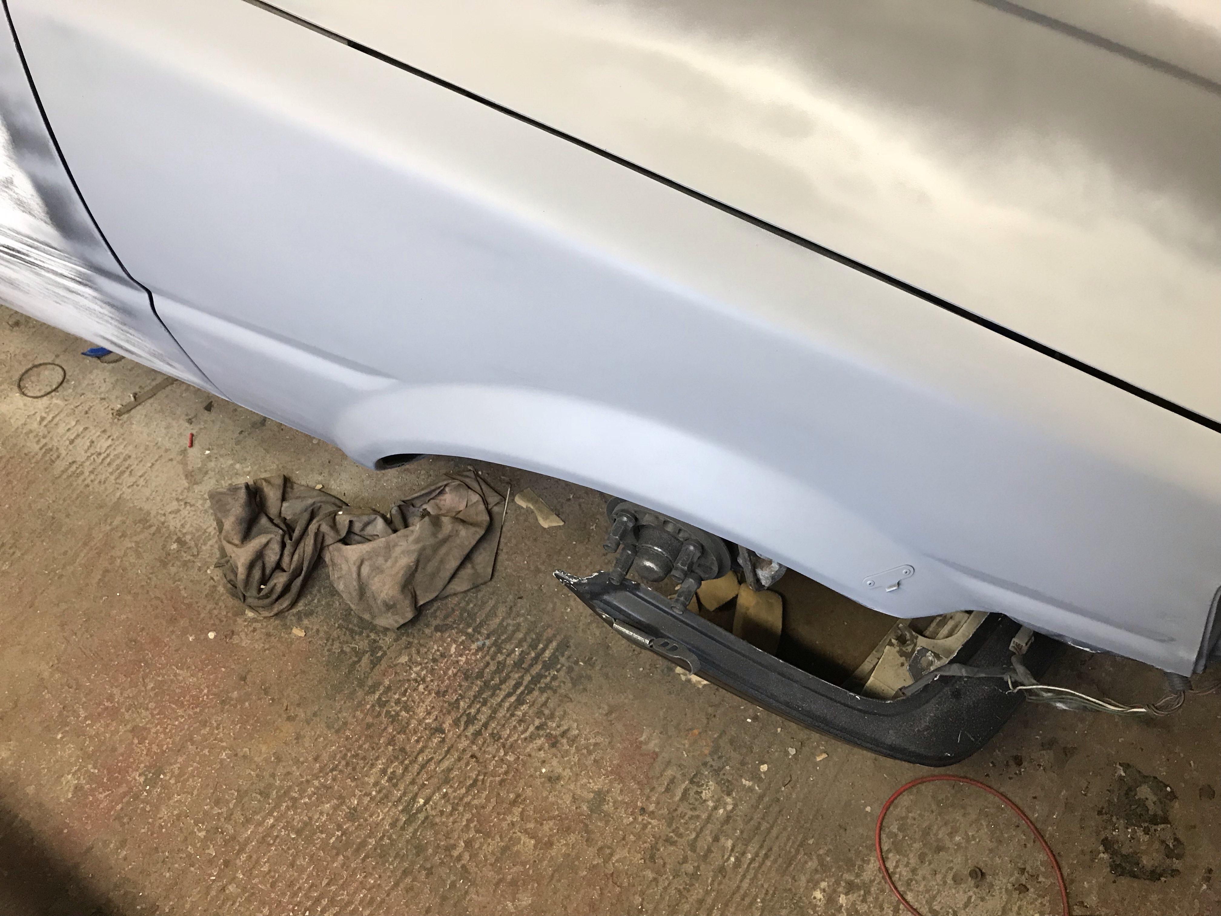

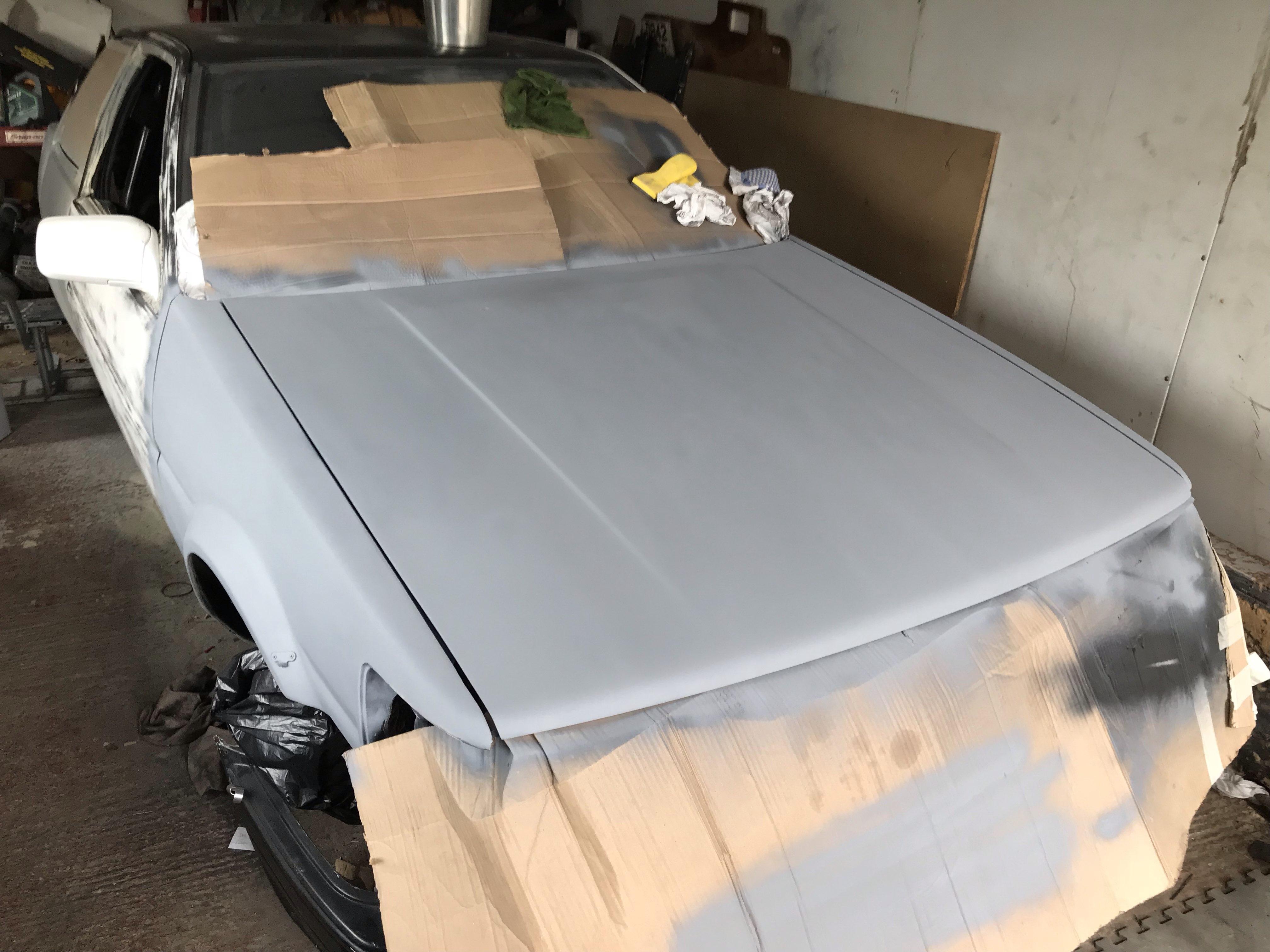

Kieran Barber Posted October 15, 2018 Author Share Posted October 15, 2018 (edited) Next update, we sanded the front end and the doors down as seen in this picture, same outcome on the other side. Then we used etch primer on the bonnet and arches after wiping the panels down, will probably need another coat because we ran out And as you can see, a bit of filler needs putting on that edge. Just remembered about a spec list I got sent with all the goodies on my ae86, so here it goes... Engine & Exhaust: The 4A-GE Is from an AE92 (higher compression) Cusco Exhaust Manifold Trust Oil Cooler Ultra Leads Ultra Direct Ignition System 2 Rad Fans Solid Engine Mounts Drivetrain: TRD Gear Set TRD 2 Way LSD TRD Single Plate Clutch Suspension Components: Greddy Full Tap Type R Coilovers With Adjustable Top Mounts Extra Lock Kit Front And Rear Strut Braces (front may be a cusco, not entirely sure and the rear has an upper and lower brace) TRD Anti Roll Bars TRD 8 Point Bolt In Roll Cage Adjustable Pillow Tension Rods TRD Full Bush kit Konig Rewind Wheels Edited October 15, 2018 by Kieran Barber spec list added Quote Link to post Share on other sites

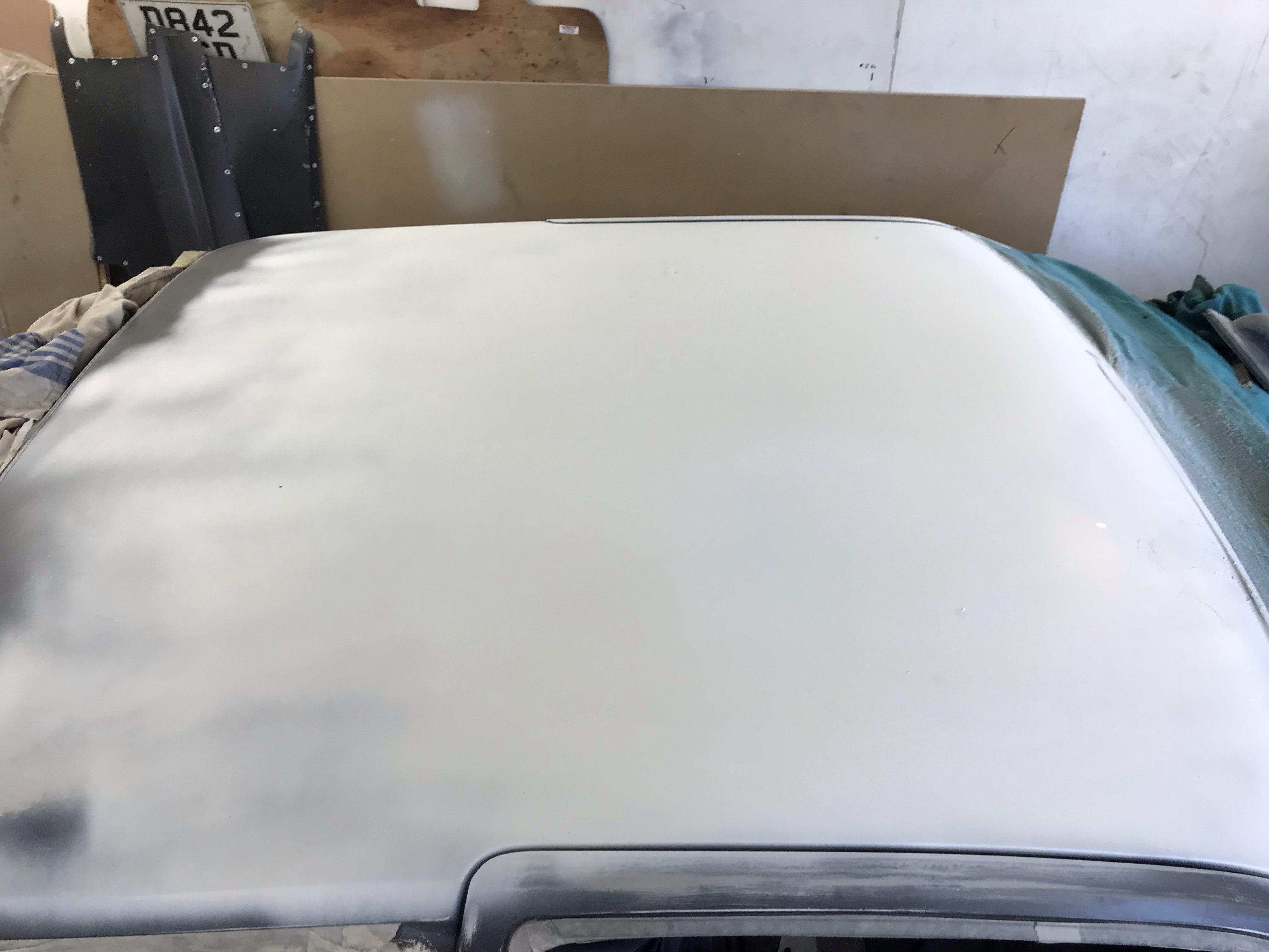

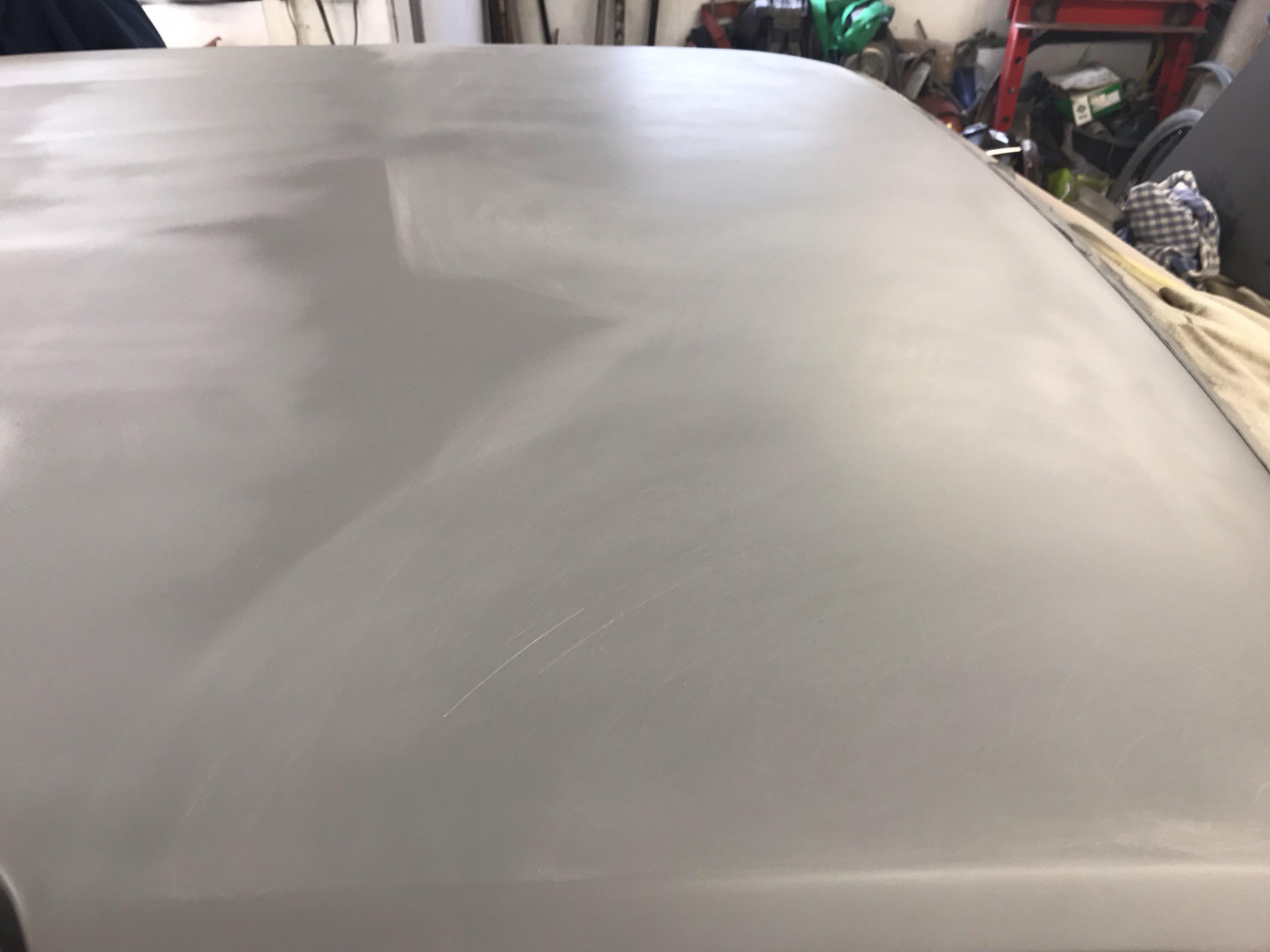

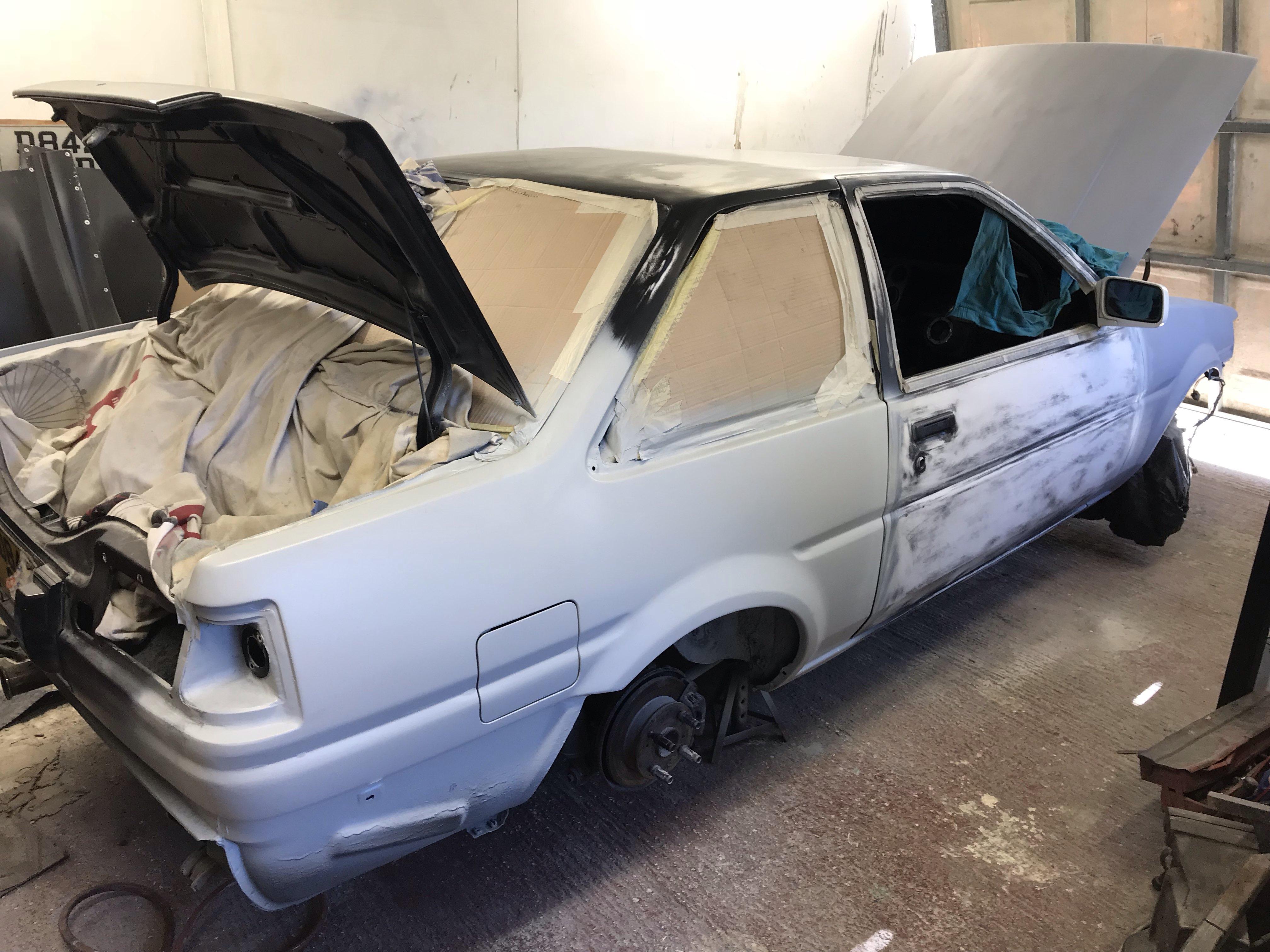

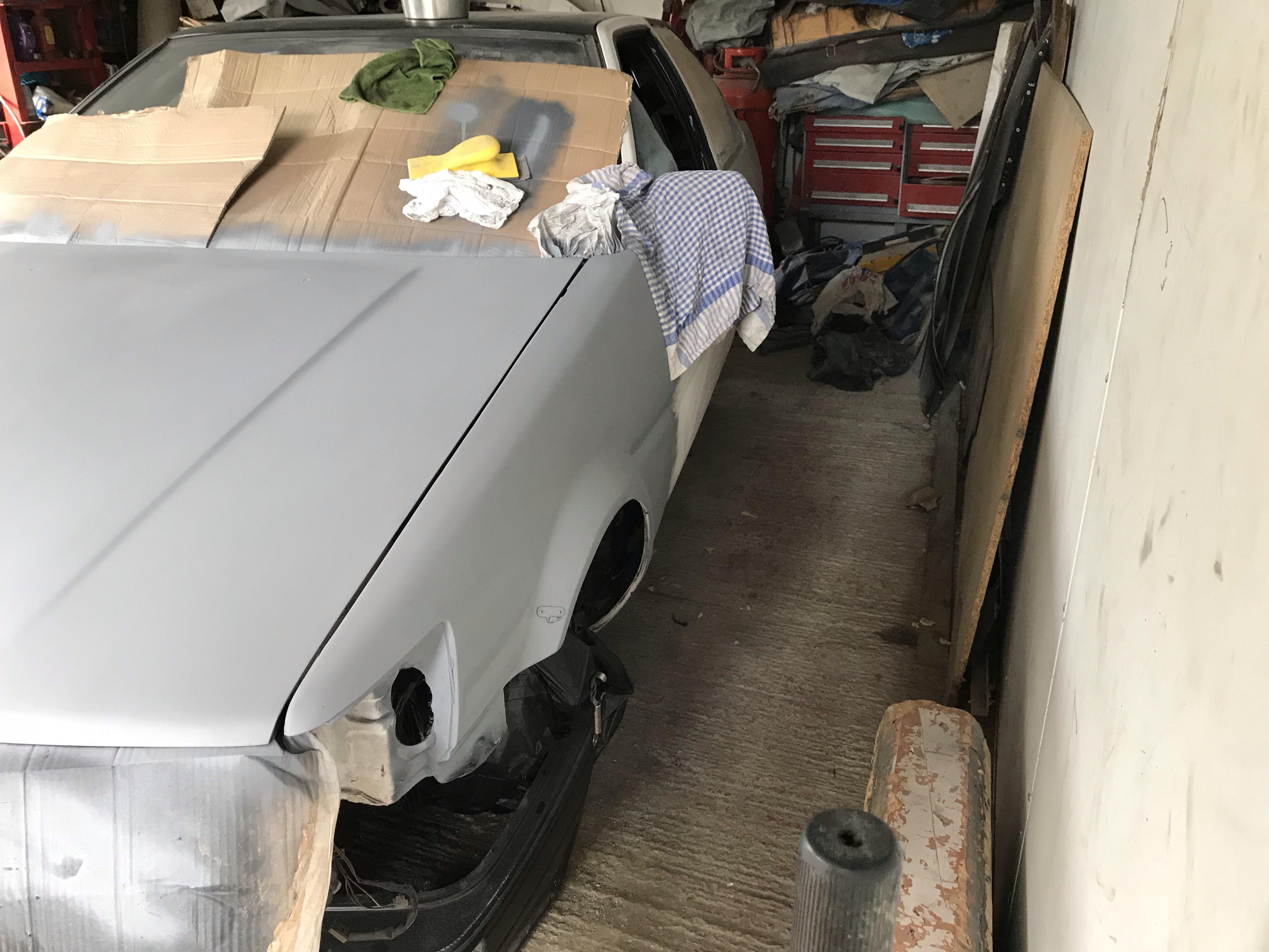

Kieran Barber Posted October 22, 2018 Author Share Posted October 22, 2018 Got another update on getting the AE86 ready for paint. So I managed to get the front end in primer as seen here. Then we started flatting the roof back, applied filler primer, re-sanded it and then applied etch primer as seen here. still needs a tiny bit more work, but the roof is done for the most part, the next thing on the agenda should be prepping the bootlid and then getting the seats and harnesses put in place. Quote Link to post Share on other sites
