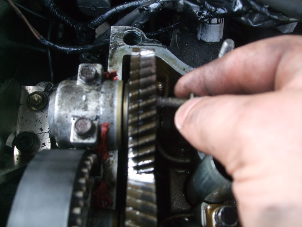

I've just had the cam cover off. Just at going to have a look into service bolt position to check, ima have a search on here before i Continue, thanks alot.

So after a bit of reading,
Sometimes I can't belive I'm this dim, the dots line up, but the holes dont quite line up they're close, but all the teeth line up.......
I am Confused about this, but would that suggest that the rattle could be coming from this area?

The dots are for the timing, again because it's a twin cam you need to ensure the exhaust valves open when the intake is closed.
The dots are irrevelant for this diagnostics and we're just looking at the service bolt hole for the moment.

The hole is one tooth out? You can see the edge of the smaller cogs hole, but would not be able to get a bolt thru it.
Right, well then the cam isn't tensioned properly mate and needs removal.
The bolt should be able to go through and the cam removed to stop it being unsprung.
Can someone just verify this for us. I'm confident I'm right. Pretty sure that will cause it to rattle a little.

On 05/08/2018, 22:56:16, OttersPocket said:
The little in that sentence makes me worry. It started of little, but by the time I got home it was properly loud.
Its definitely a start though, something I can sort myself, hopefully.
Well a lot of rattle bud.
Tension the cam back up and see if that solves the problem.
I’m having this issue after removing my cams and not realising they were sprung,
is it as as simple as twisting it until it lines up and putting a bolt through it?

It's as simple as that.
Just make sure that the cam lobe journals are placed EXACTLY as they were removed.
Easy enough as they are both labelled and numbered.
