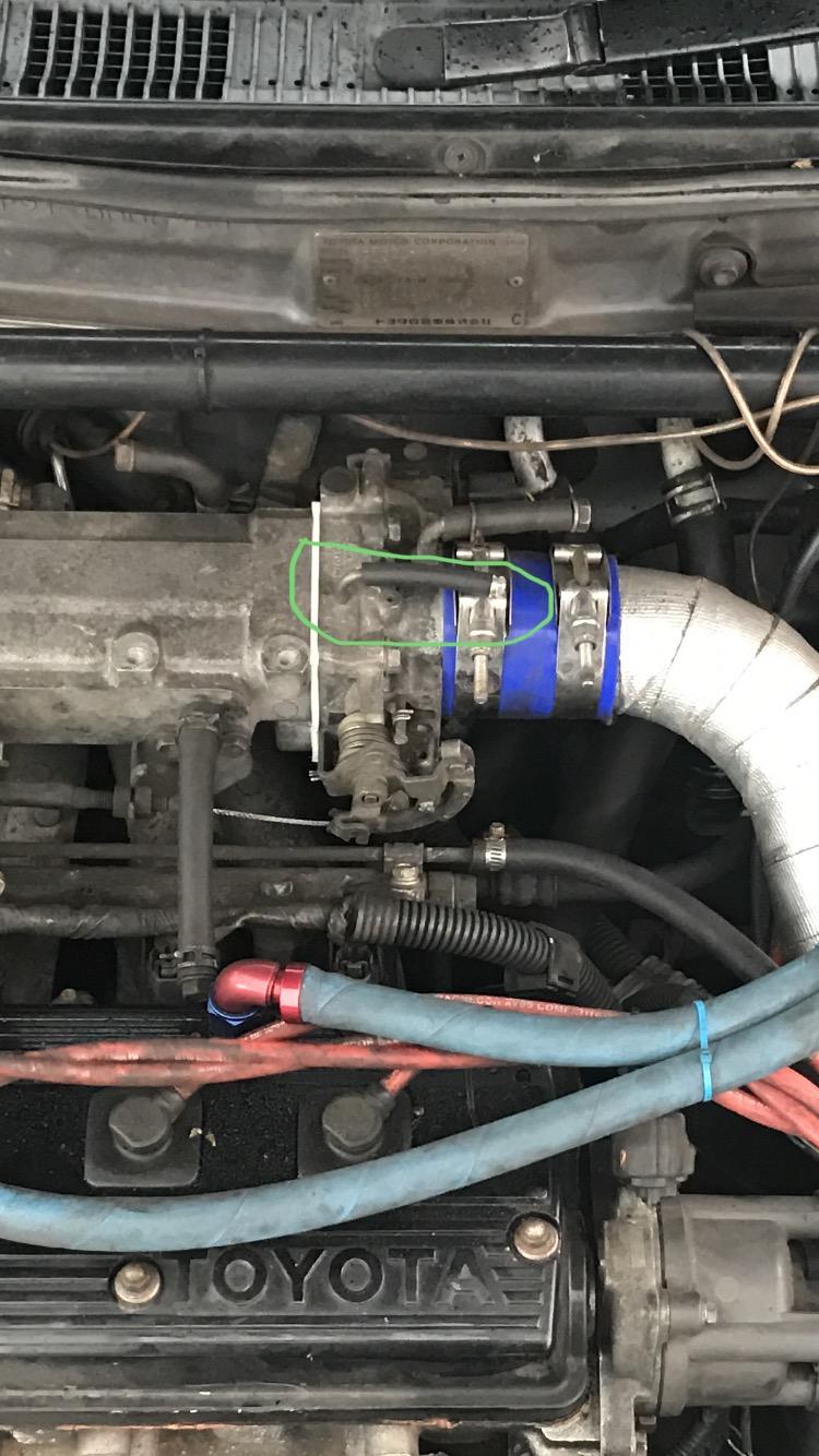

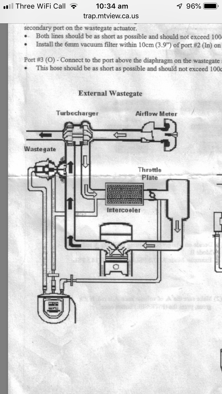

Ive plumbed it in the same way as stated on the installation guide,
the port which draws air in from intake is connected to the throttle body, is that correct? Or is it ment to be tapped into the map sensor hose?

7 hours ago, RobSR said:
Which nipple on the throttle body have you used?
This one

I think thats what will be causing you problems. Move it to one past the throttle plate on the inlet manifold. There is one on the front that the original bov used. Try it there.

Don't split the map sensor hose, use the nipple which is closer to the idle control valve
