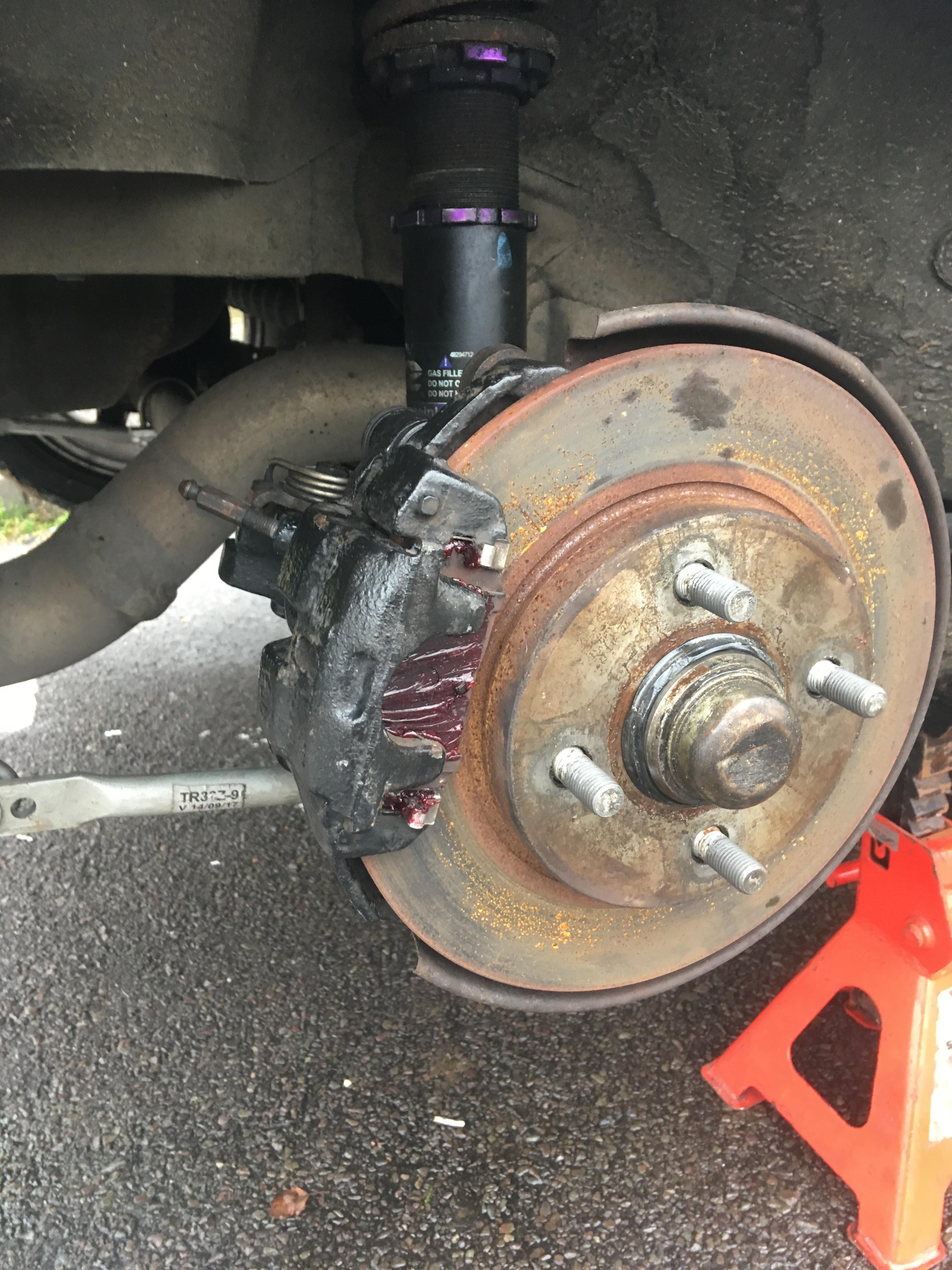

LeonL Posted February 16, 2019 Author Share Posted February 16, 2019 Quote Link to post Share on other sites
LeonL Posted February 16, 2019 Author Share Posted February 16, 2019 Just to confirm that they did fit, even the carriers fitted Quote Link to post Share on other sites
