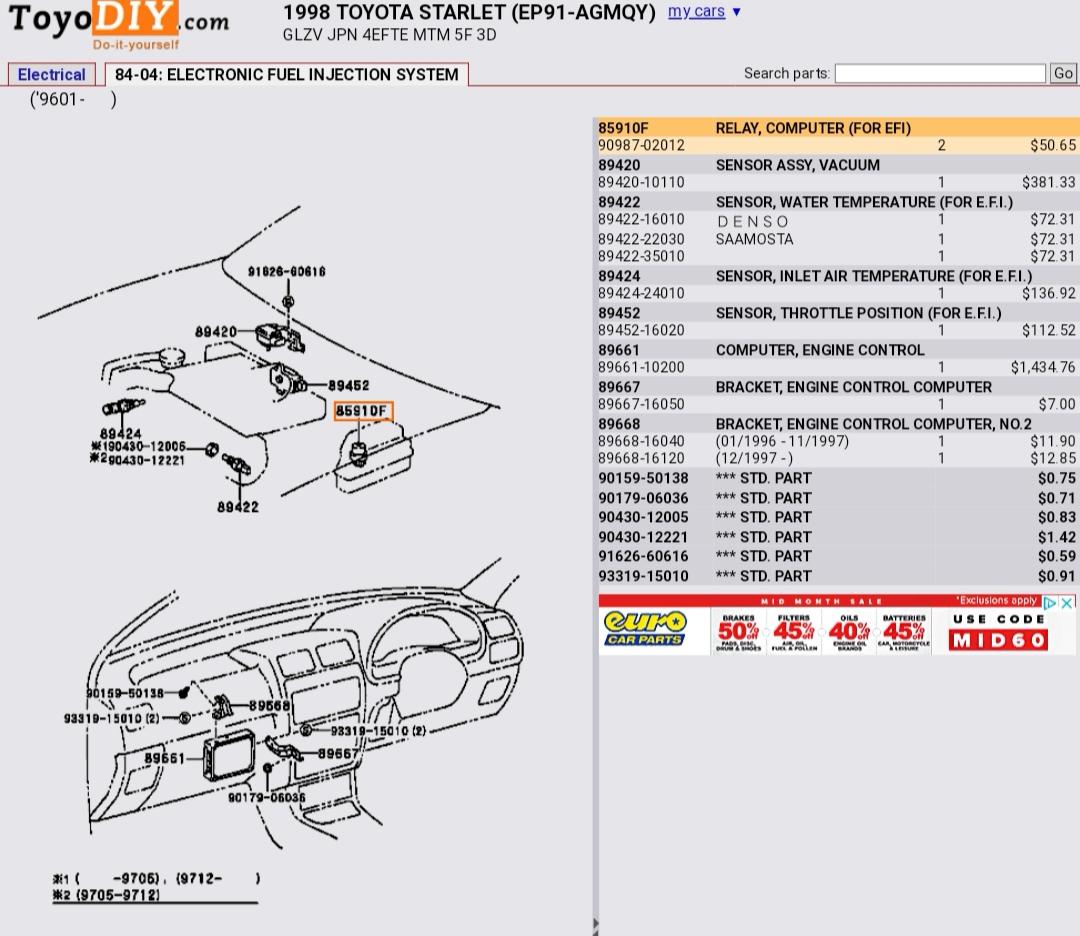

H_D Posted May 18, 2019 Share Posted May 18, 2019 Where is the relay for the fuel pump located? Thanks in advance Quote Link to post Share on other sites
akyakapotter Posted May 18, 2019 Share Posted May 18, 2019 This one maybe mate Cheers nick Quote Link to post Share on other sites
H_D Posted May 18, 2019 Author Share Posted May 18, 2019 51 minutes ago, akyakapotter said: This one maybe mate Cheers nick Nice one pal. Wasnt sure if it was in the fuse box or under the dash like the gt Quote Link to post Share on other sites
RobSR Posted May 18, 2019 Share Posted May 18, 2019 That’s the EFI one, it then feeds what Toyota call ‘circuit opening relay’ which is for the fuel pump and is under the dash Quote Link to post Share on other sites
H_D Posted May 18, 2019 Author Share Posted May 18, 2019 1 hour ago, RobSR said: That’s the EFI one, it then feeds what Toyota call ‘circuit opening relay’ which is for the fuel pump and is under the dash Is it on the passenger side? Quote Link to post Share on other sites
RobSR Posted May 18, 2019 Share Posted May 18, 2019 More middle but biased towards the passenger side Quote Link to post Share on other sites
