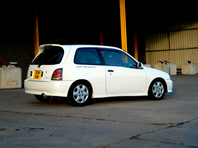

Enough chat anyways, here she is!
The bodywork is completely mint tho!
Not a dent, scratch, mark or crease! I love driving it!
Its truely an awesome car! Watcha all think? :give_rose:

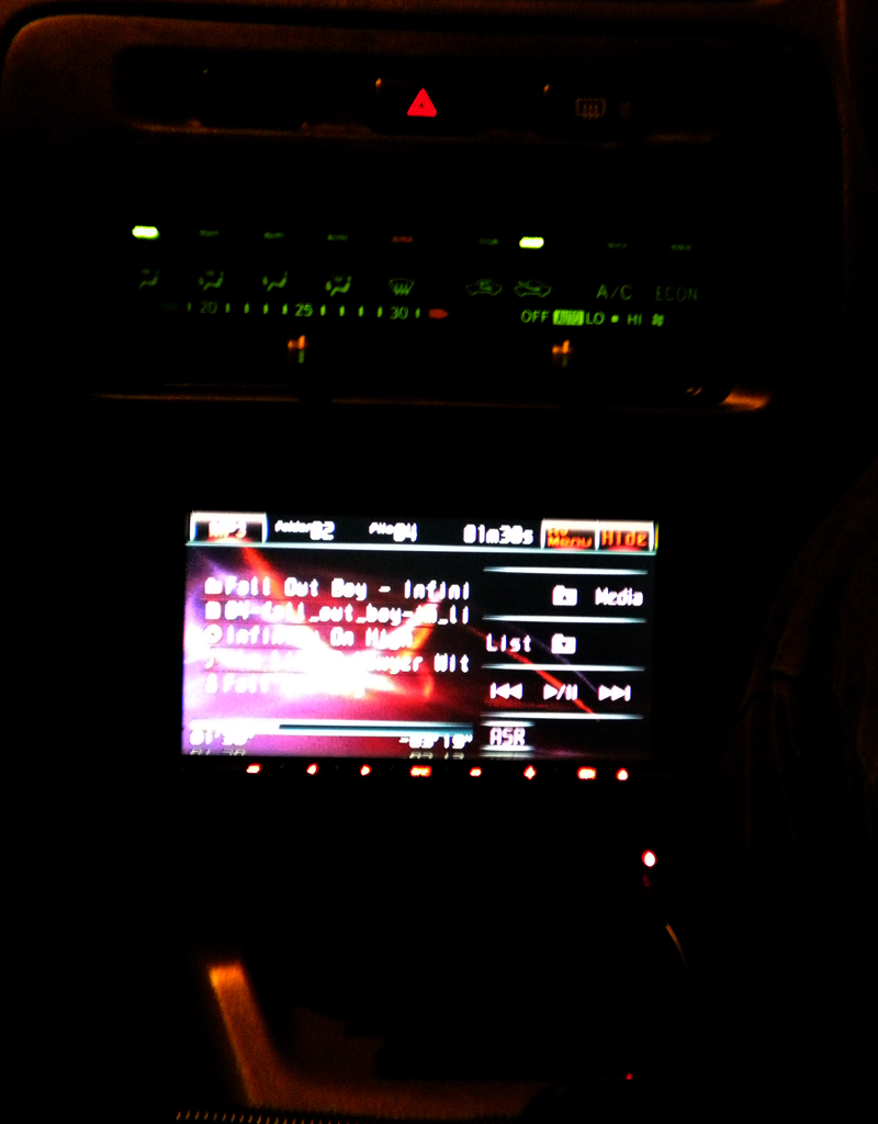

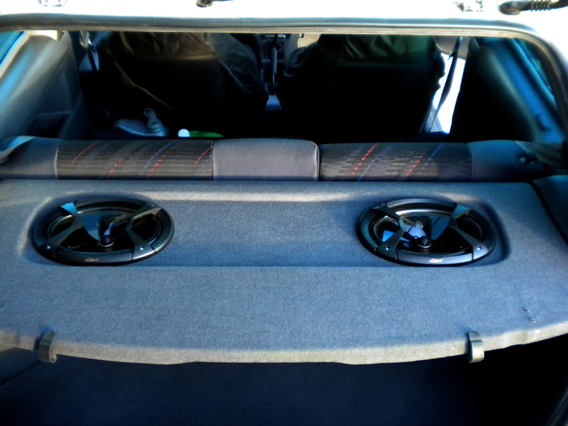

ok so i was sick of driving around in silence (no stereo) so i got myself a double din headunit! Pioneer P4100DVD i think it is! Brand new! ^_^ Filled the hole nicely, needed a bit of filing tho, was a couple of mm too small! B)
It only as front speakers atm too! which are ever so tinny! B)
So some better speakers are most likely on the list of things to do too!

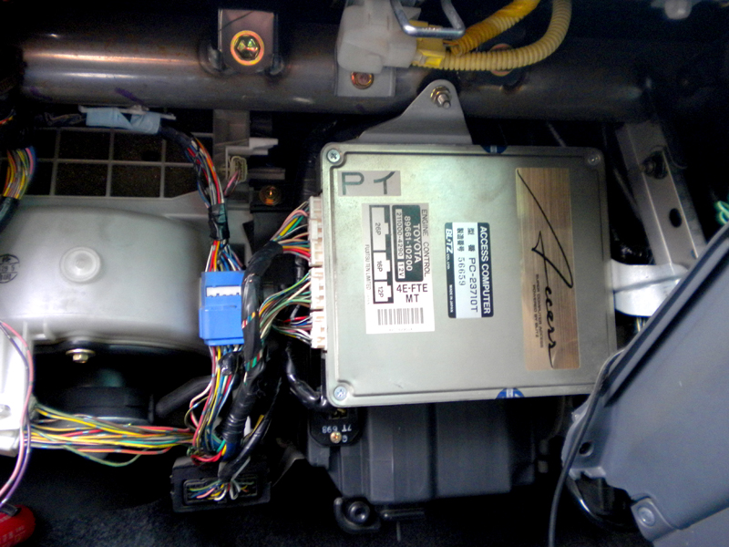

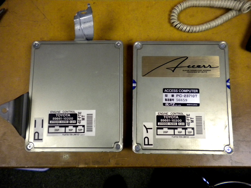

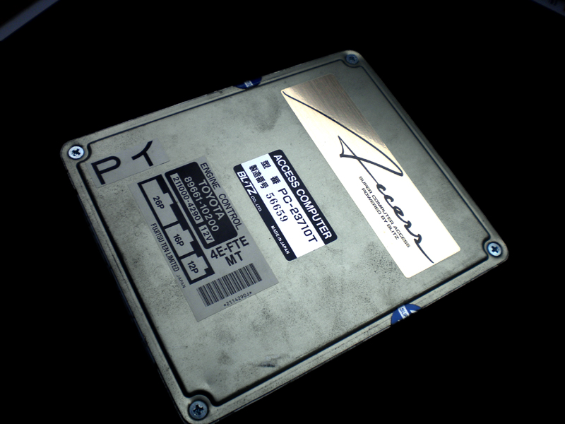

cheers to mickey boy & cheshireglanza for giving me some advice on here on how to get into the awkward space to change this!
Car now managed by Blitz Access ECU :)
Found one in belfast for sale and after postage costs £508! Expensive i know but what a difference its made to the car! So much smoother, it really is amazing what can be done without even raising the boost!
here she is :) :
quick swap of the brackets:
where she sits:
Loving it even more now! Glanza's are the dogs! :D:lol:

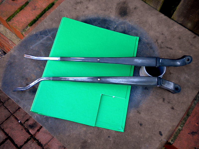

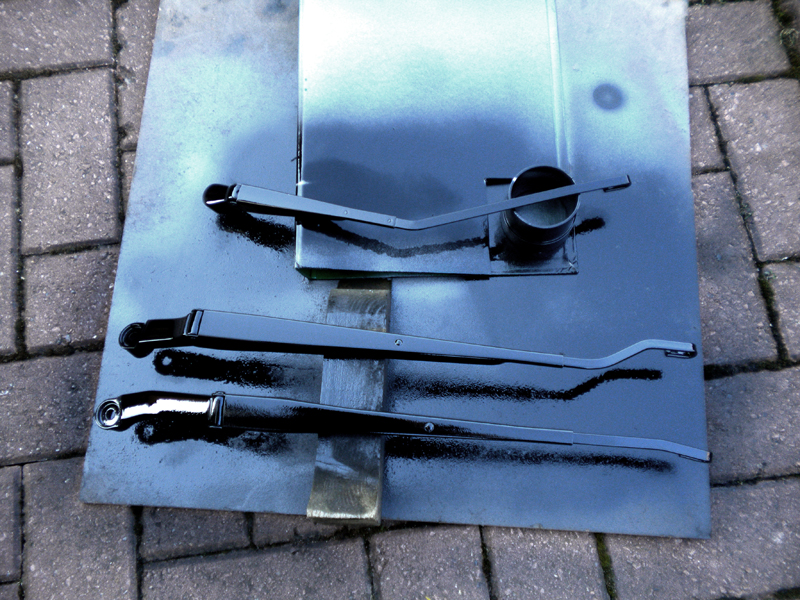

Been bit busy today! Cleaned the car again! Noticed my wiper arms have seen better days and letting the car down! Going white and rusty!
So i removed them all from the car, sanded them all down:
i did the back one too but not pictured!
then i sprayed them satin black (wish id used matte now but hey) and then laquered, still wet in this pic:

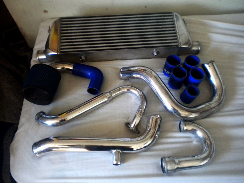

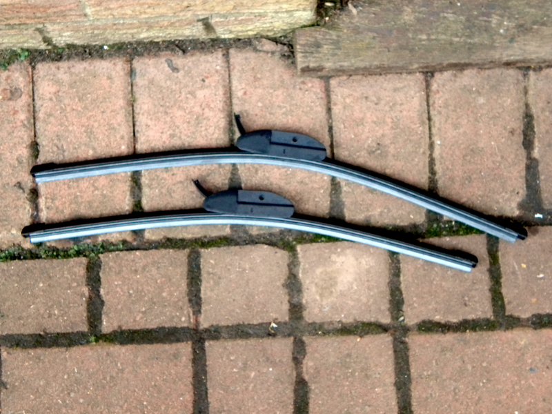

While they were drying i went and collected some goodies from motosave and badassracer69's house :lol:
Flat-Blade wipers for front, also got rear (not pictured)....
and a HDI Front Mount Intercooler, Toy Tuning Front Mount Filter Kit...

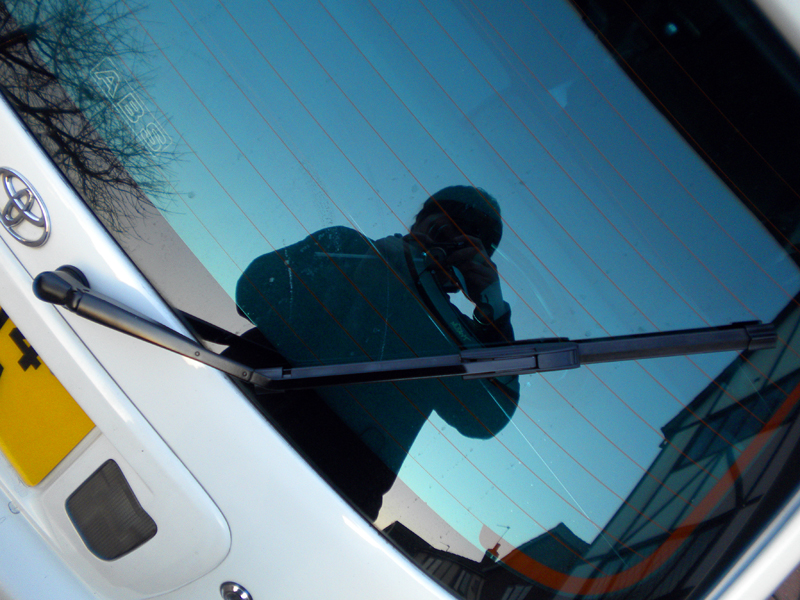

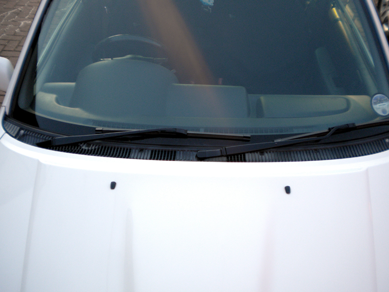

Wiper arms have dried alot more matte then i thought look perfect! :D Flatblades look so much better all round too!
Loving it ;)

Dead easy to do mate and improoves the look of ya car so much! Sand, 2 coats prime, 2 coats paint, 2 coats laquer. leave to dry in airing cuboard... to harden :(
