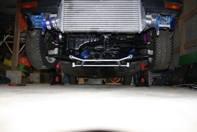

How much space do you have from road to wishbone ?
As you removed the lower brace im curious how the brace looks underneath :D

Its just the underbody brace that I fitted ages ago and have now taken back off - its still stock other than that. Will remake it at some point.
