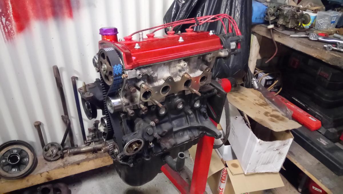

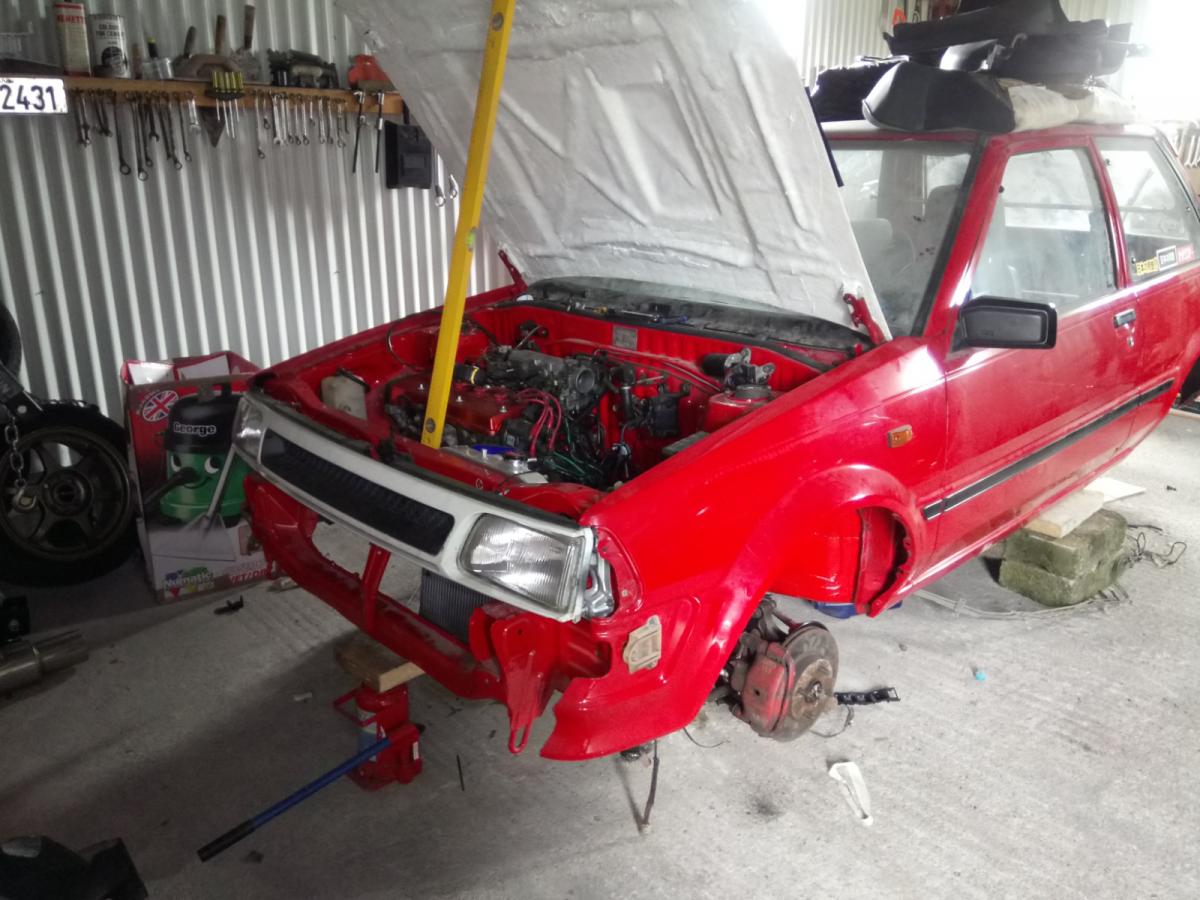

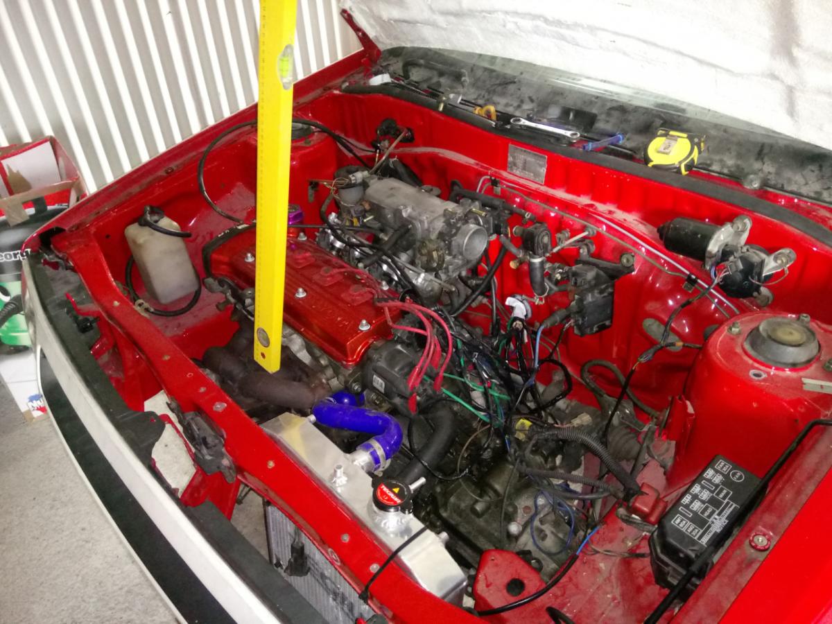

Have made a start with this conversion. Need to do the headgasket on the engine. Picked up a headgasket and a set of head bolts. I'll get the head rebuilt while it's off the engine
The wiring loom is done also

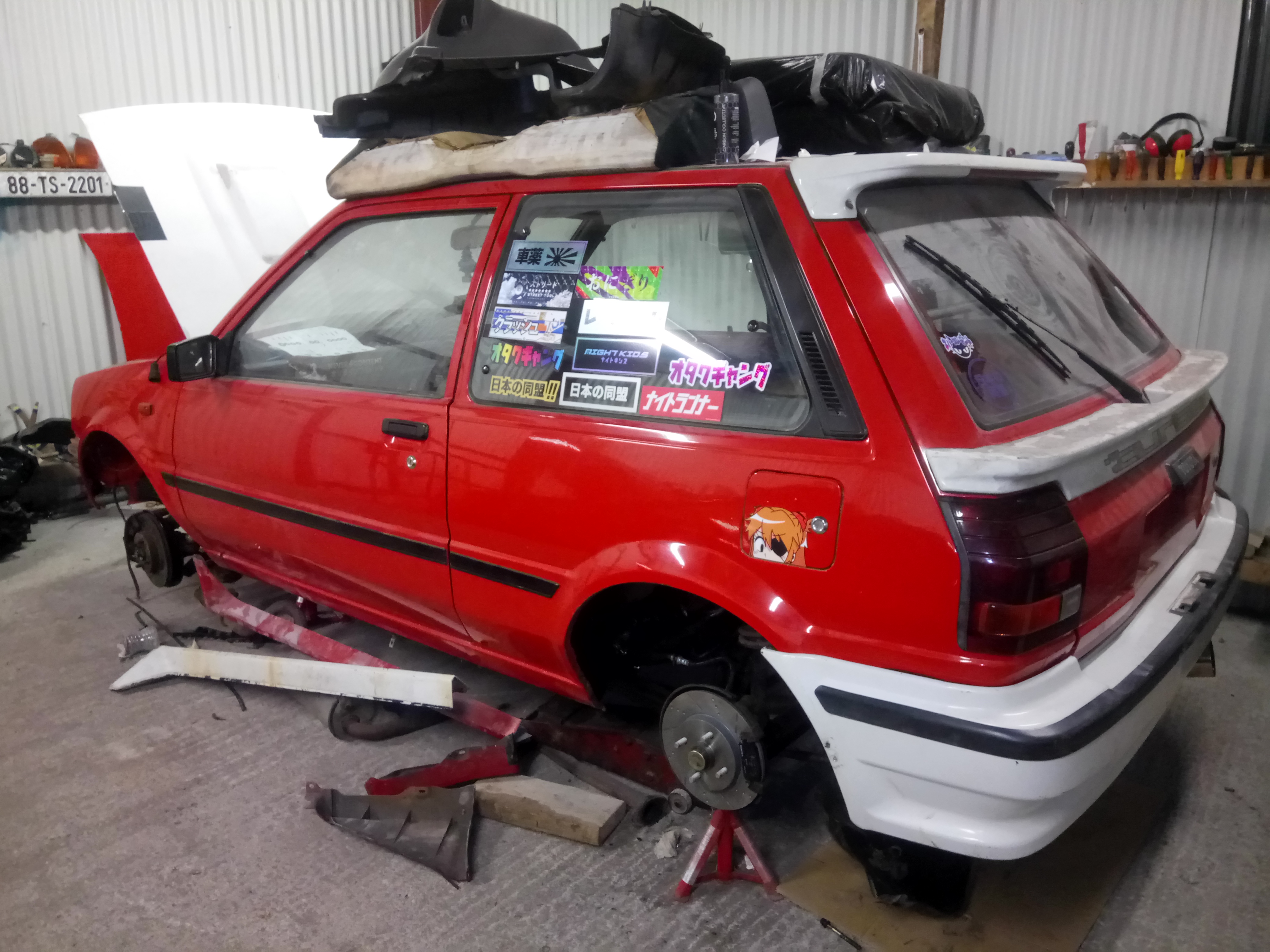

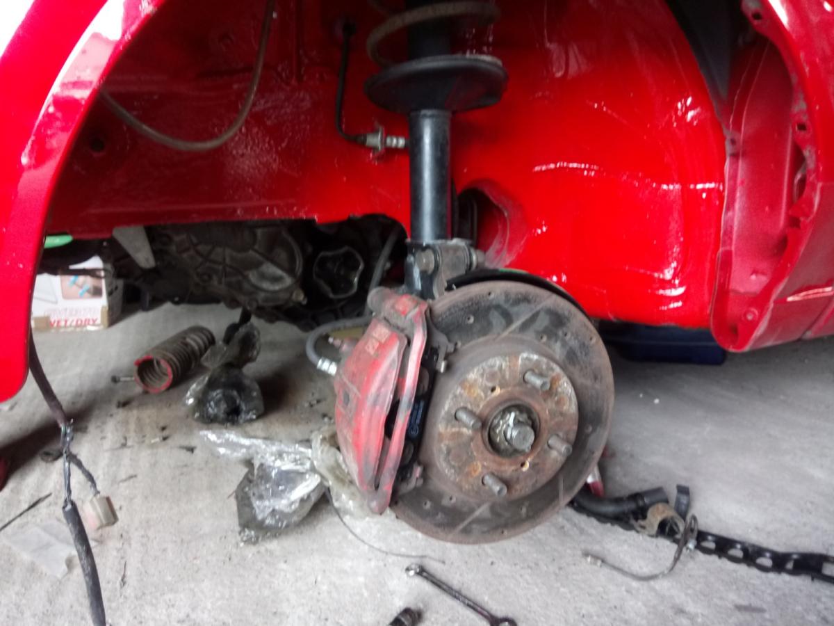

Also done the EP91 wishbones with powerflex bushes and new ball joints
Looks great, what turbo are you running, doesn't look like the usual td from the back end
CT9 with this engine. The welding on the manifold is an absolute mess so that has to be changed. Have an other engine so I'll be rebuilding that at some stage and go bigger turbo with that

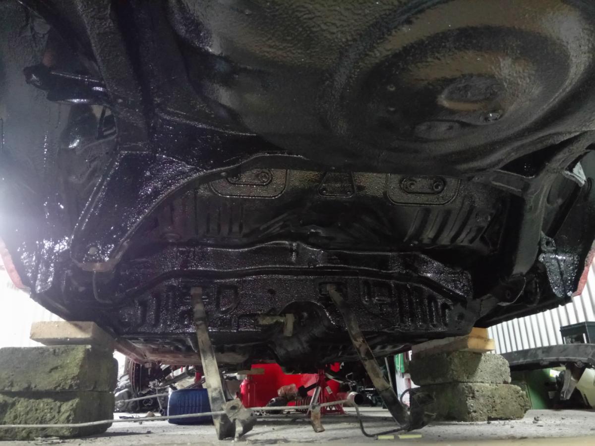

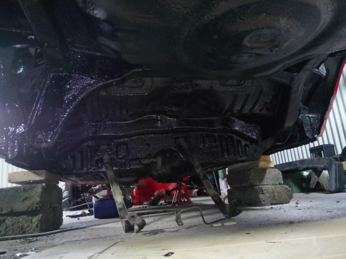

Finished off with the underside protection. Undersealed the whole under neath and went over it in chassis paint. Didn't like the kinda sticky feel of the underseal.

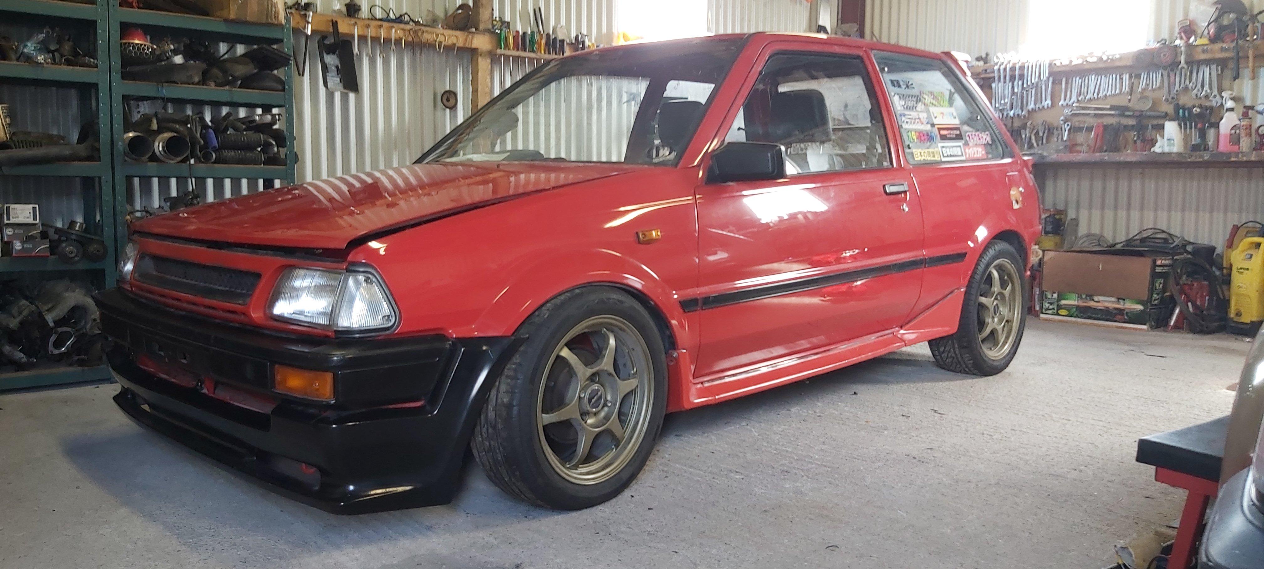

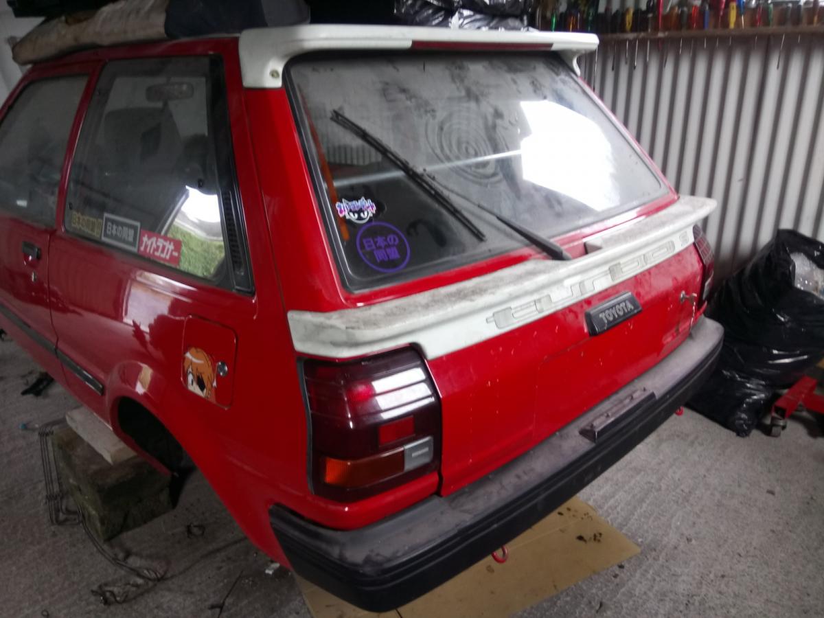

Test fitted the spoiler,midspoiler and front grill.
Haven't done much engine wise still have to sort out the fueling side of things first

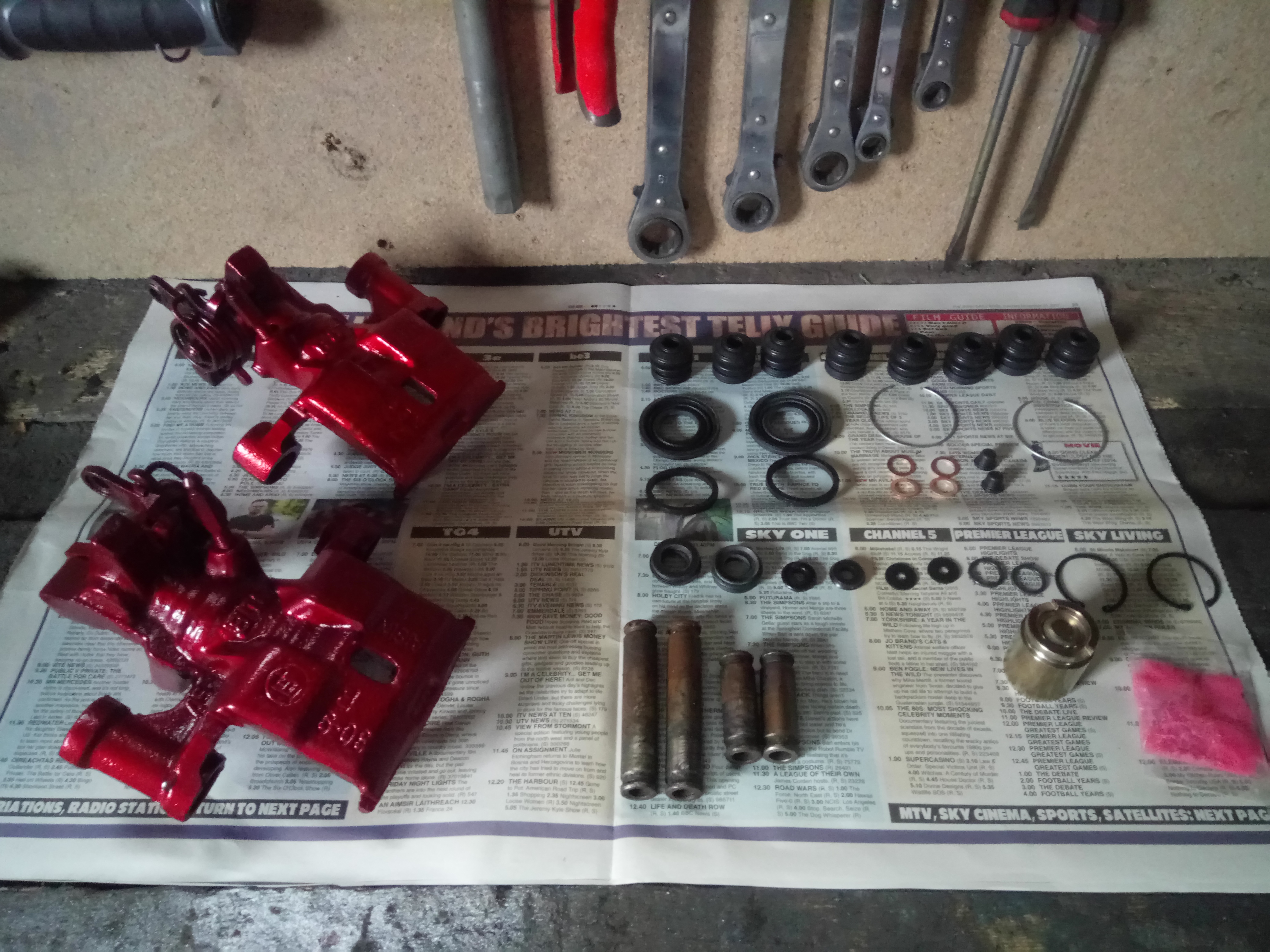

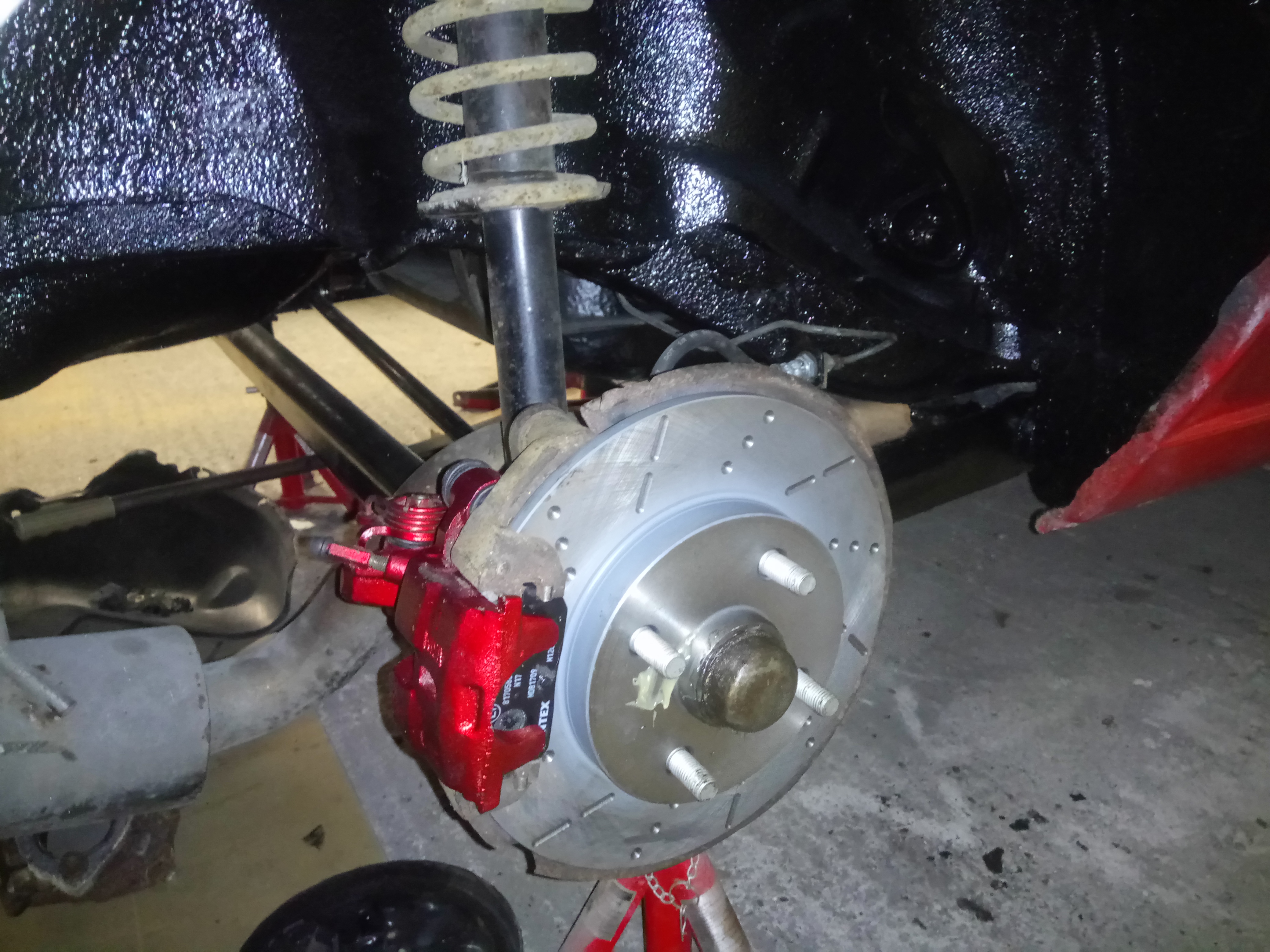

My rear calipers were pretty bad so decided to rebuild them. Handy enough to do but a bit fiddly. Also changed the two pistons while I was at it.
Picked up a rear bumper for it as it seems to be the only real mod with regards a rear bumper. Also have MR2 skirts there for it
