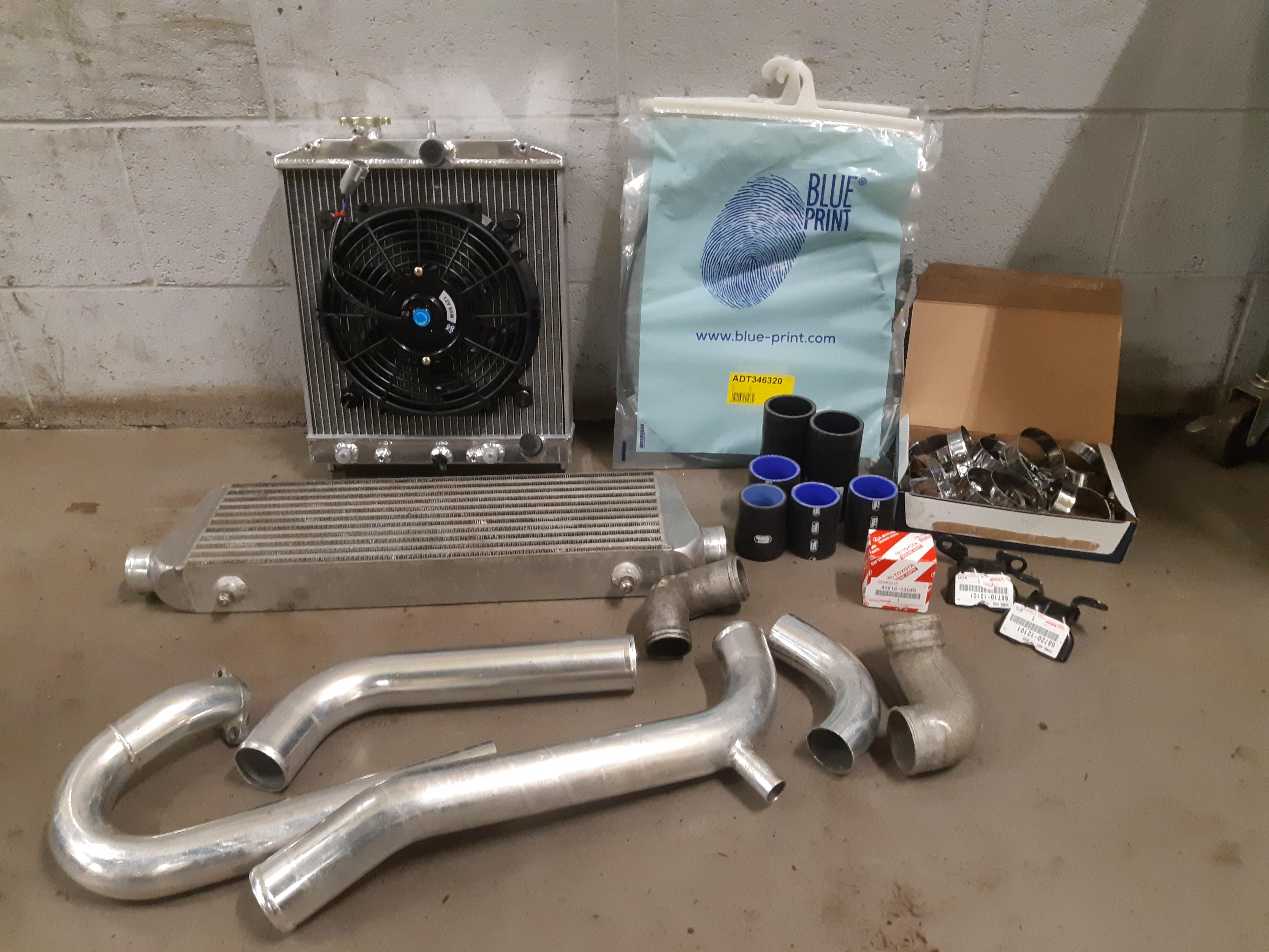

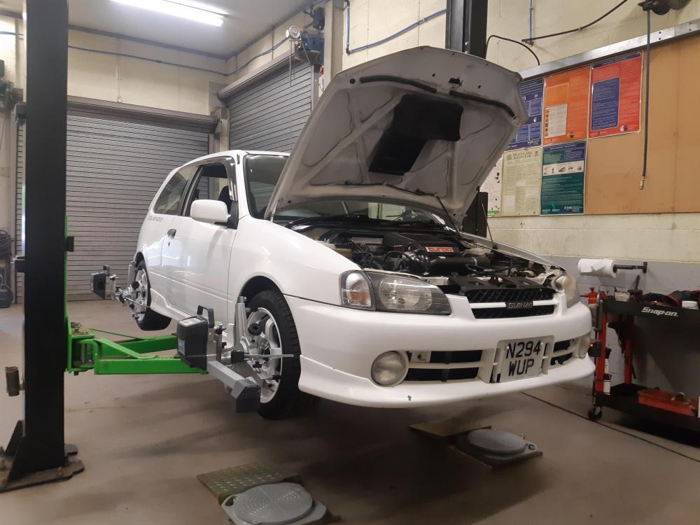

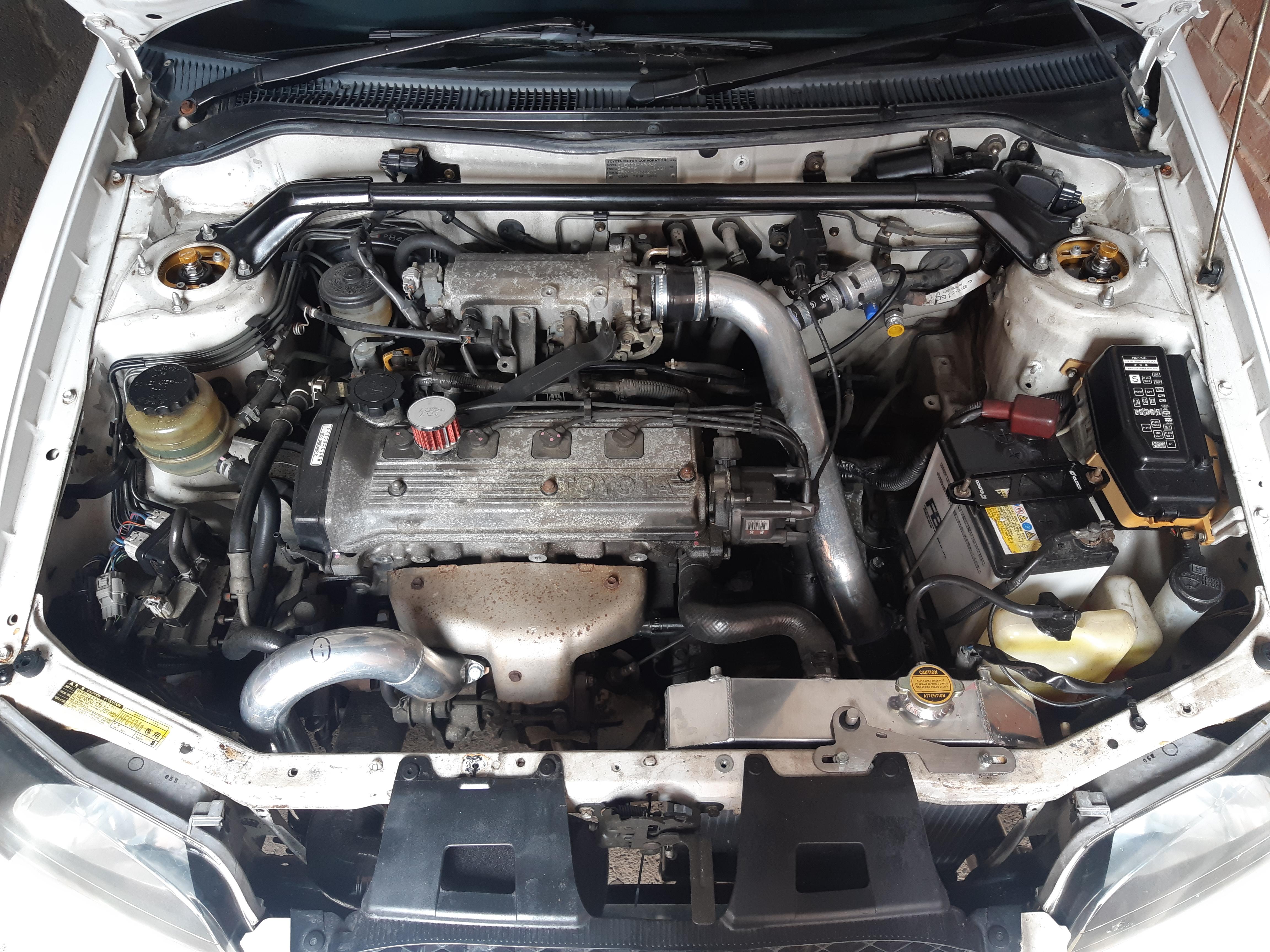

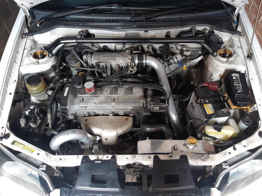

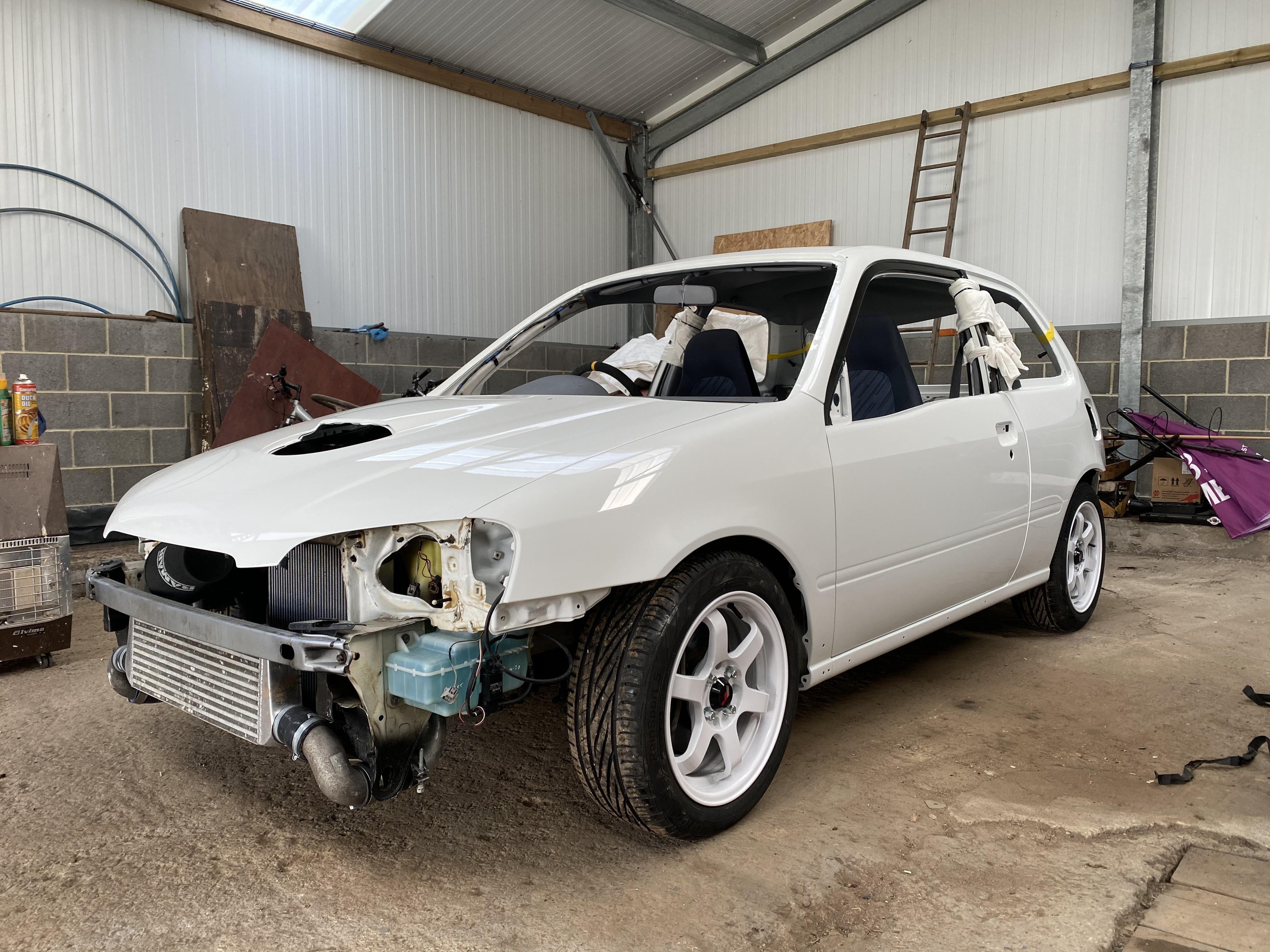

So finally getting round to squeezing my own car in tomorrow for some new bits.
Td monster radiator.
Genuine thermostat.
Genuine drivers door hinges due to the current ones having play.
Front mount intercooler with new samco joiners.
Both handbrake cables as ones seized.

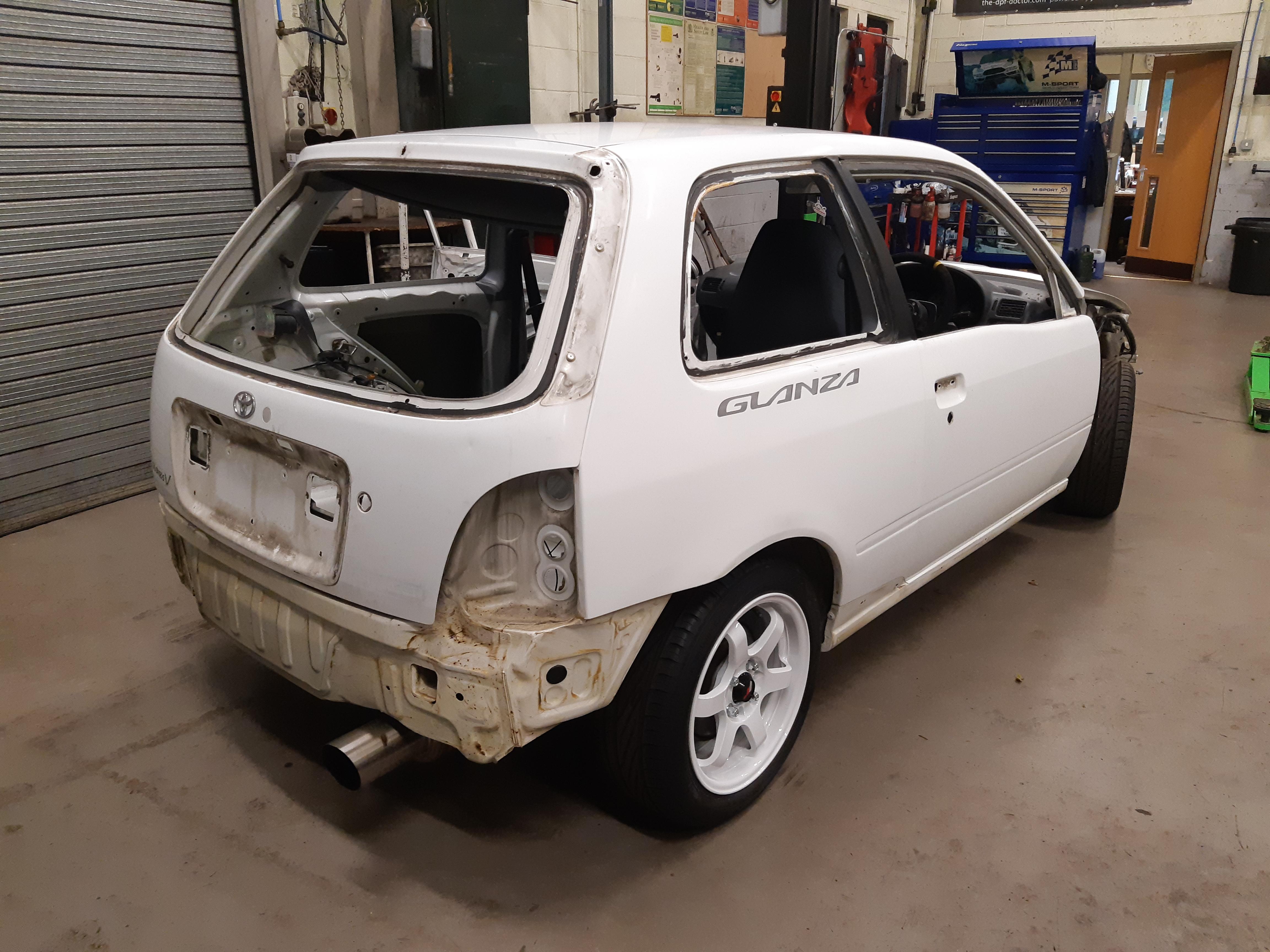

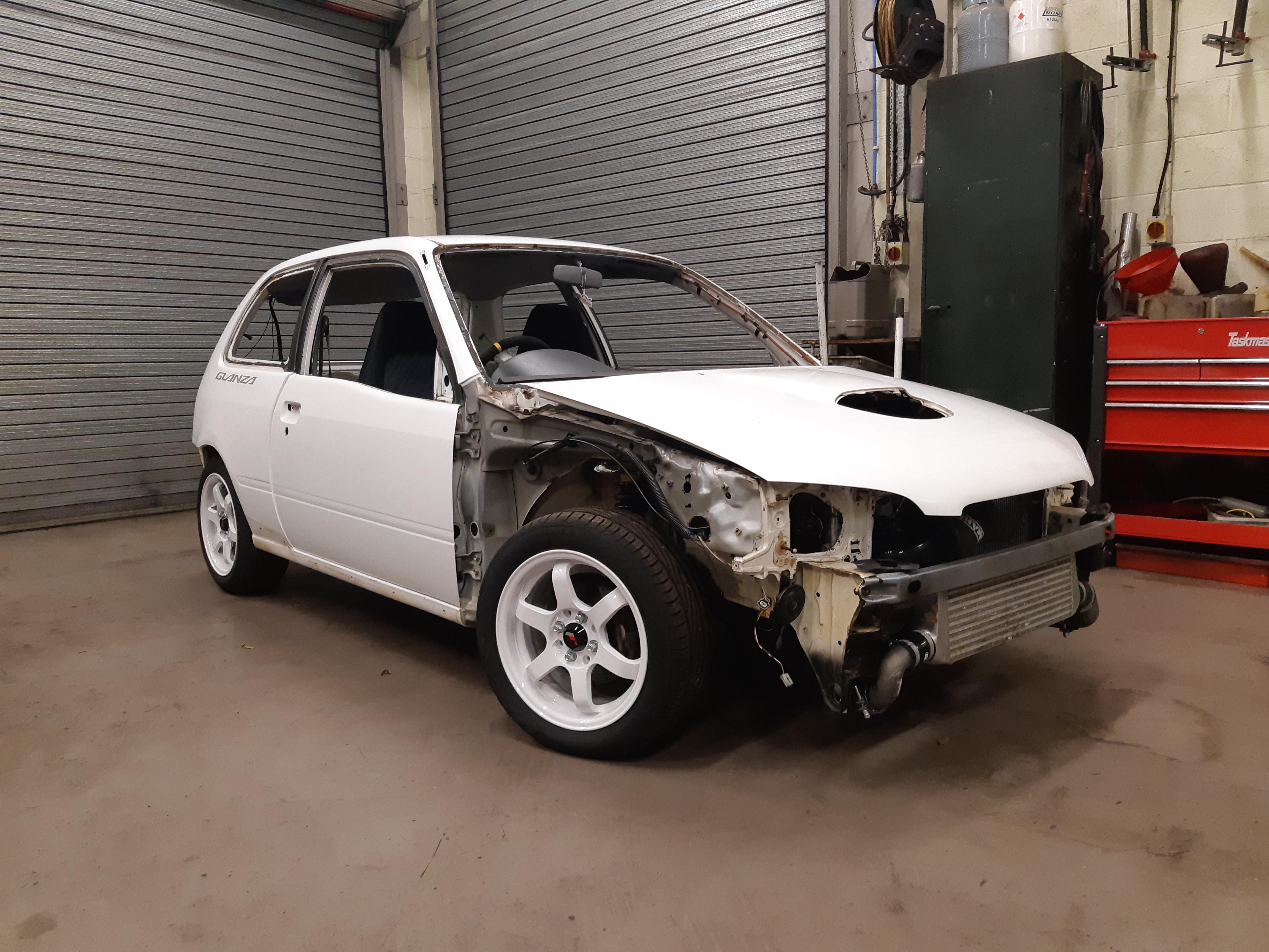

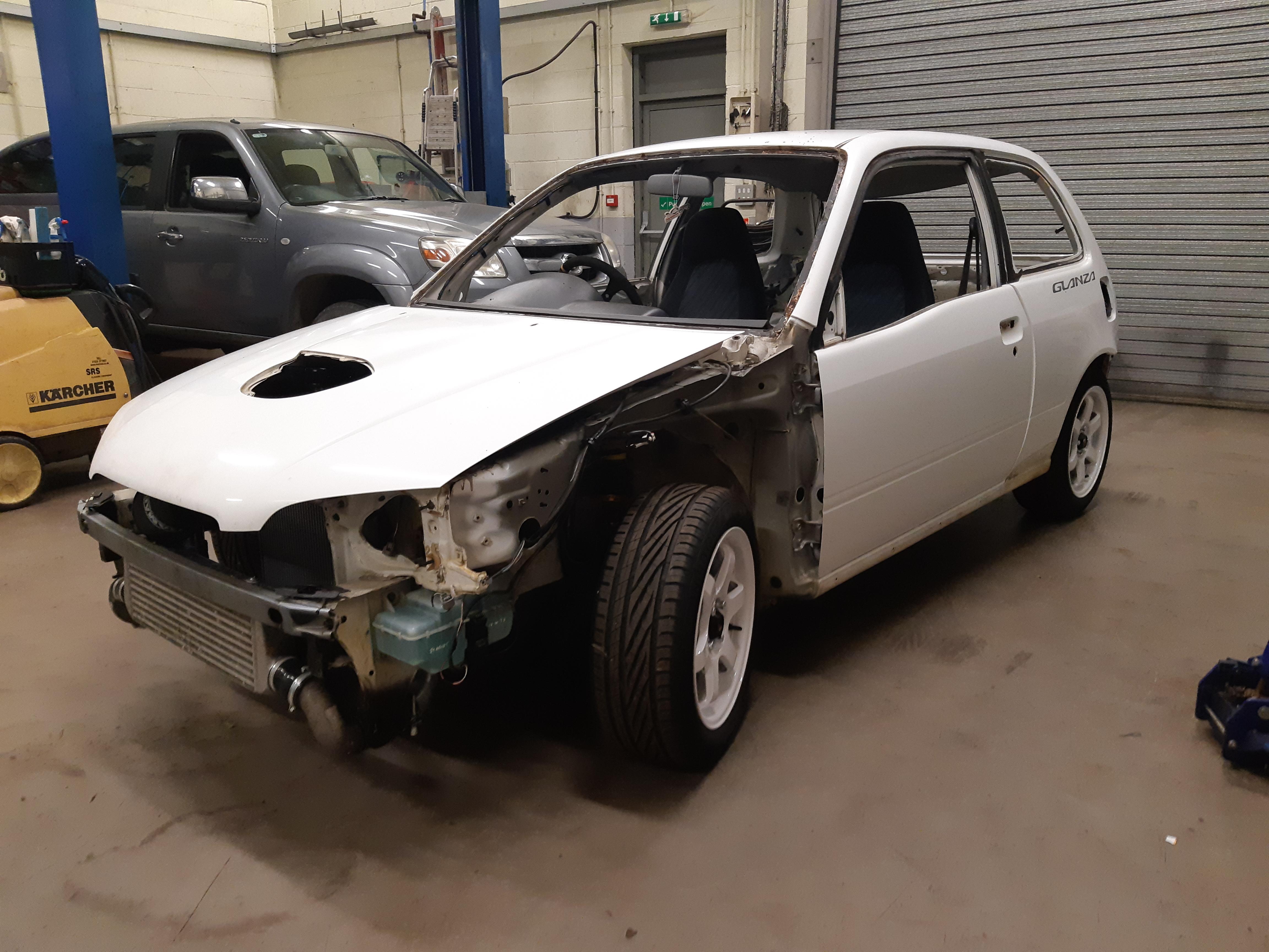

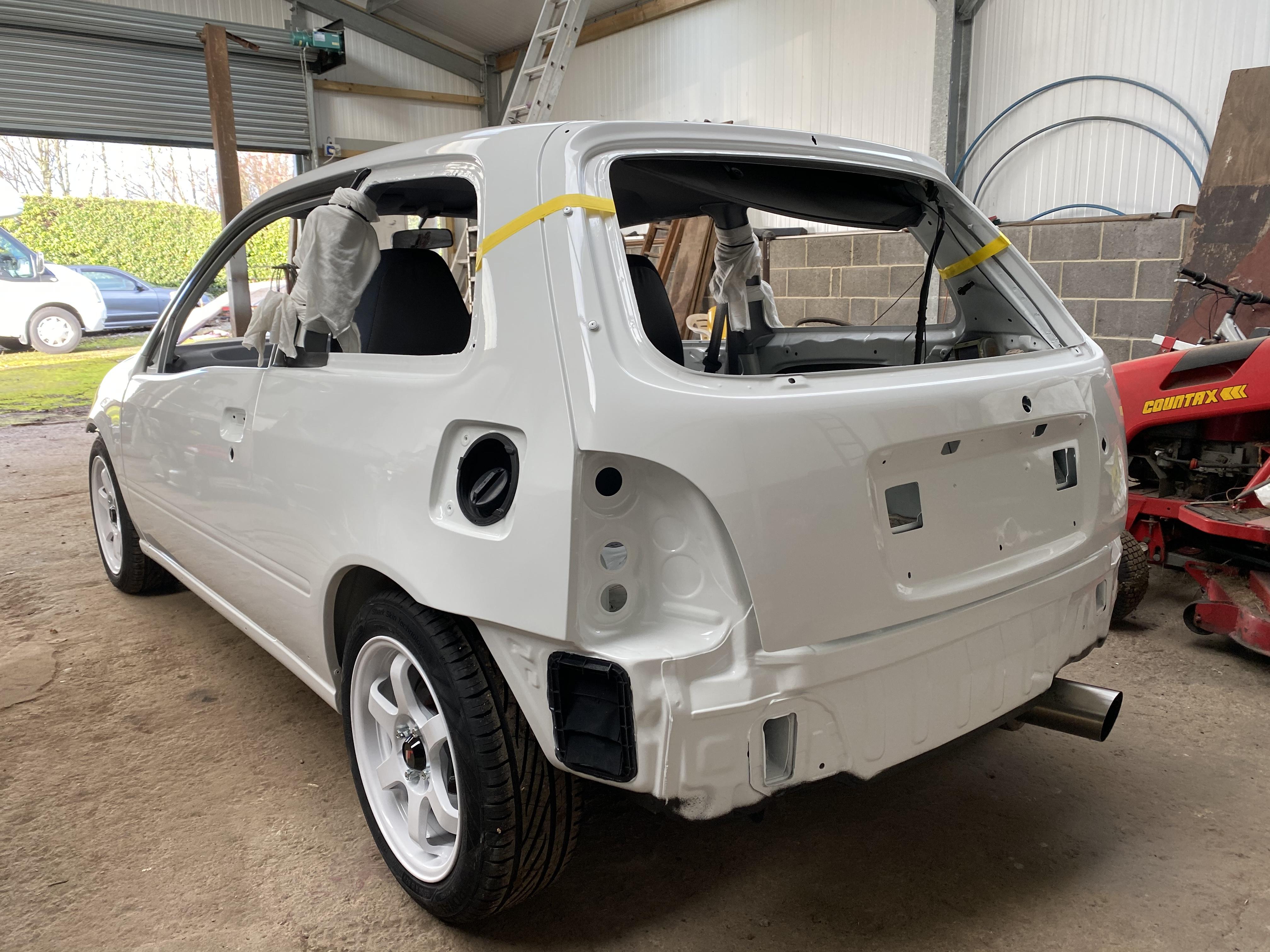

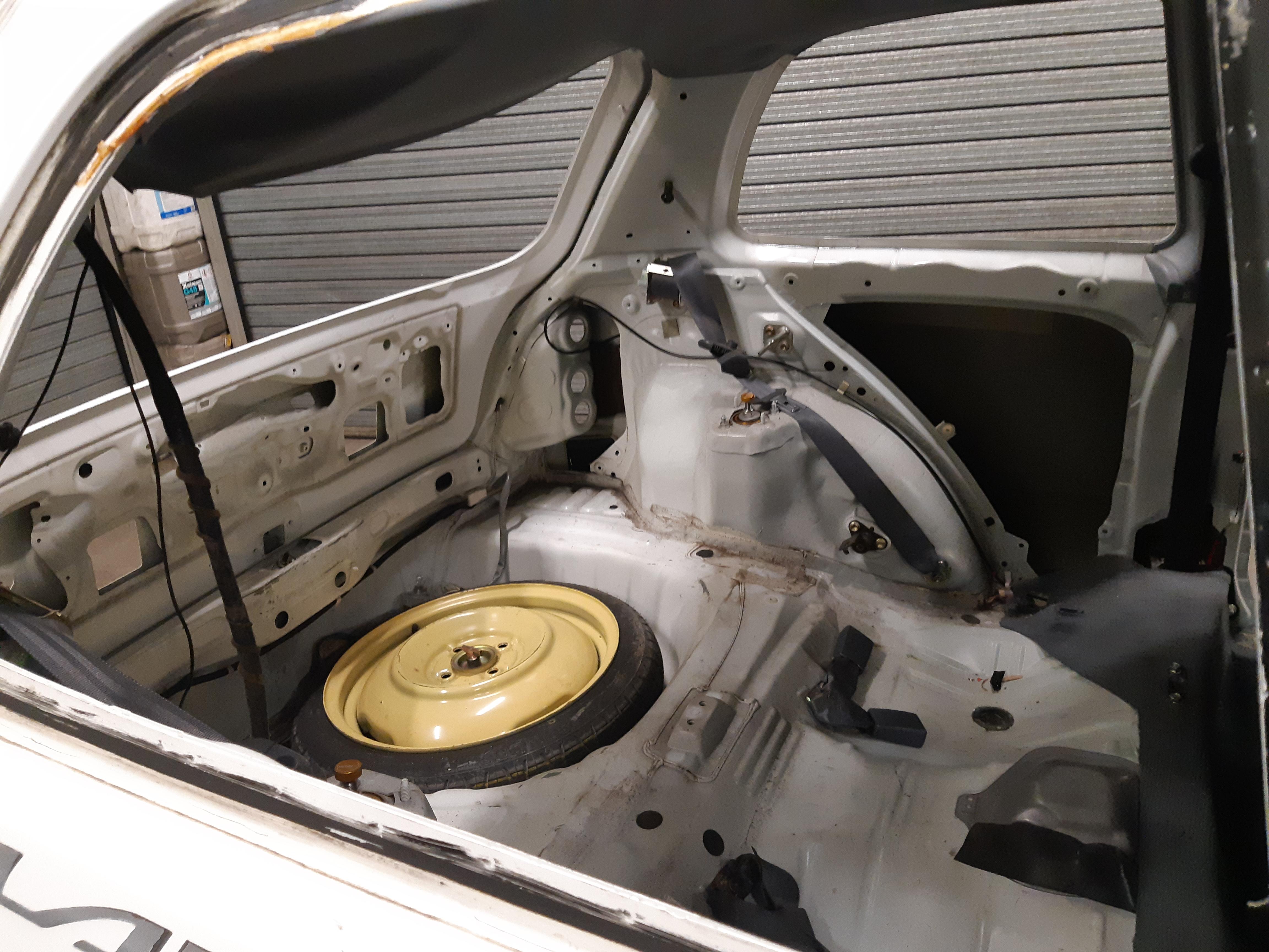

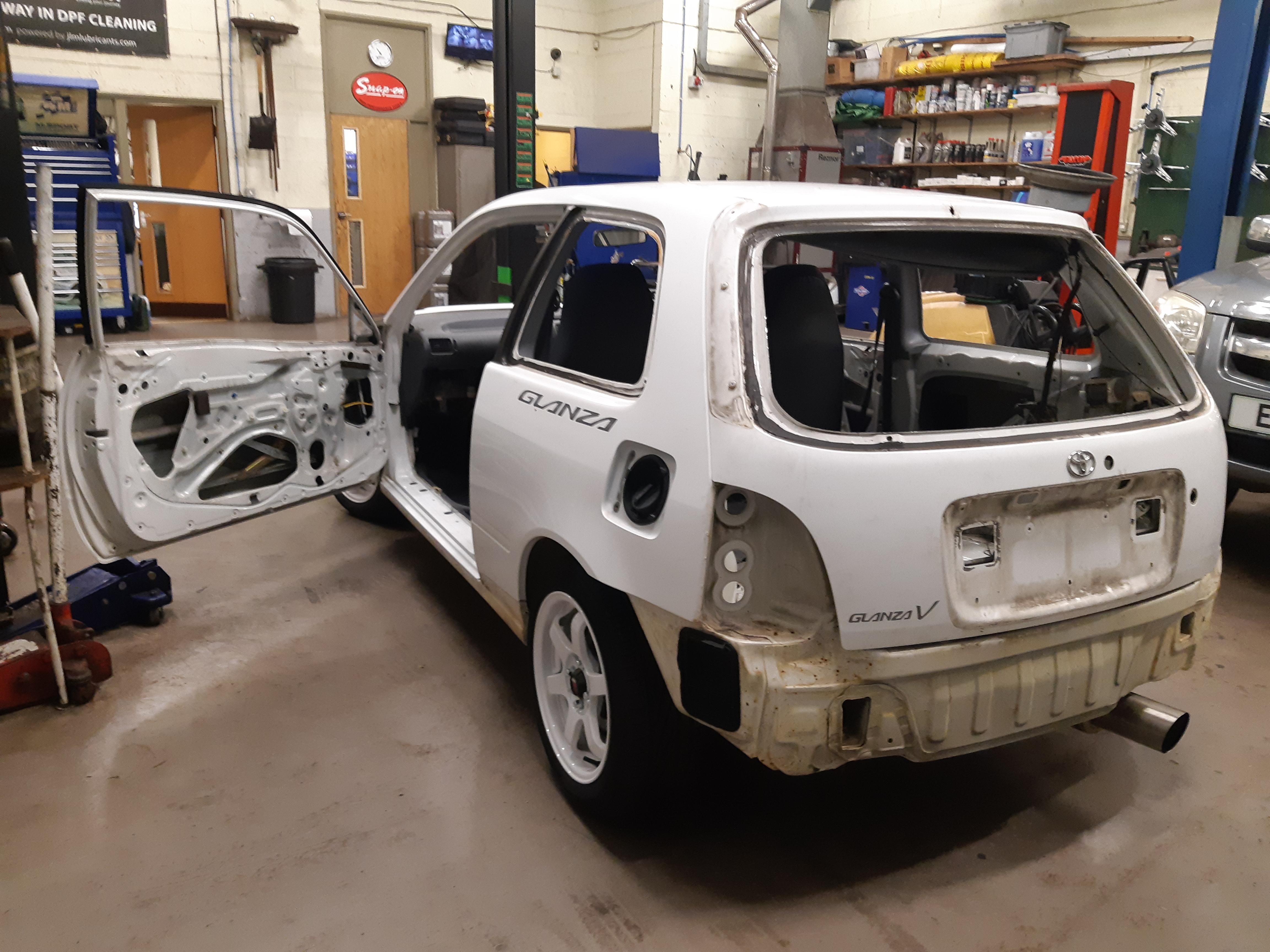

Made a start tonight on stripping the car ready for its trip to the bodyshop on monday. Windows are getting removed tomorrow then spend Friday stripping everything else out.

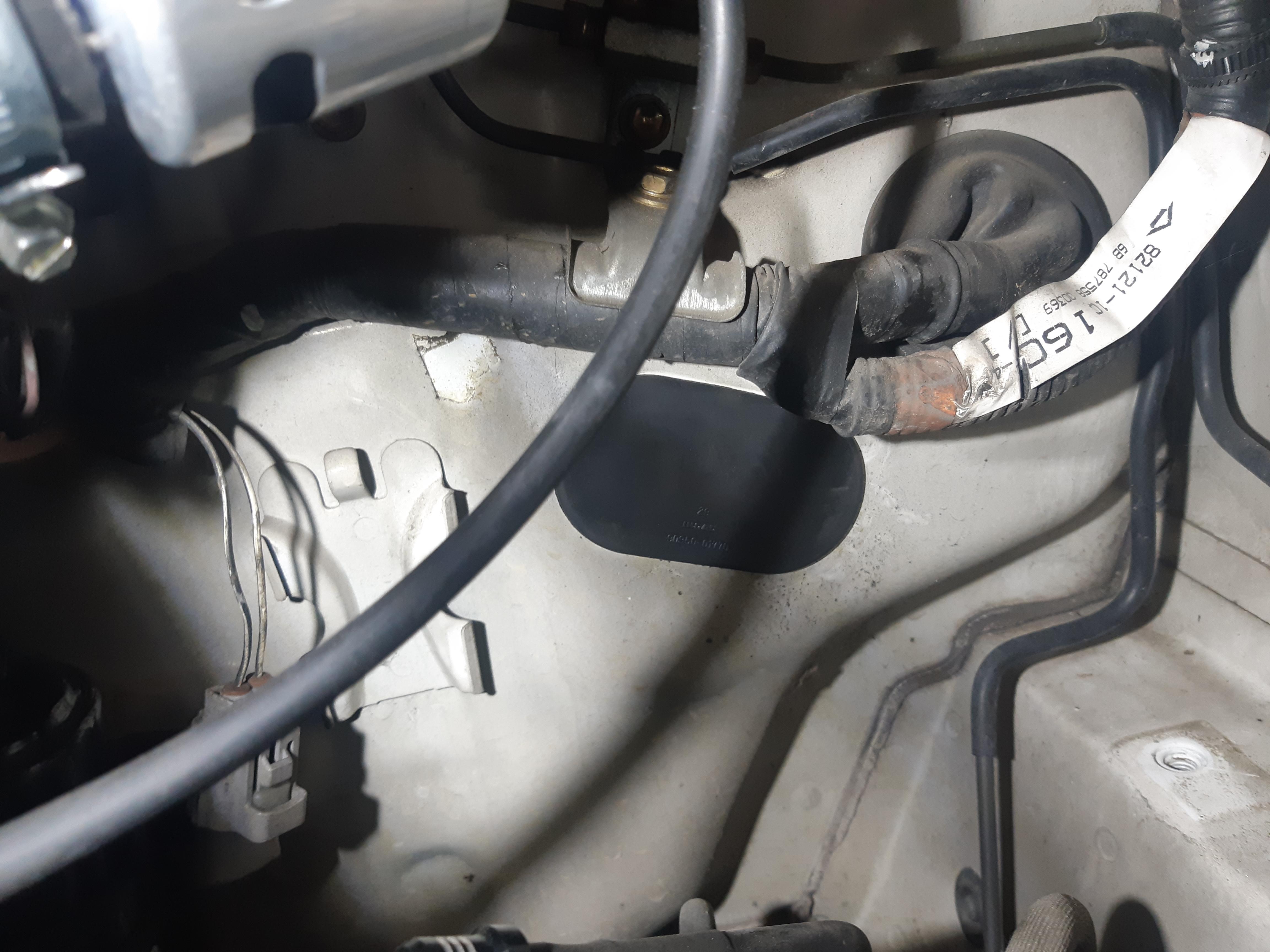

Also if anybody is removing their rear spolier it took me ages to figure it out as i presumed it was bonded on 🤦‍♂️😂... 2x 10mm's behind the wiring grommets ( 1 either side) then just slide it up.

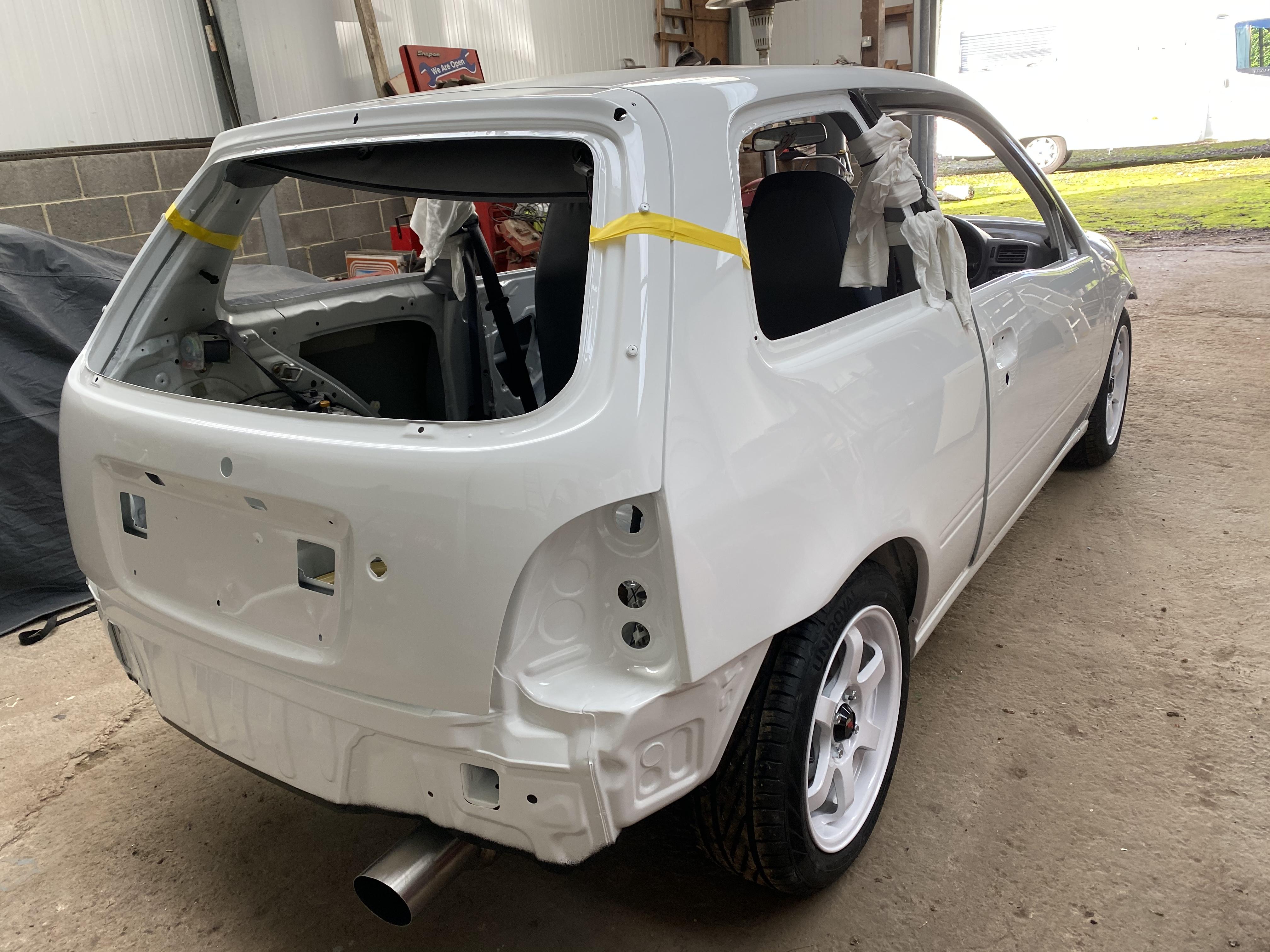

Thanks sam. I've gone over the top with getting it resprayed really, even the painter said it doesn't need a full spray but i want it to be immaculate
