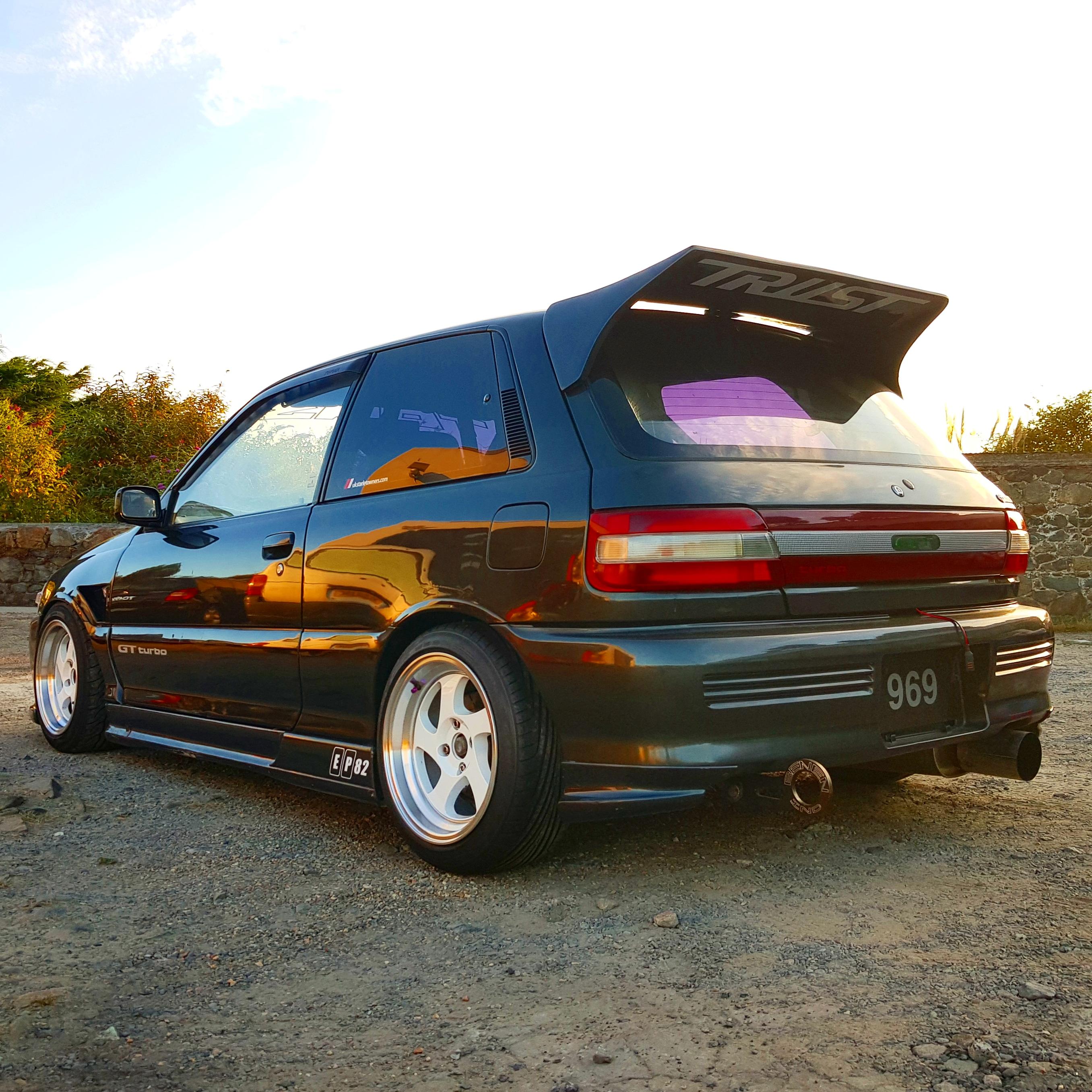

The new wheels arived and were test fitted

The wheels can then go back on, with tyres and with the new shimmed fitement

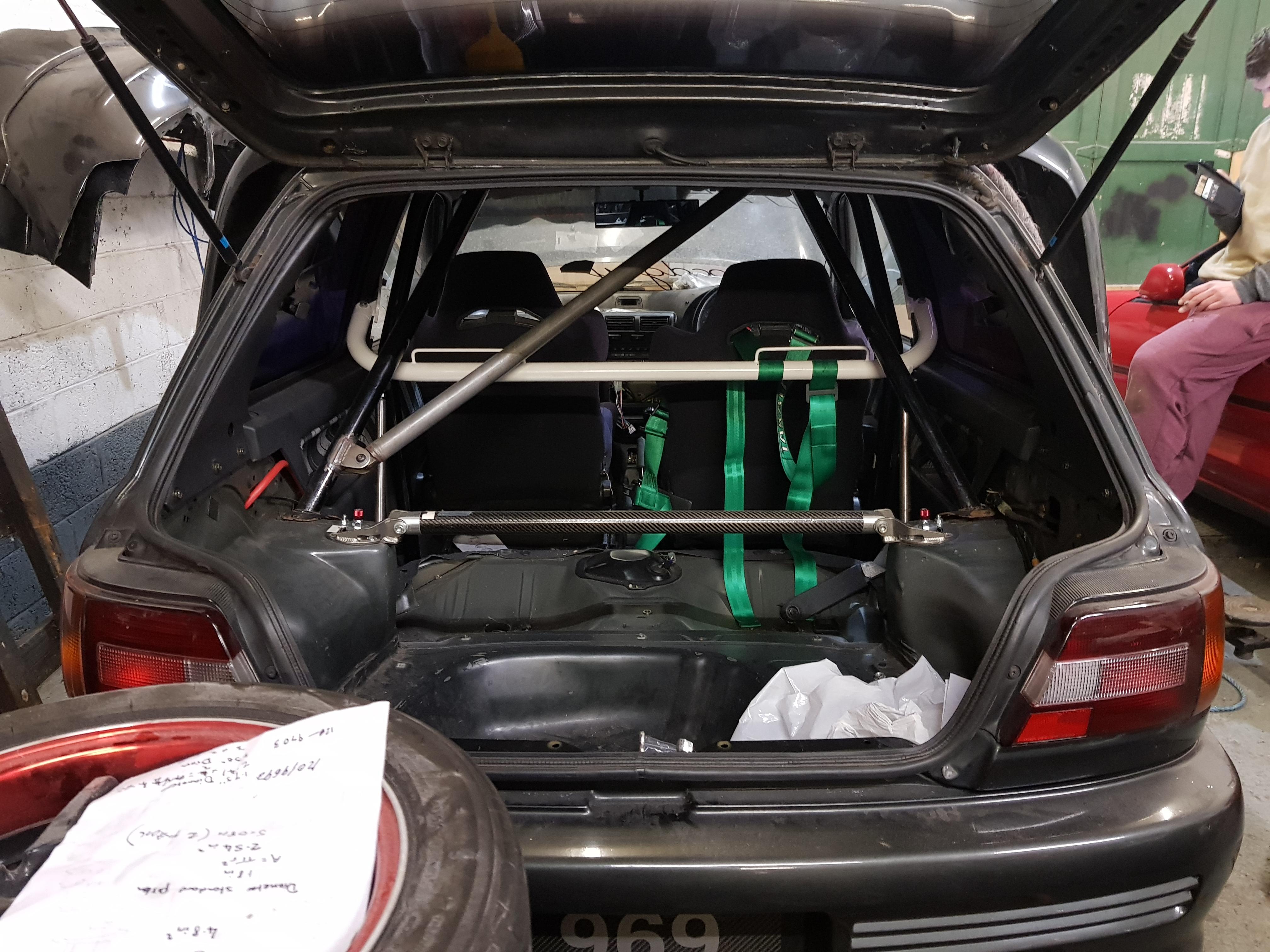

It was then time to start work on some special stuff for the interior, so the drill came out:
and the cage started going in, this was originally a cusco 4 point, but an extra diagonal has been added with tube from customcages and joints order from cusco in japan (the joints are eye waterinly expensive, but i wanted to keep it all authentic)
the harness bar was added, and it in the process of having the upright modified to work with the cage
The front is currently under progress with a set of Cruise style wings being bolted on
but theres where we are today, as always massive thanks to Kieran and Flint. This car wouldnt be anywhere without you guys

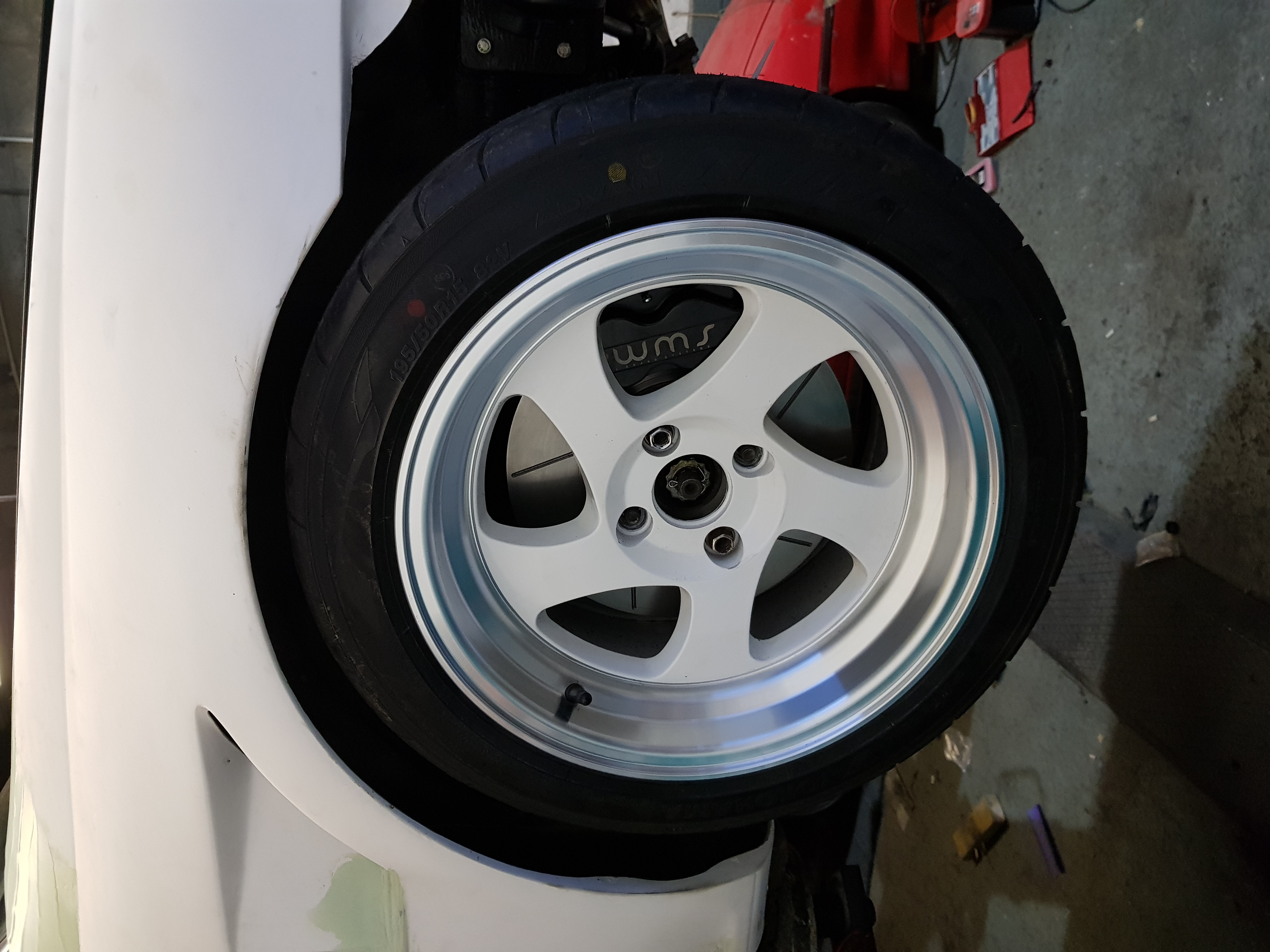

Okay, so biggggg update

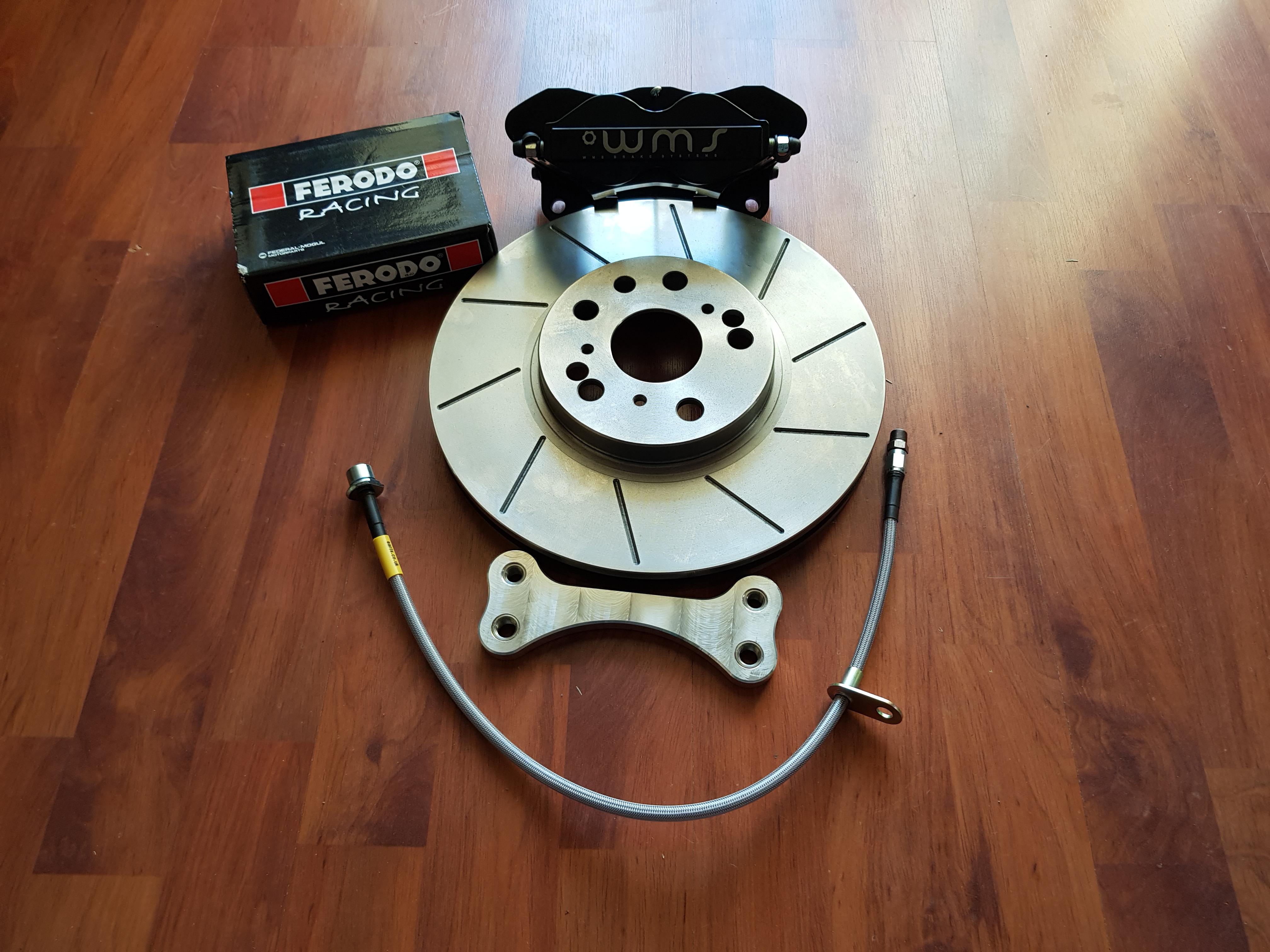

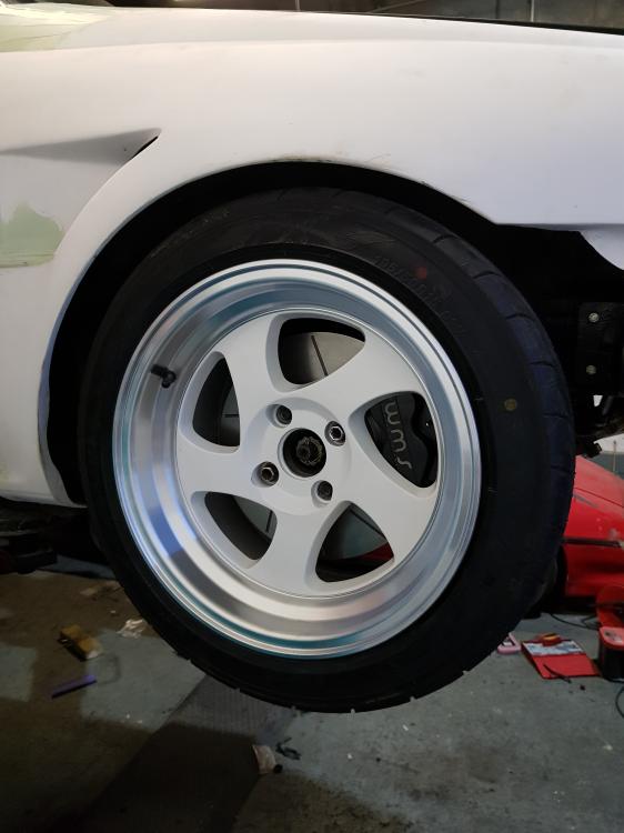

WMS brakes went on:

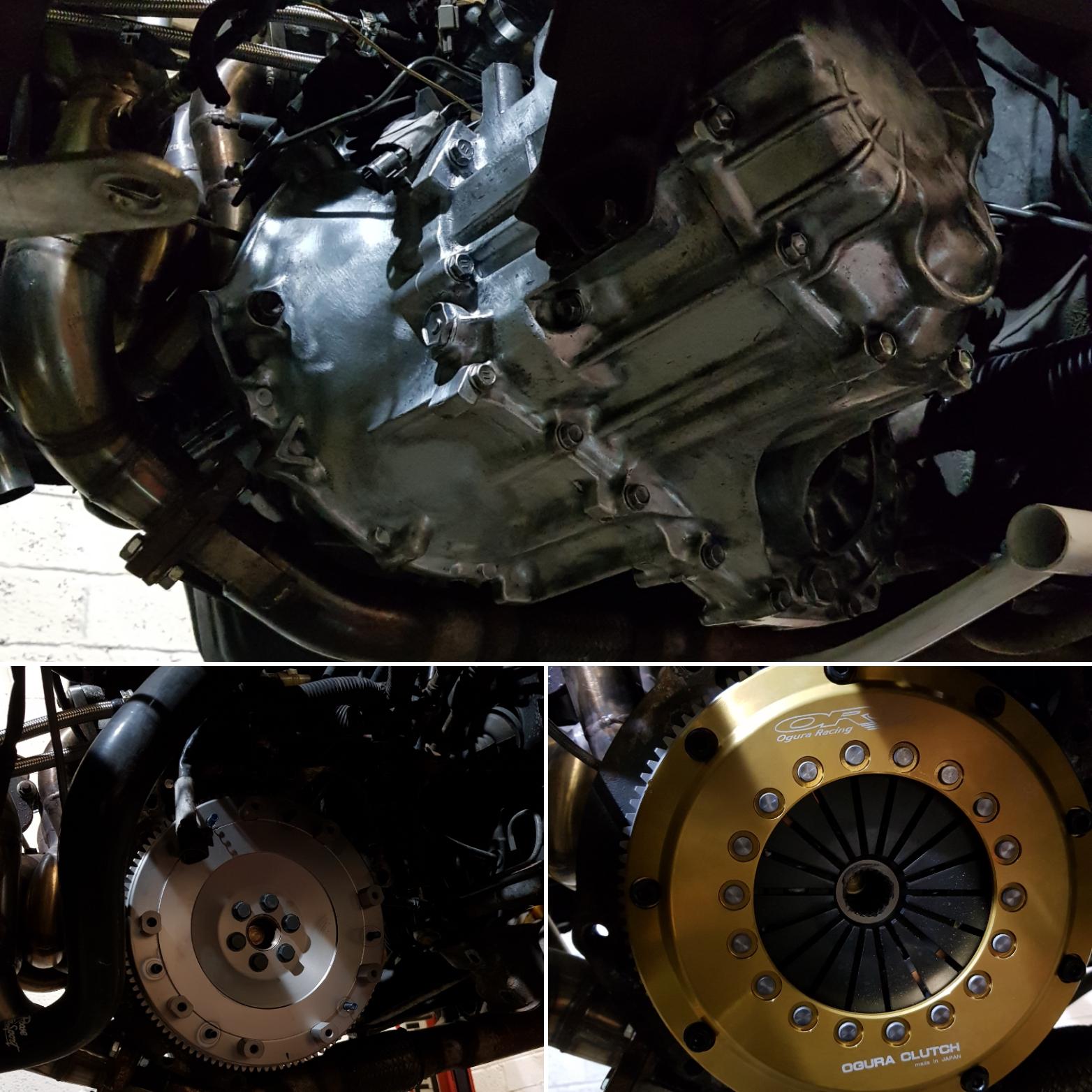

Gearbox, flywheel and clutch went in, went for a ORC 309D, the silent with the little springs, but it still rattles its twat off. Also got a new gearbox, which is a GT box with a Cusco plate LSD in it

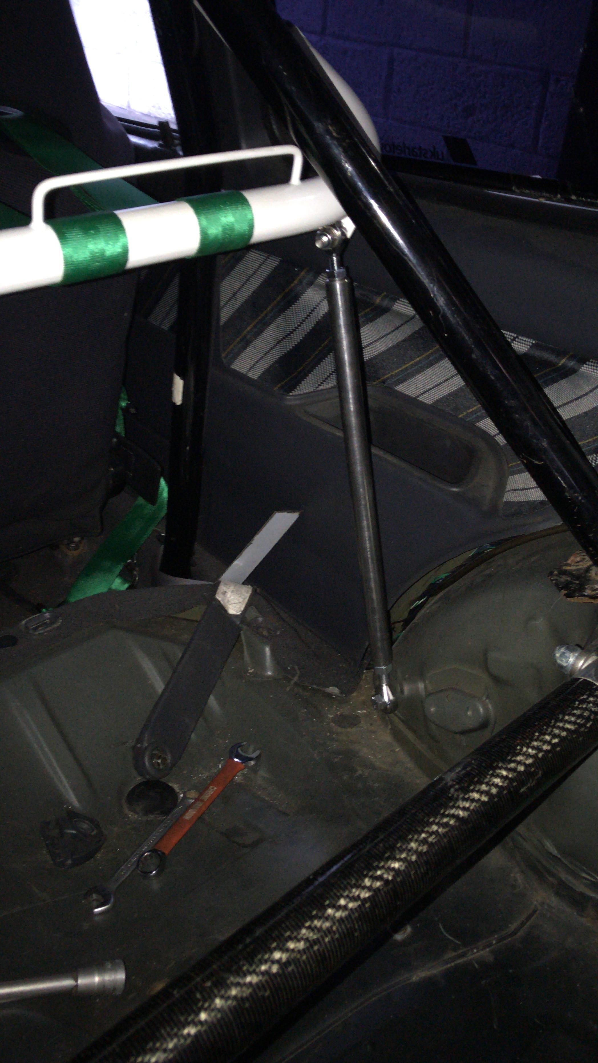

The uprights for the harness bar were fabricated by RobH (as I/the other boys were running out of time)
They came out on time and on budget, so if you have any little jobs like that that need doing. Rob is definately your man!

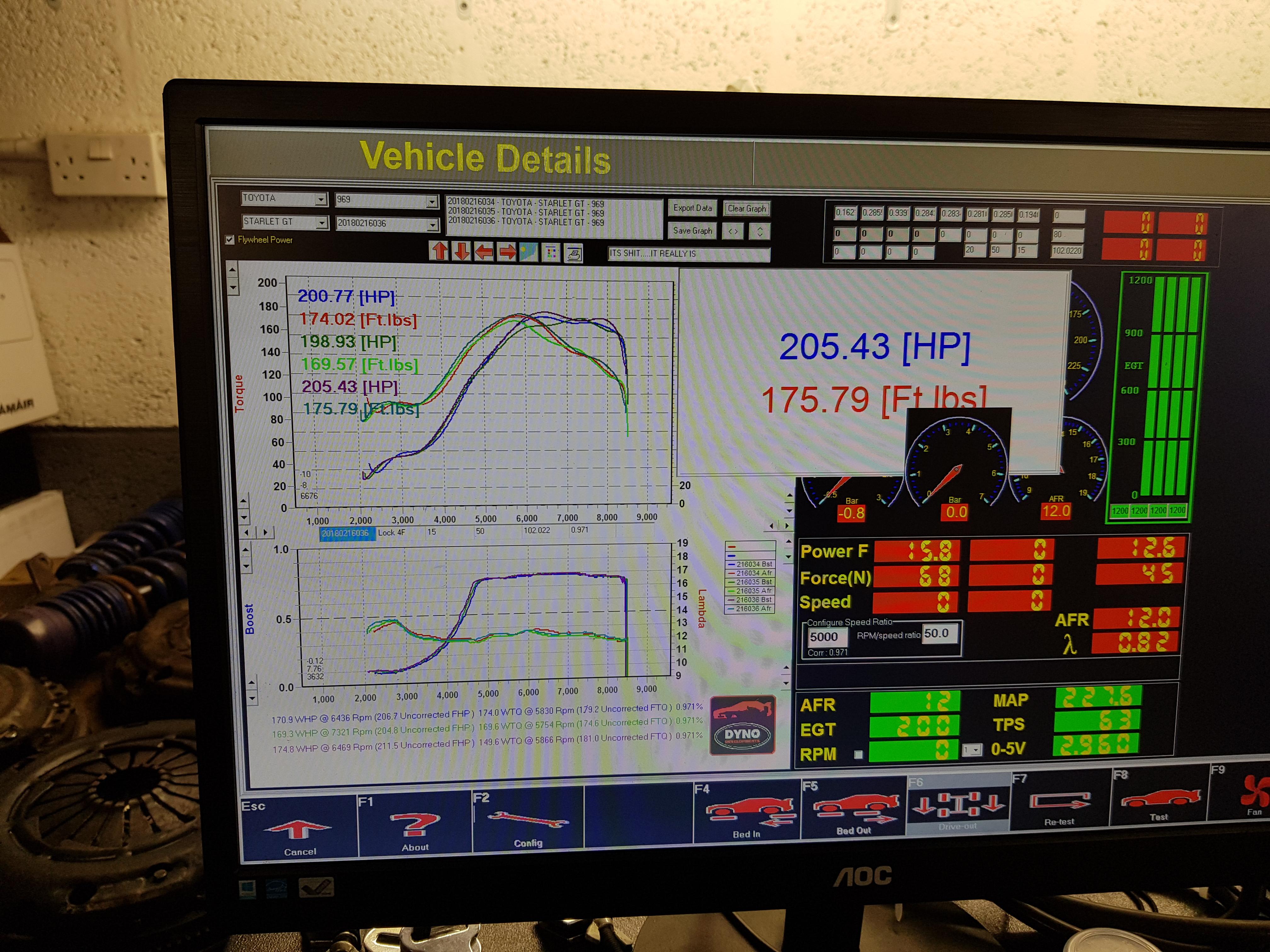

A little bit of mapping happened, just to get the car drivable. This is only at 0.8 bar, so is fairly  respectable figures. Eespecially to say the timing hasnt been touched yet

20 hours ago, TrisK said:
I love the wheels! What's the dimensions of them and did you have to pump the guards at all?
I am looking at some 16x8 Rota Grid V's for mine, but sure they'll fit without issues
They are 15x8 et20, with a 5mm spacer at the front, so effective et15
Custom rear camber, cruise wings up front and heavily rolled arches at the back.
they definately didnt bolt on
