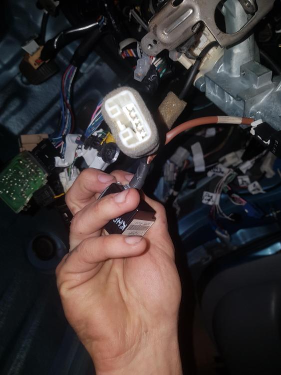

Got a 4efe ep91, ct9 turbo setup, with 4efte ep91 ecu, dash loom, engine loom, knock sensor, lambda, intake mani with sensors- havent got fte injectors tho! The car runs, for about 5 secs then dies unless i keep the revs up but then still dies just after, i got a feeling its either the injectors or the 4efe had a transponder to plug into on the fe loom although the 4te loom doesnt have the plug for this, will my ecu be missing a signal through the immobiliser on the barrel? If the fte even has one as standard..thanks for any help or advice in advance guys, im more than happy to just bypass this by the way! The brown sheathed cable is it going in the one side ( or was when plugged in) and the black is it i believe coming out the other and potentially going back to the ecu
