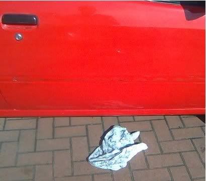

was removing the bump strips from my car the other day and took off the first side and noticed some sort of bond had been used to refit them in the past, this is only the drivers side the passenger side bump strips just had the usual nasty glue
is there anyway to remove this safely without to much bodywork damage??ts not looking to good at the moment :)
Hairdryer to heat the stuff up and then peel.
The other stuff may require you to carefully pick off with a credit card or something similar that isn't sharp.
Once most of it has gone give it a wipe with some polish or similar.

Asad_EP91_5Dr Agrees and recommends an Eraser Wheel

EP91face tried and confirms it works :
