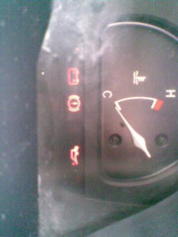

also these lights have always been on in my car since a little after I've had it with the old and new engine..the new engine was drained of oil and supposedly refilled by the mechanic but when i checked earlier on the dip stick only had about an inch or 2 of oil up it is that right? car is facing downwards on a slope as my garden is basically a 45 degree parking space
these are the lights
(hand brake is on)
Ok, you wont get an accurate oil reading on a slope so get it on the flat and check it. Also i'm guessing those lights are on when you turn on the ignition, this is normal, when you start the engine they will/should go out exept the handbrake obviously! :) oh and the reason it wont start is your battery is flat
