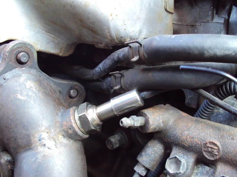

starlet-glanza-v Posted August 31, 2010 Posted August 31, 2010 just fitted decat got new lambda sensor but its hitting on another hoseheres a picany ideas??thanks Quote
james@cjperformance Posted August 31, 2010 Posted August 31, 2010 what decat is it, you could run it without lamda in and but a nut to block the hole from a good exhaust place, they are around £5 Quote
glanza97 Posted August 31, 2010 Posted August 31, 2010 just fitted decat got new lambda sensor but its hitting on another hoseheres a picany ideas??thanksis it really a problem, should be fine that shouldnt it? Quote
james@cjperformance Posted August 31, 2010 Posted August 31, 2010 the lamda gets really hot and could go through the hose which is a coolant hose for the turbo. Quote
glanza97 Posted August 31, 2010 Posted August 31, 2010 could replace them hoses with some flexible braided lines, it would look nice too =P Quote
starlet-glanza-v Posted August 31, 2010 Author Posted August 31, 2010 think im gona have to replace them, n i got no idea what decat it is!cheers for help! Quote
Carl. Posted August 31, 2010 Posted August 31, 2010 I reckon it will still catch on metal part of coolant pipes tbh might have to relocate it or not use one. Quote
Carl. Posted August 31, 2010 Posted August 31, 2010 Would take a machine shop about ten minutes to weld a screw in and cut it off then drill another hole n weld another nut in a better location Quote
starlet-glanza-v Posted August 31, 2010 Author Posted August 31, 2010 i wish it was as easy as heat wrapping it Will try to bend around but if it does still hit the metal pipe underneath the pipe will have to get it relocated!!Cheers for the help Quote
