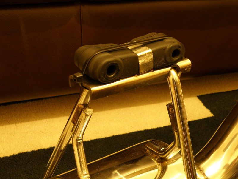

Bex Posted October 30, 2010 Posted October 30, 2010 I am trying to fit my exhaust system onto my ep91 and the back box brackets have a plate welded over the top which means its not fitting, the exhaust arrived like this brand new.Any help for fitting this can I just cut the plate off?Here is a link to the exhaust.http://www.japspeed.co.uk/Toyota-Starlet/T...tem/p-27-1-749/ Quote
Ryan-11 Posted October 30, 2010 Posted October 30, 2010 no dont cut it off, your old exhaust should have a rubber mount that fits in the rectangular hole at the top, take it off and put it on your new exhaust Quote

Bex Posted November 4, 2010 Author Posted November 4, 2010 I found this out soon after I posted this. My current exhaust is a custom one so has the 2 individual hangers I didn't realise the new one was the standard fitment! Quote
1987glanza Posted November 4, 2010 Posted November 4, 2010 I've just put the same system on my glanza its a piece of piss to fit, wd40 & a screw driver works a treat putting the rear rubber in the hanger.sounds fantastic wen the insert is removed from b/box Quote
addz Posted November 4, 2010 Posted November 4, 2010 Mine was the same as yours, custom exhaust had two seperate bushes.What you need is a standard bush/rubber from Toyota. Same as below - hope this helps; Quote
