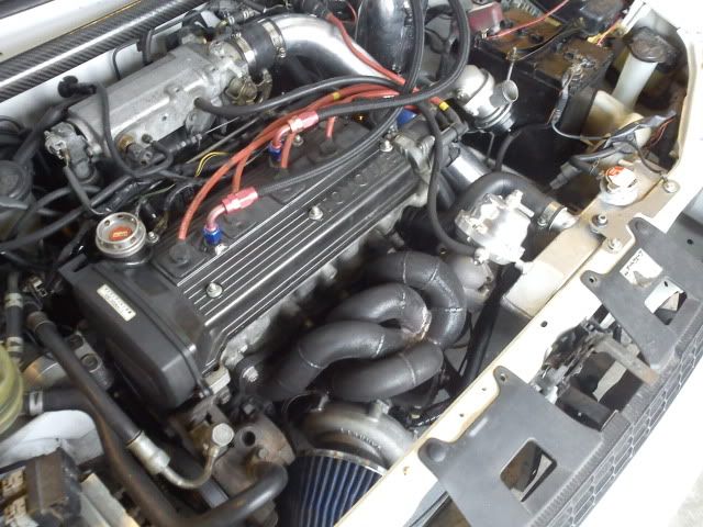

should look like this, apart from my vacuum goes to my inlet mani because i dont have a vacuum port on my turbo.
the top is to pre charge the spring pressure. so if your spring pressure is 0.8bar if you allow 0.2bar to enter the top it will give you 1 bar of boost pressure if you get me. you will need to pipe in a bleed valve or possibly a electronic boost controller. :thumbsup:
