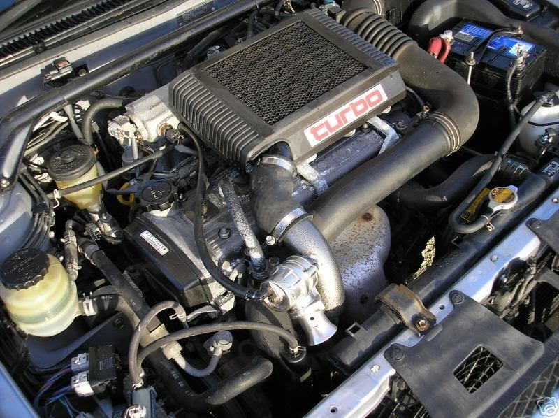

Alright matey, most blitz bov's come with a strange flange and a special intercooler pipe.
Just literally swap the intercooler pipes over, by removing the jubilee clips.
Screw the bov to the pipe , making sure to use the gasket between the bov flange and the intercooler pipe flange.
run the vacum line to the intake as in the picture.
the memorys of v when it was standard
