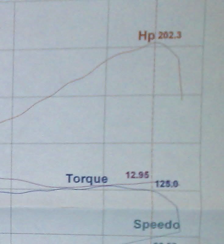

Tintin_SR Posted July 12, 2007 Posted July 12, 2007 We wear at the rolling road the other day with my brow in the 1.6 VTI and wee got 202.3 hp at wealâ??s and 125..0 torque at 8500rpm!Have you been if so what you get?tinitn Quote
Sparky Posted July 12, 2007 Posted July 12, 2007 Is the torque really that bad in them Vtecs Thats a huge difference between bhp and torque Quote
Tintin_SR Posted July 12, 2007 Author Posted July 12, 2007 Is the torque really that bad in them Vtecs Thats a huge difference between bhp and torque aye mate, torque is very bad! thats why thay rev so hard. my brothers torque is much better than a standard one, 112 nm.his also has 1000 more rpm tham standard Quote
Tintin_SR Posted July 14, 2007 Author Posted July 14, 2007 202 @the wheels? Fuck me thats a good result? Turbo or heavy tuned B18? Yeah the torques a joke on vtaks, always the butt of the jokes ita a b16a2 N/A with lots o ££ spent on it got the lot Quote

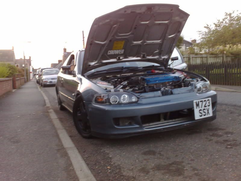

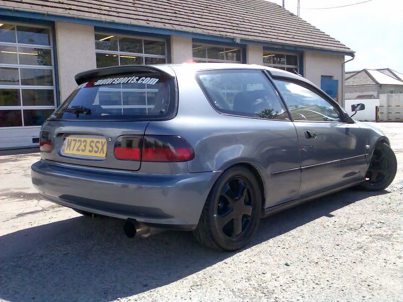

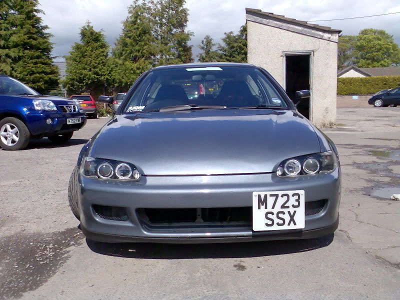

Nick_p Posted July 14, 2007 Posted July 14, 2007 Wow, thats making some good power.go any pics of the car? Quote
Tintin_SR Posted July 14, 2007 Author Posted July 14, 2007 Wow, thats making some good power.go any pics of the car?yer her you go lol am old phone!pic from my new phonetintin Quote
Idrees Posted July 14, 2007 Posted July 14, 2007 That looks mean! Standard headlights with Amber corners would suit it better imo, still very nice though! Quote

Tintin_SR Posted July 14, 2007 Author Posted July 14, 2007 That looks mean! Standard headlights with Amber corners would suit it better imo, still very nice though! thanks bud Quote

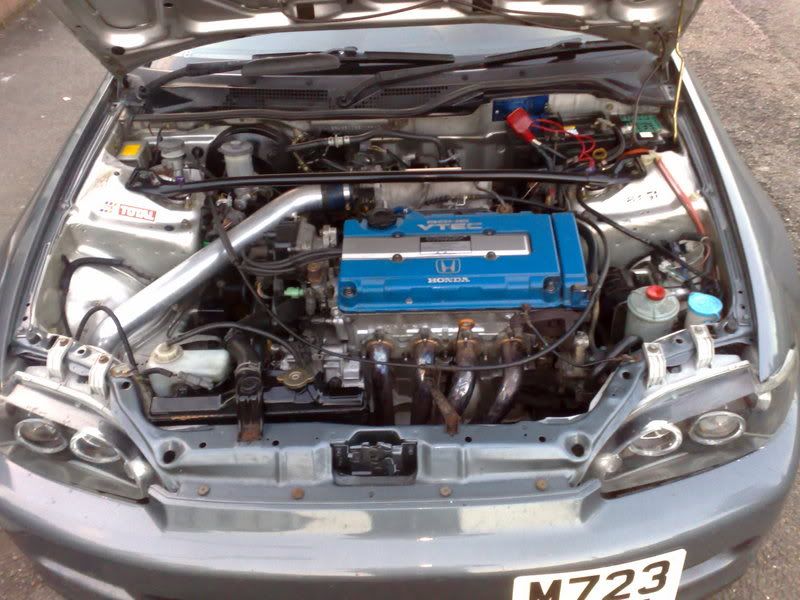

Tintin_SR Posted July 14, 2007 Author Posted July 14, 2007 fuck thats minted man!!!1could you break it down and tell me what your bro has man??also do one of those guys ahve that b20???alrite boys, its aidan, tintins bro. think he got his wires crossed with my dyno sheet. its at the fly. its a block from an SIR2bored out to EK9 speckEK9 pistonscrower stage 2 cams with standard idle lobesEK9 valve springshondata inlet manifold gasketskunk 2 inlet manifoldlong ram intakemugan 4 branchsocketed ECU ostrage emulatorchrome softwere9200rpm limeterVtec rased (needs to be higher to sort out the flat spot)2.7" strate threw to jap stile canfidanza fly wheelstage 1 clutch integra gear boxcusco mechanical LSDthink thats about it. Enzo, i here you want to do somthing with your civic? B20? am going that way when i have more cash. guna go stage 3 cams with titanium valve train so it will rev to 10000rpm to get the best out of the cams!am guna do way with those lights!enzo, geez a bell 07737677916 and talk civic! Quote
