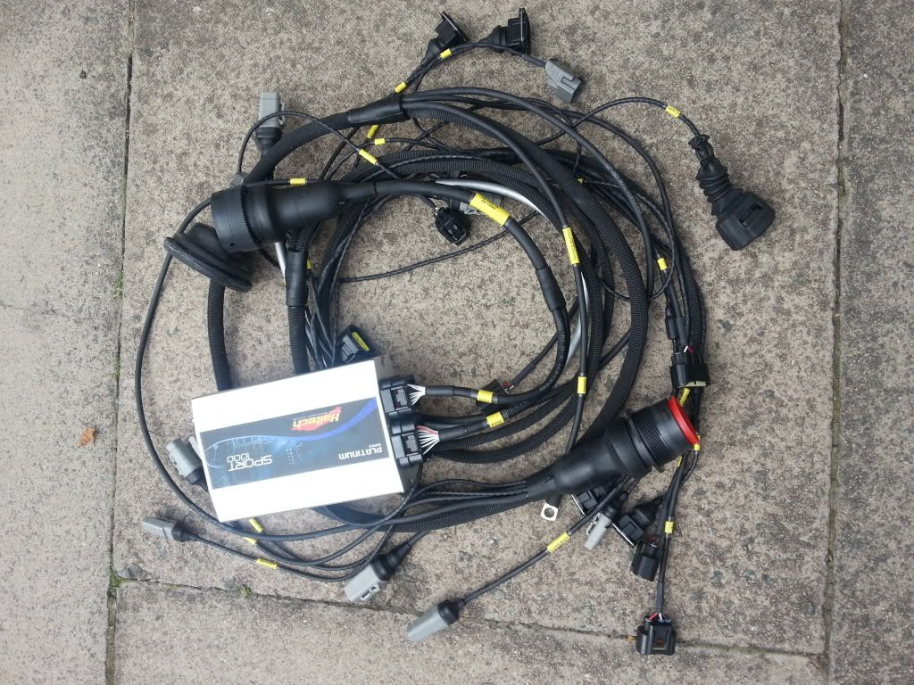

My current loom with my old ecu...

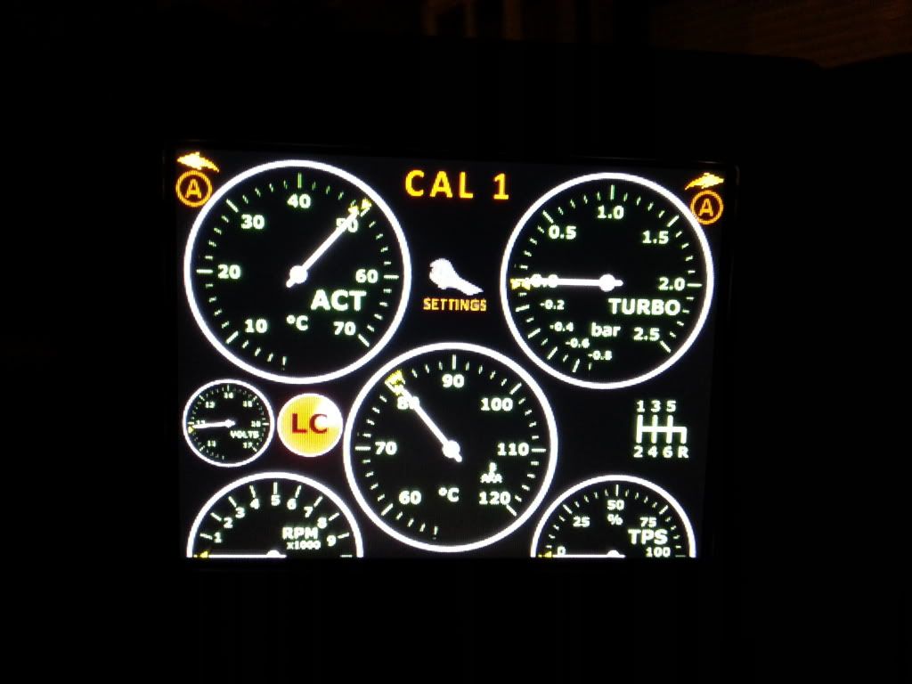

My current ecu/performance monitor...
Its touch screen; your can select any and everything.
