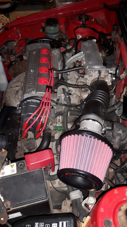

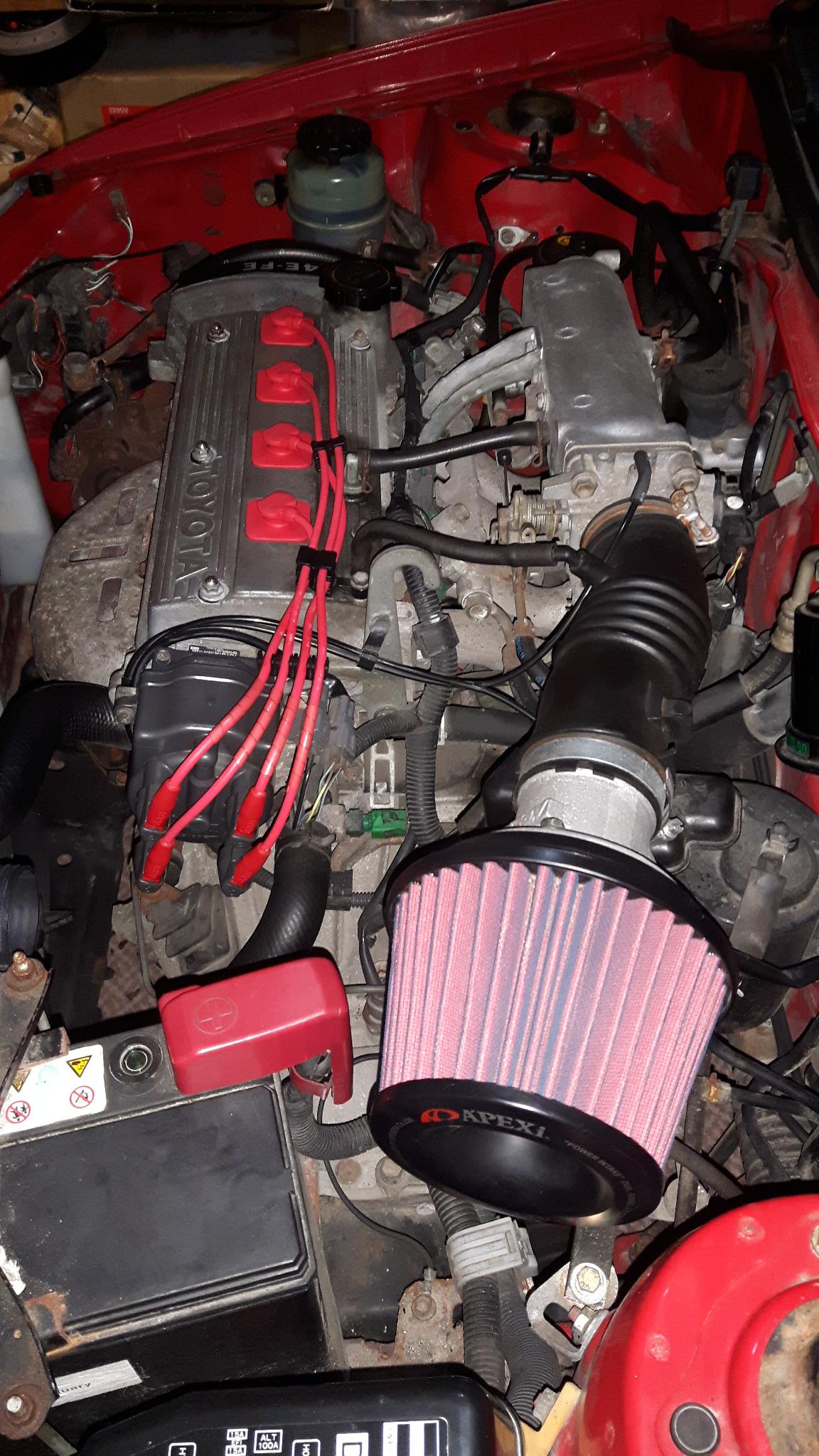

- brand new A'PEXi 'POWER INTAKE' Dual Funnel Intake Kit (P/N 508-T015, Black 160mm Type, diam 65mm outlet) - FITTED Sep2013
- brand new ''Ash'' Air Filter Heat Shield - Oct2013 - STILL NOT FITTED!

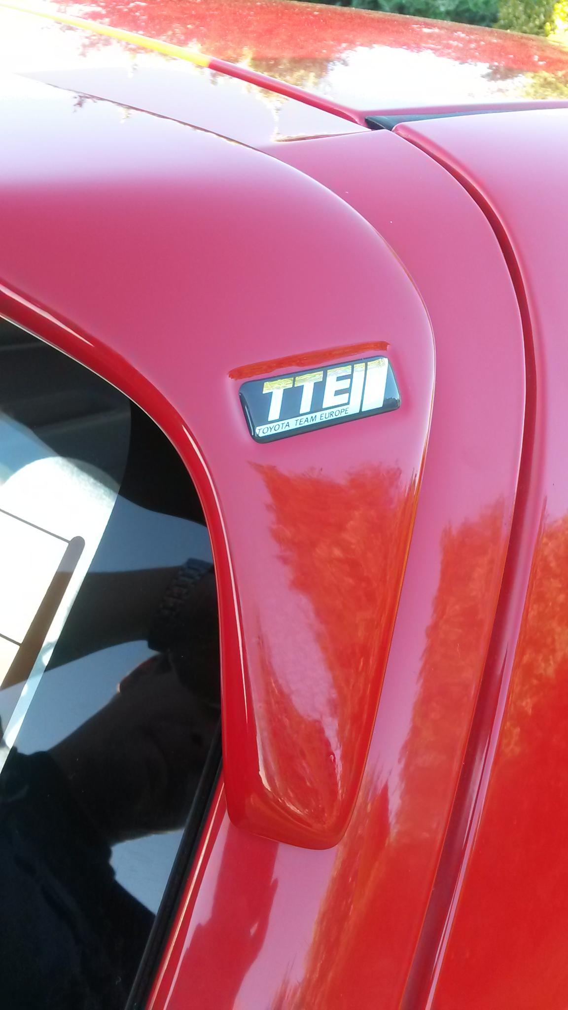

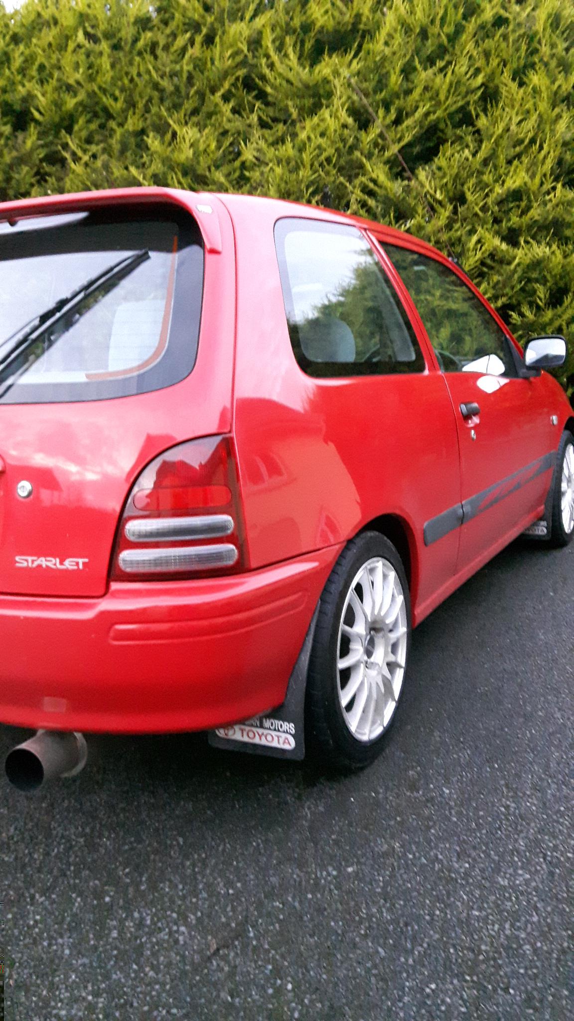

- 2nd hand TTE rear spoiler (OEM Starlet SR) - Mar2015, new paint - FITTED May2016
- brand new genuine TTE Gel Stickers (Part No: PZ439-10671-4P) for the above - Mar2015

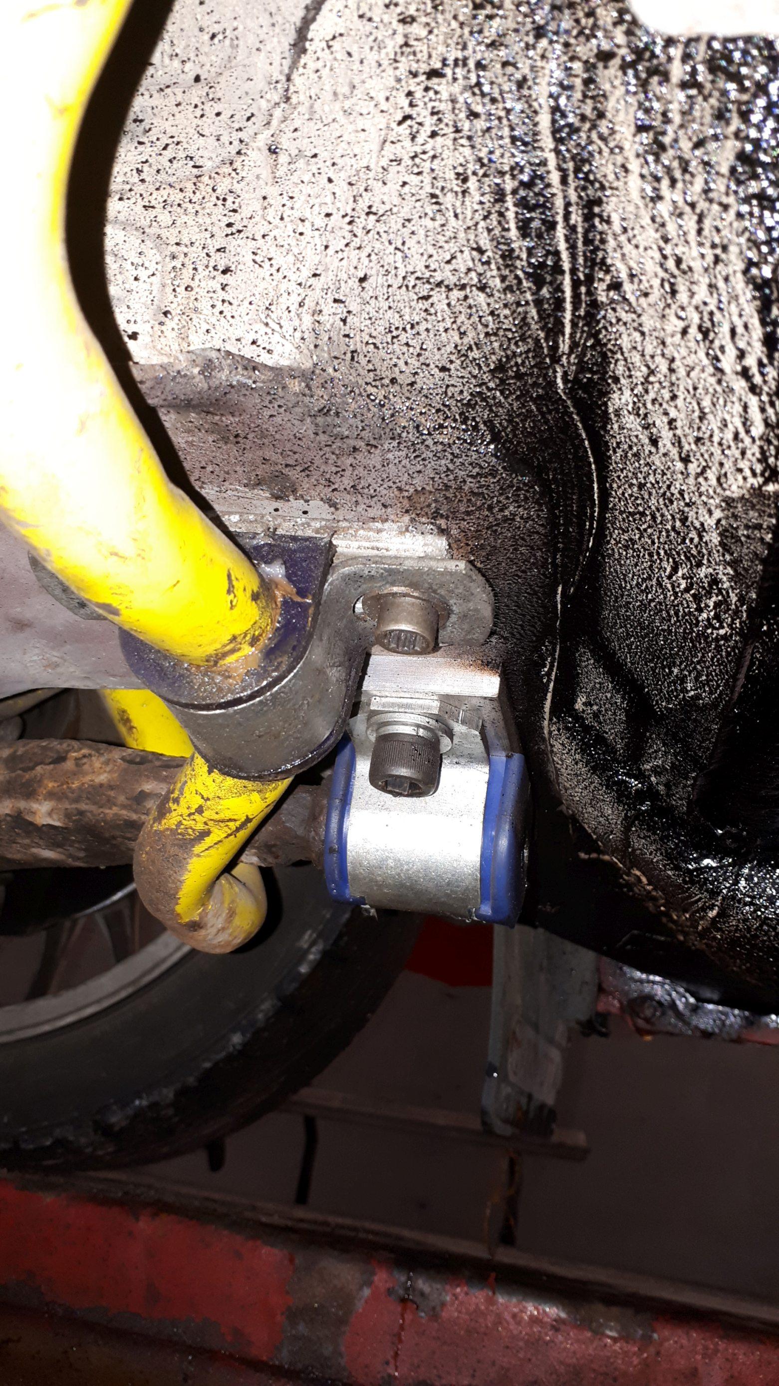

- 2nd hand TRD Front Anti Roll Bar /Stabilizer /Sway Bar (Part No: 48810-EP800) - FITTED Jul2015
- brand new Poly-Bushings (urethane) for TRD ARB:
24mm SuperPro Universal Anti Roll/Sway Bar Clamp and Bush Kit - PN SPF5450-24K - (replaces TRD PN 48815-AE850) - FITTED Jul2015
SUPERFLEX Polyurethane REAR ANTI ROLL BAR LINK PIN UPPER KIT SF358-0903-4K - (replaces OEM PN 48817-10020) - FITTED Jul2015

- 2nd hand Tubular Intake Manifold from 3rd Gen. 4E-FE Toyota Corolla E11 1.3 1998 - Jul2015 - finally FITTED Oct2018
(genuine brand new OEM mani gasket and TB gasket bought from Toyota Poland - Jul2015)

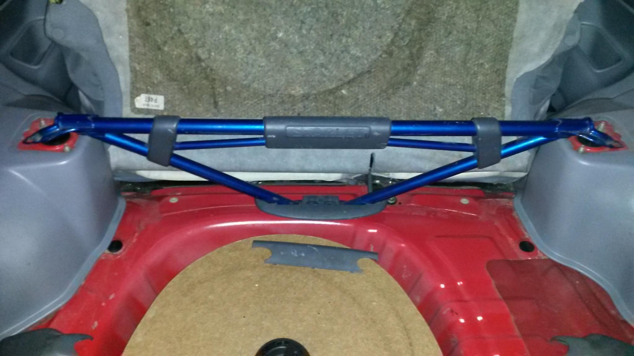

- 2nd hand OPTIONAL EXTRA OEM STARLET REAR STRUT BRACE / 3 POINT 'V' TOWER BAR with all the plastics - Nov2015, to be painted red! - NOT FITTED YET...

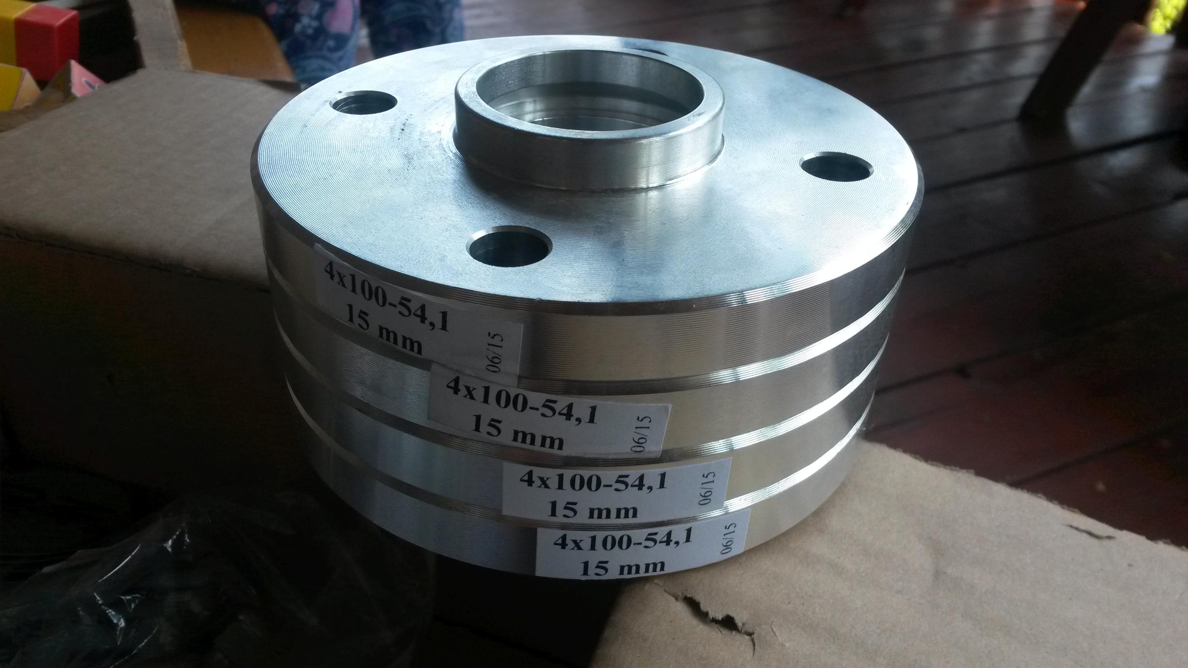

- brand new WHEEL SPACERS: 15mm (30mm per axle) - PCD: 4x100, 54.1mm center bore, O.D.: 133mm, Jul2015 - FITTED Oct2015
also - extended studs 12x1.5 62mmwere got for the above

- 2nd hand TRD Spark Plug Cord Set (Sport Ignition Leads): PN 19051-EP801 - FITTED Feb2017

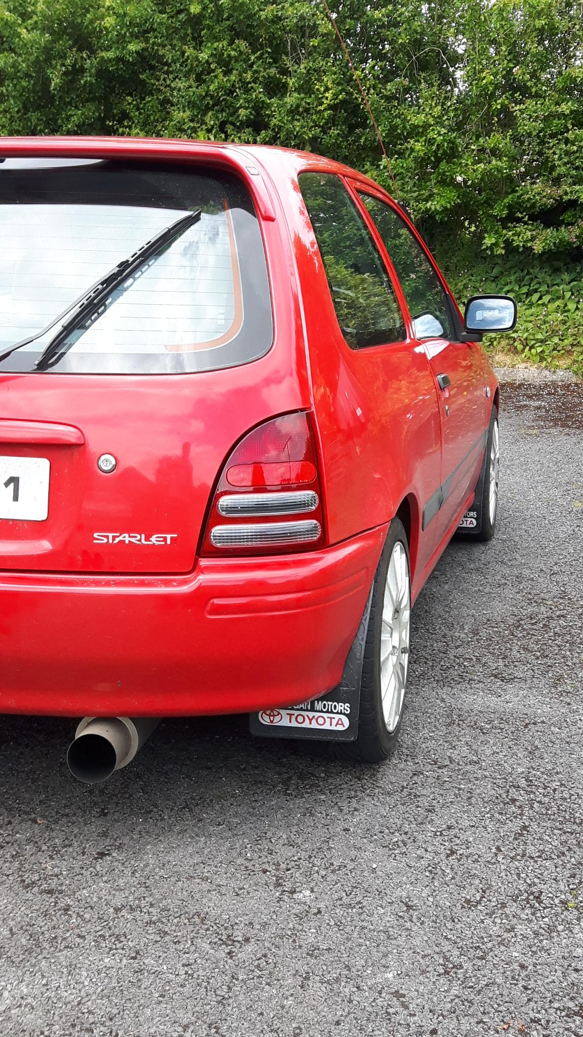

- 2nd hand OEM '98 spec Reflet REAR LIGHTS (red over white) - FITTED May2017
- brand new Silvatec P21W Chrome Bulbs (Part No.BU343S) for above - FITTED May2017

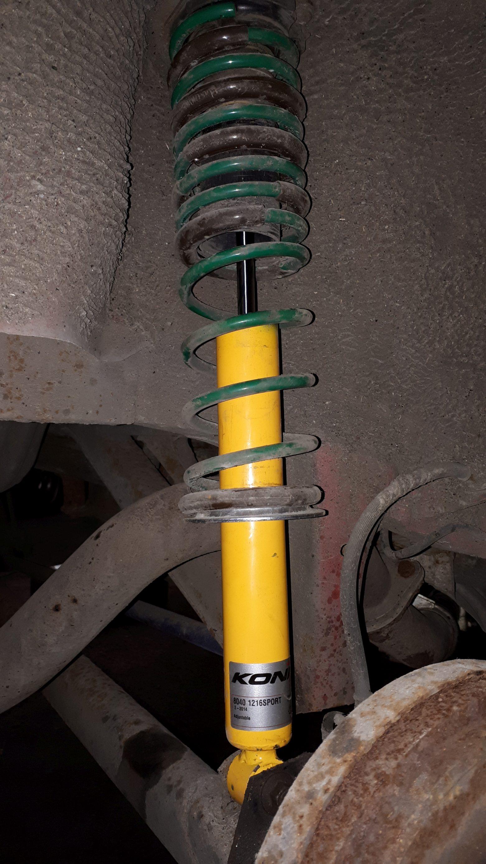

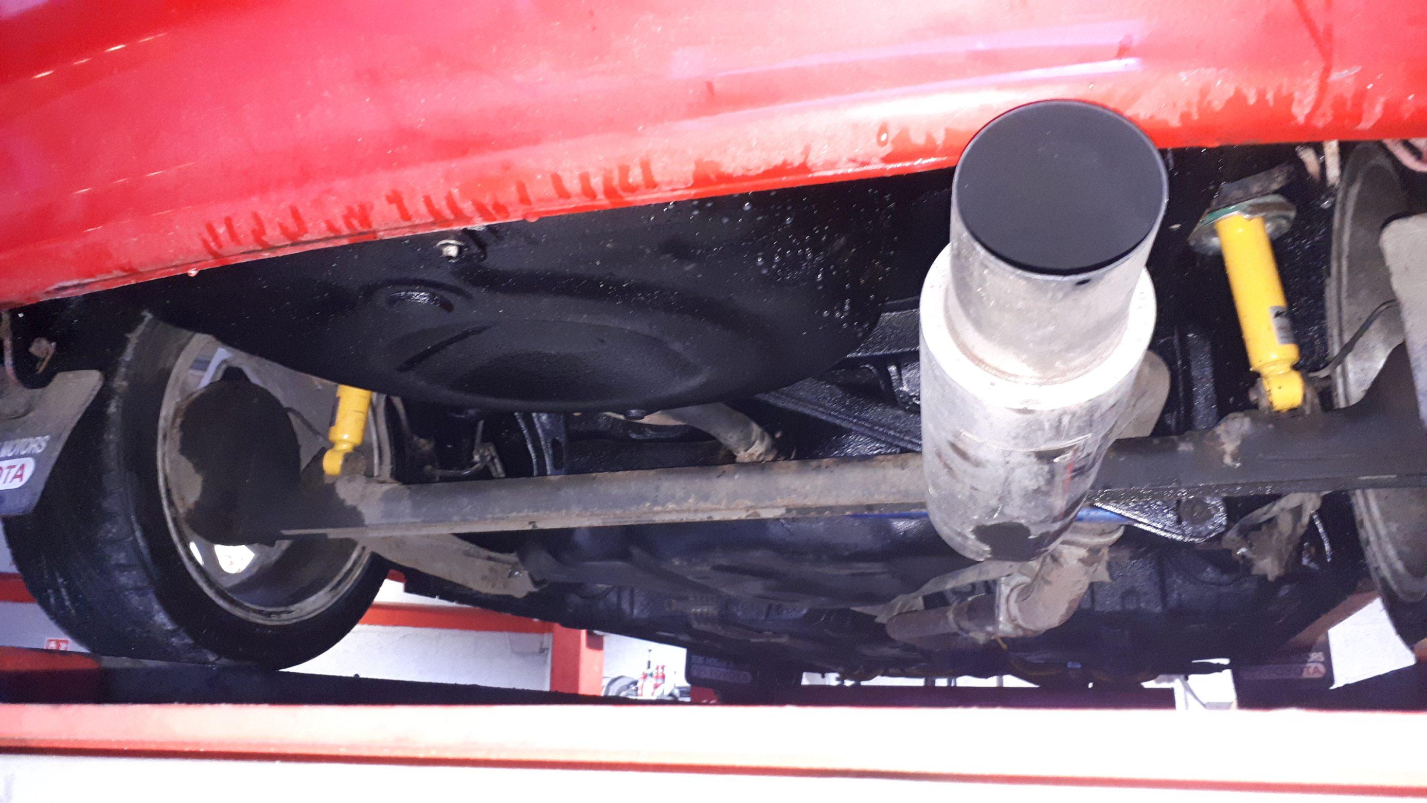

- brand new KONI Yellow Sports Shocks (Rear), KONI PN 8040-1216SPORT - Feb2018 - FITTED Oct2018

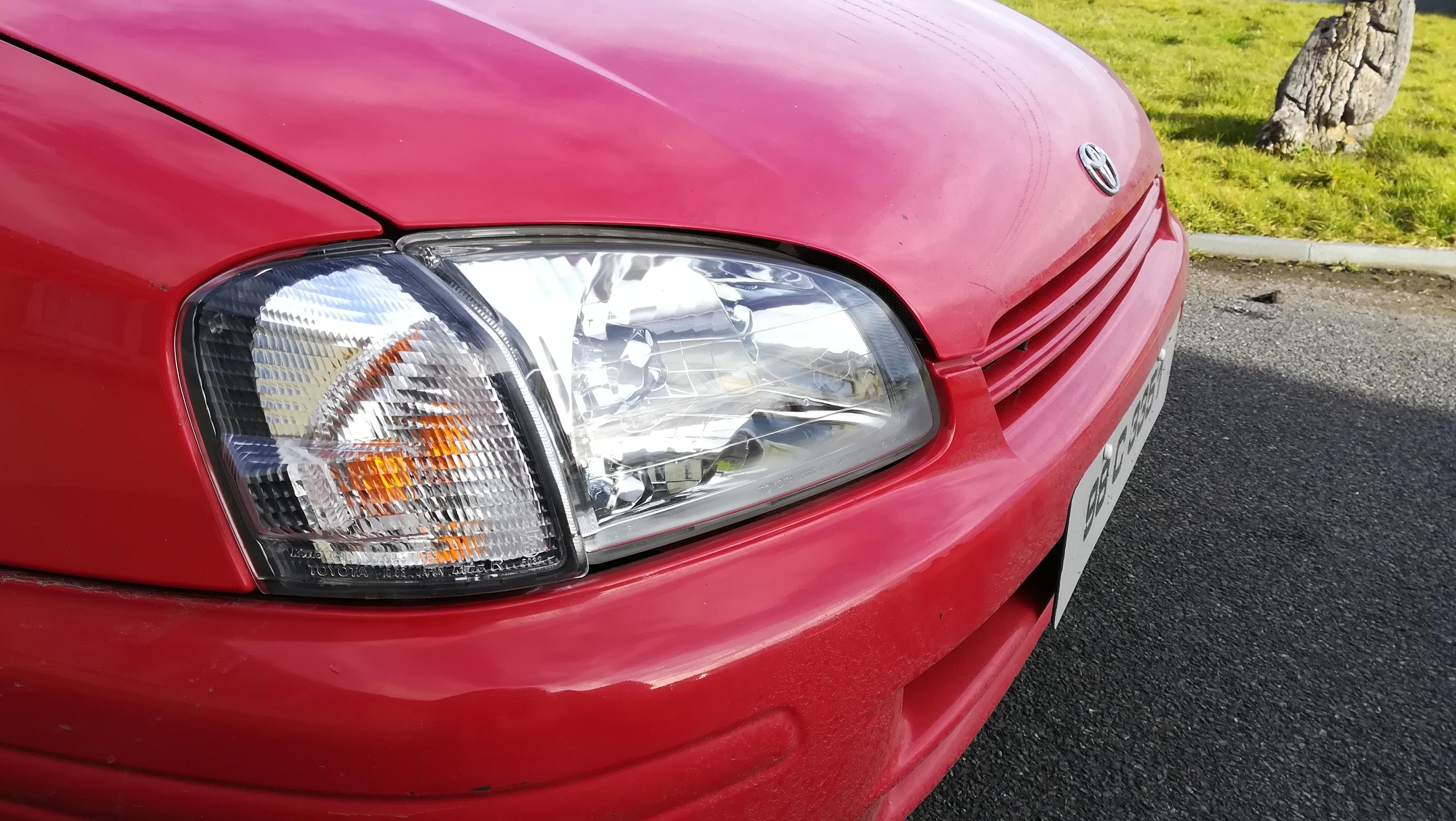

- brand new OEM '98 spec Reflet CRYSTAL HEADLIGHTS [81170-10810(LH) & 81130-10850(RH)] - FITTED Mar2018
Note: Brand new OEM adjustment screws were also purchased from Toyota P/N 81195-10060 x2 and P/N 81195-10040 - FITTED with above
Note: Brand new and revised type Rubber Sockets (Bulb Covers) were also needed for new headlamp clusters: P/N 81139-16770!!! - FITTED Apr2018
(Old type are too loose for new lights... won't fit tight properly!)
- brand new OEM '98 spec Glanza Clear & Chrome Indicator Complete Units [81510-10300, 81520-10280] - FITTED Mar018
Note: bulbs for above indicator units are PY21W opposite pins!
- brand new Silvatec Chrome Bulbs BU581S (PY21W BAU15s fitment opposite pins) - FITTED Apr2018

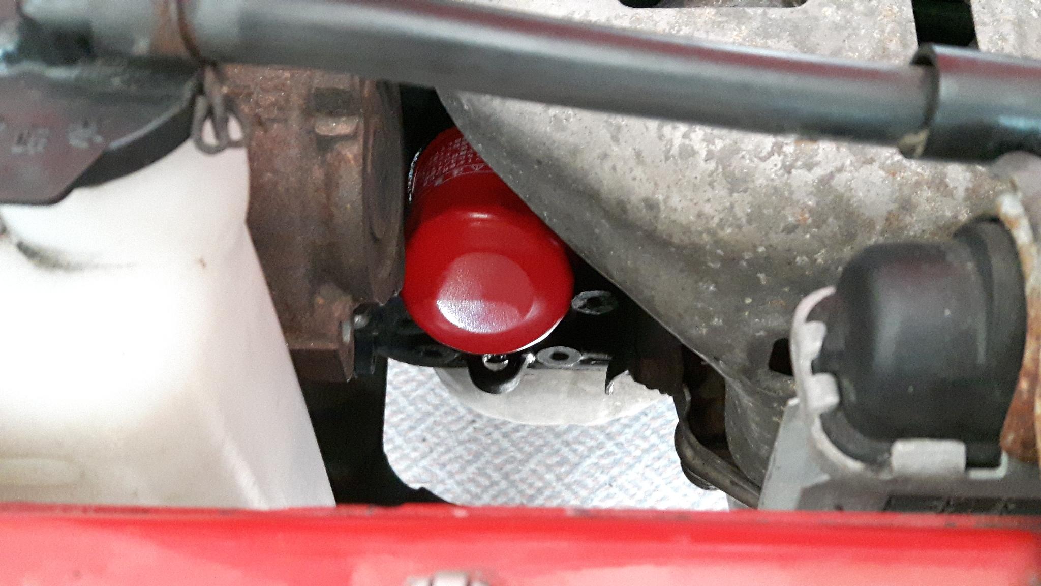

- Millers Oils CFS 10w-40 Nanodrive Competition Full Synthetic Engine Oil - Aug2018 - OIL CHANGED Oct2018 @71600 mls
- Genuine Oil filter (Toyota Part No 90915-10001) - Aug2018 - FITTED WITH ABOVE

- FULL UNDERSEALING (fuel tank removed and fully painted too) with 'bodyline' body schutz sealer - Oct2018
