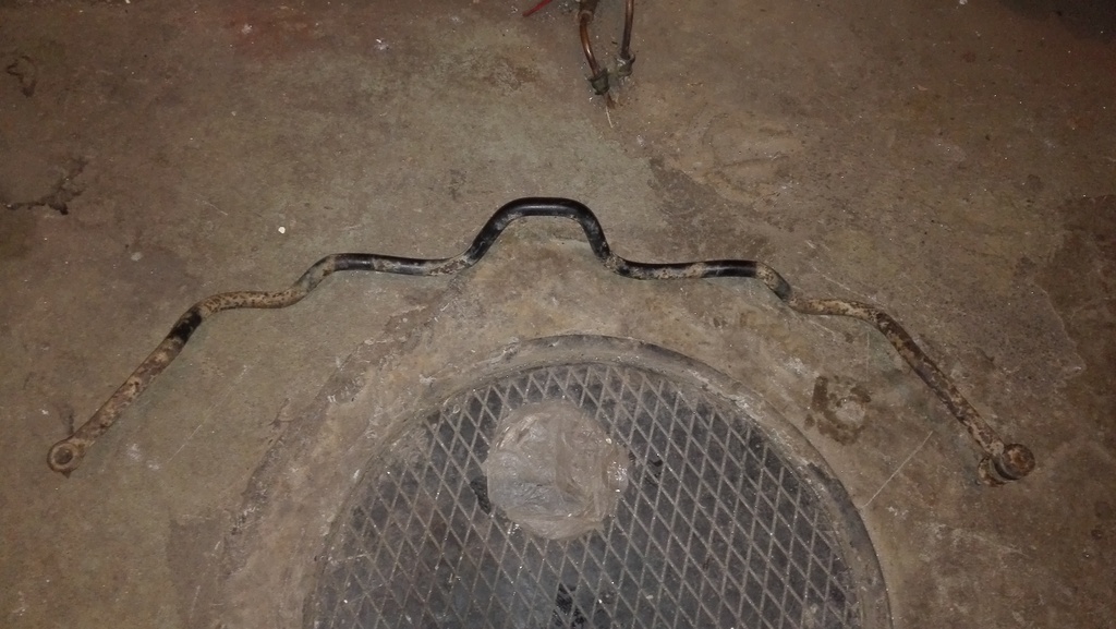

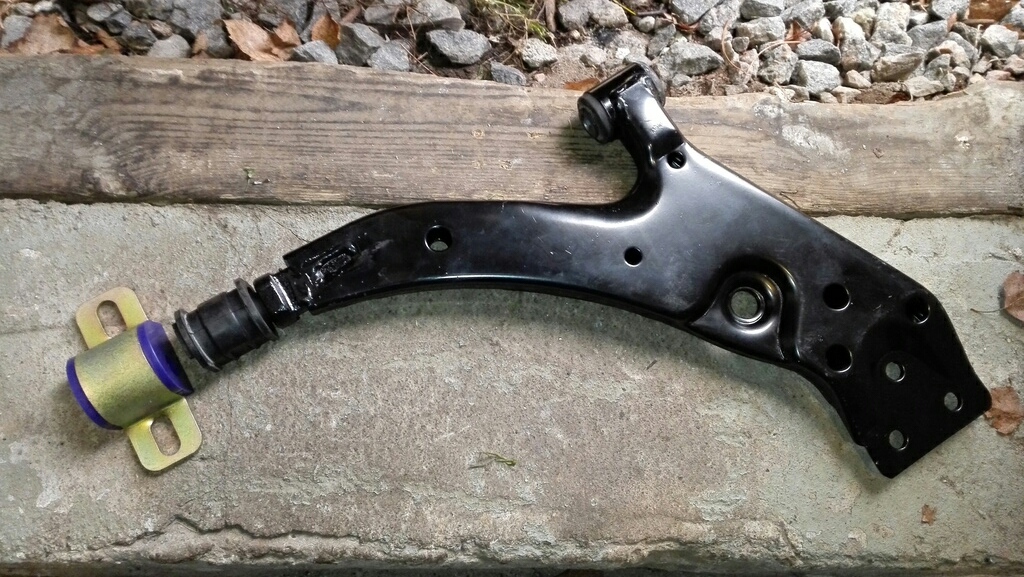

Starlet parts should be almost identical, I have Starlets and Paseo EL54. I have mixed some parts to older EP70 from newer models, so those are also one choice. Droplinks are two version, You have check those visually first, front bushings have also two size, rears are same, and so on...
EP70 arms and EP91 arb pictures for example
