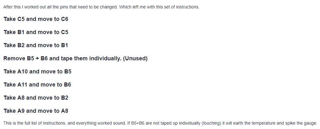

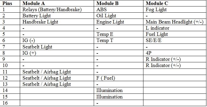

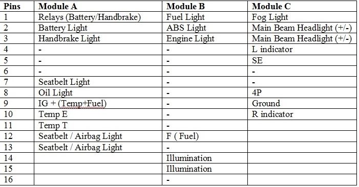

DannyMoville90 Posted December 9, 2017 Posted December 9, 2017 I have received a set of Starlet GLS dials today and I was wondering is this wiring guide from an N/A to an SR the same as wiring GLS clocks into an N/A? http://www.ukstarletowners.com/topic/65688-clock-conversion-starlet-na-to-starlet-sr-cluster/ Quote
westie Posted January 1, 2018 Posted January 1, 2018 Super late reply, but iirc GLS clocks should be a straight swap into a Sportif, no pin changes needed. Quote
SKINY Posted January 1, 2018 Posted January 1, 2018 SR clocks were plug and play in my Rep/98 UK soliel Quote

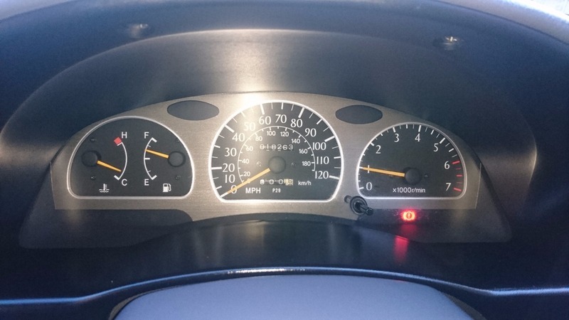

DannyMoville90 Posted May 13, 2018 Author Posted May 13, 2018 (edited) Sorry for late reply, I dont have a tacho wire (the brown one) in my car. I did put the clocks in and everything works but it will not register the rev counter at all. So what do I have to do to get the rev counter to work? My Starlet is 1997 Sportif Edited May 14, 2018 by DannyMoville90 Quote
