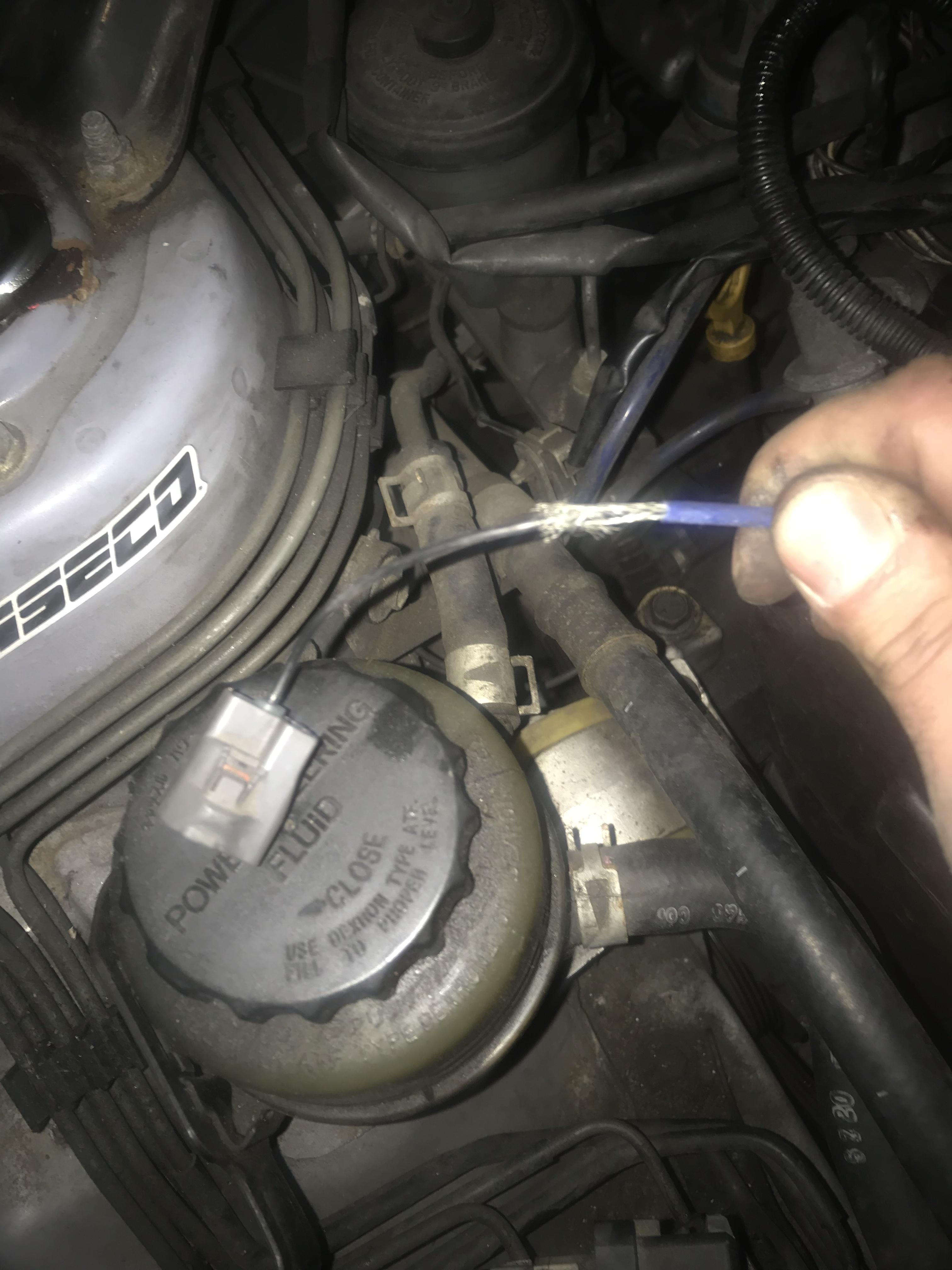

I checked the plug and wiring going to it everything looks fine,
i read a few threads on replacing the shielded wire and grounding it on the engine side, does it matter which side the ground is? Sensor or ecu side?
i took a pic of the shielding does this look normal?
