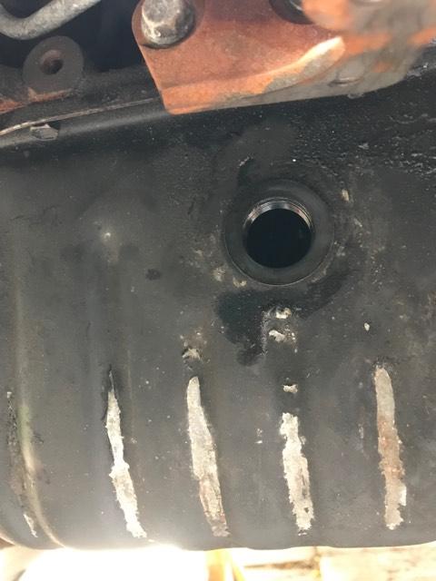

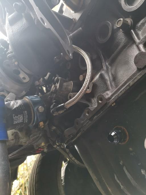

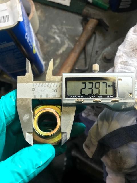

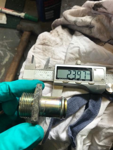

Just thought i'd update anyone else searching for this.. m24 x 1.5 is the thread size. Seal with a copper washer and locitie 577. pictures below
