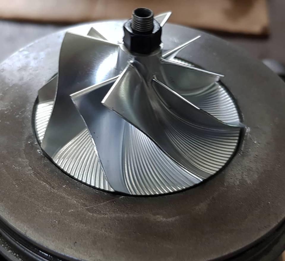

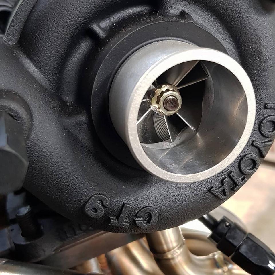

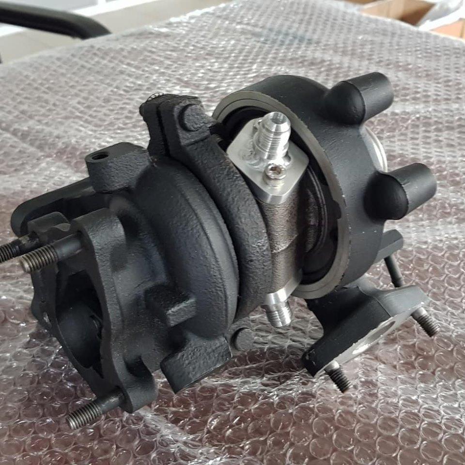

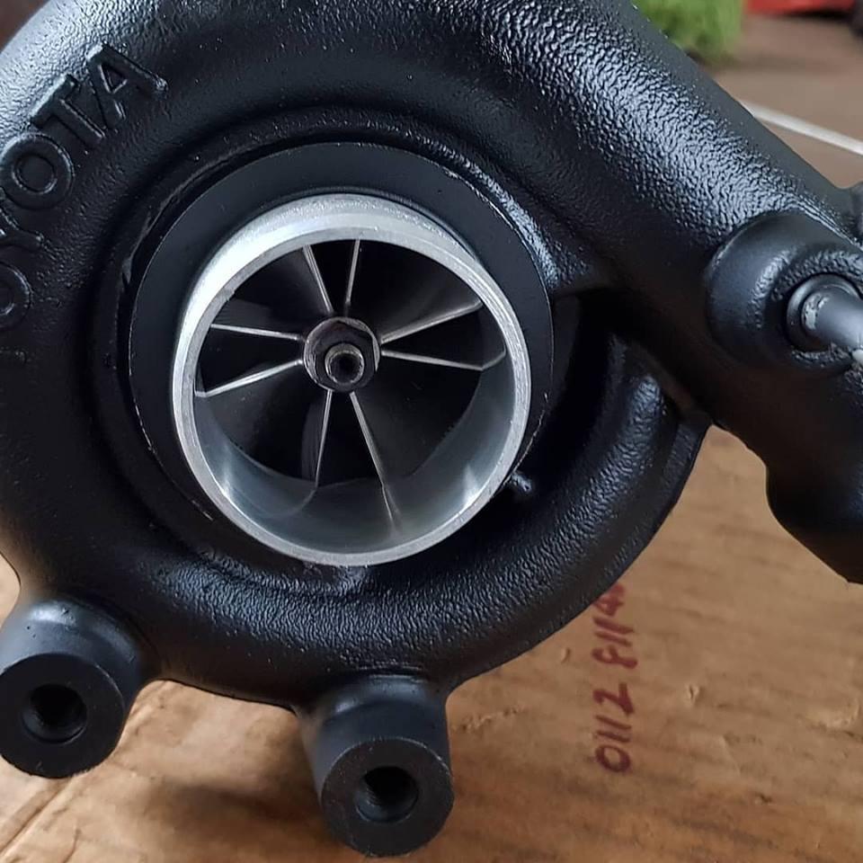

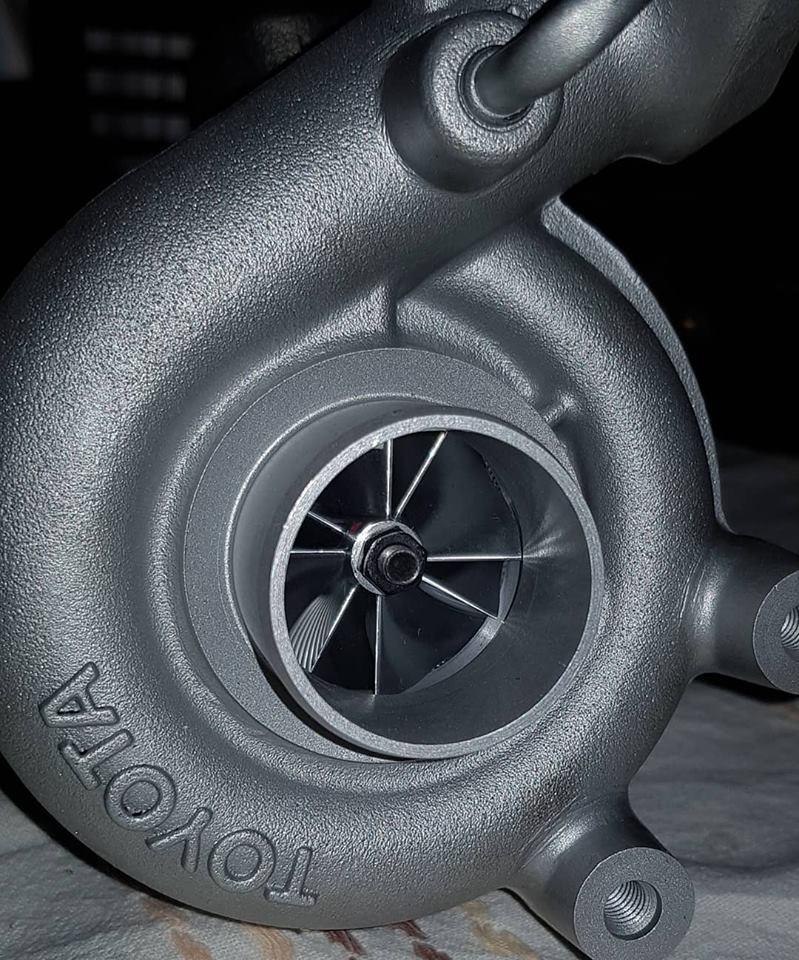

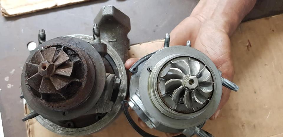

Larger billet wheel... instead of taking an existing wheel and adapting it to fit the turbo (which is what most people do)...we completely redesigned  a new/larger billet wheel to fit our requirement.

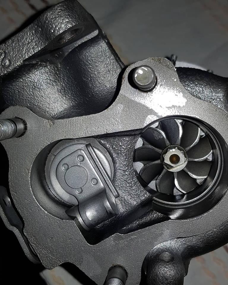

Exhaust side... we have utilized a new wheel to further improve flow
lastly..We improved the internals and oil flow to the CHRA there by improving durability.

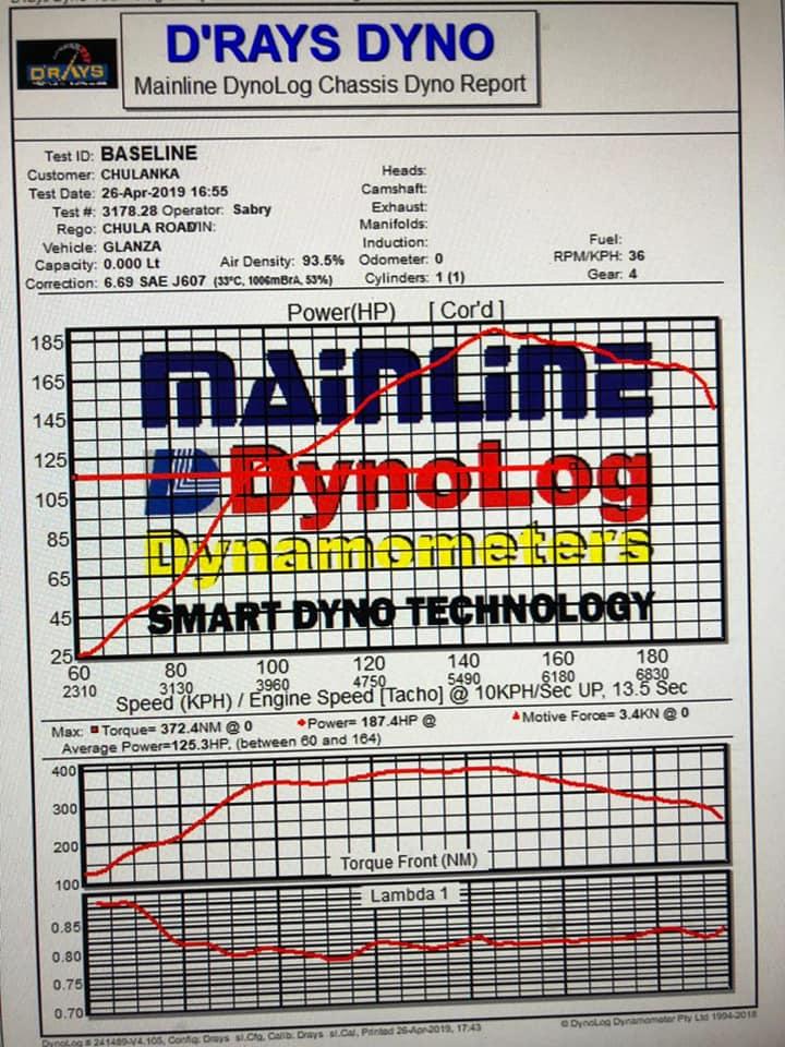

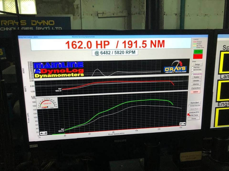

with supporting mods and stock CT9 (max tune)...the car made a respectable 130whp@0.95bar on our heart breaking Mainline Dyno (grey line).

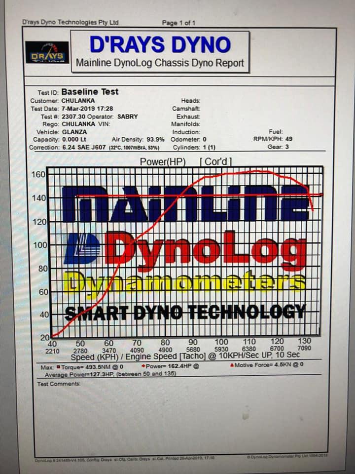

CT9 Hybrid+Moderate tune 1.2bar netted a 162whp .. +32whp gain over max capability of stock CT9.

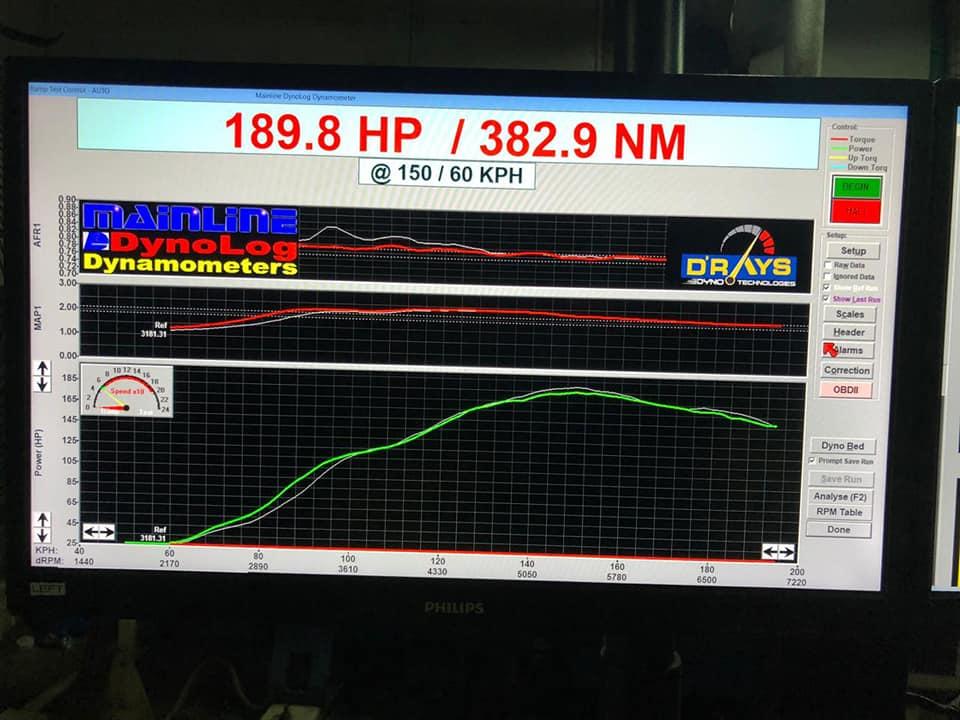

59039612_10156461862827809_1900339659146264576_n.thumb.jpg.c2e8564ff7a943d3e6f724e5602d4bfc.jpg
Next it was time for final tune...
189whp@1.3bar...our hybrid is efficient up to 1.5bar...but we will just leave it as is for now... Almost +60whp gain with no loss in spool.
58379925_10156461861657809_8779278800769777664_n.jpg.bf71f3f1d214d6bc75f4ee86af303c25.jpg58376417_10156461862607809_8847057275941027840_n.thumb.jpg.49820bfb88c54618a788abdeeaee1961.jpg
Pretty Happy with the outcome..you can expect much more horsepower on a DynoJet or DynoDynamics

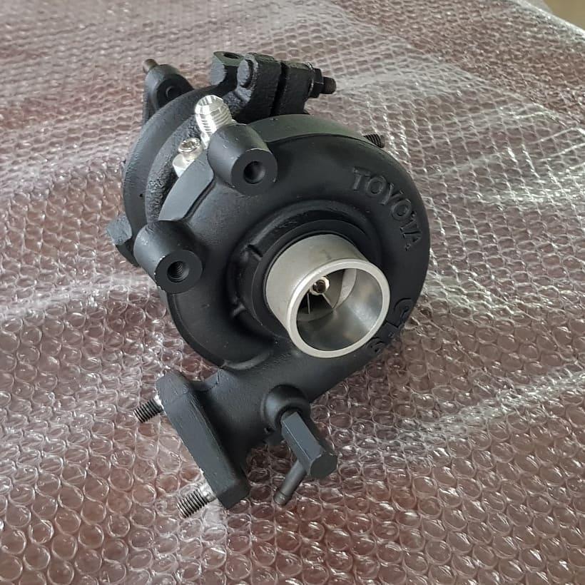

Originally we had no plans of supplying these overseas because they are costly and cores are hard to come by locally. But these are now available for purchase at $1250 shipped (includes core charge). every part has been manufactured in the USA (no Chinese none sense).
