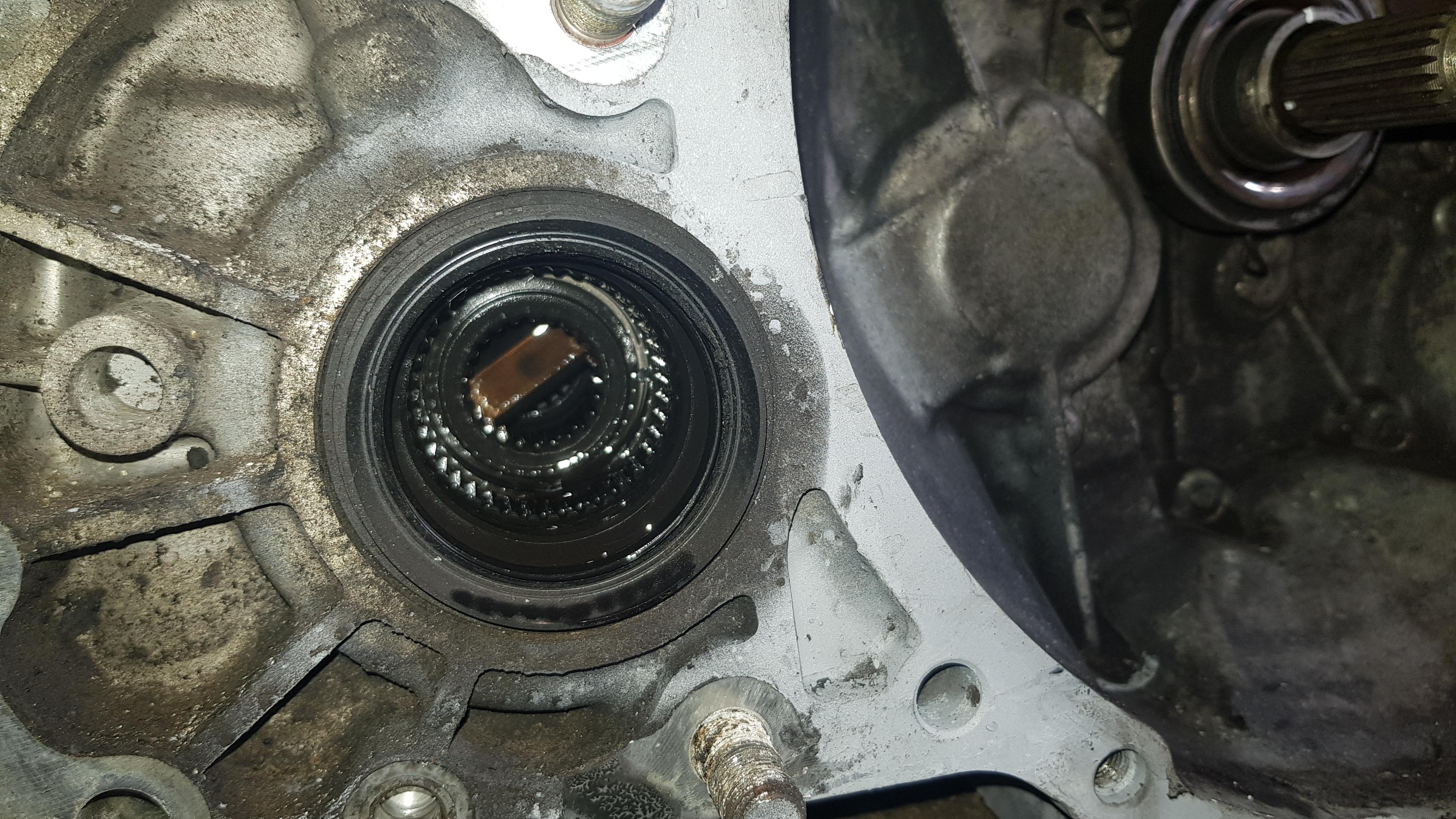

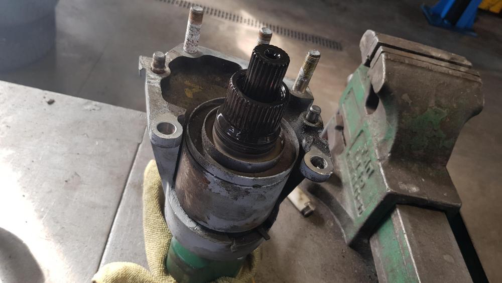

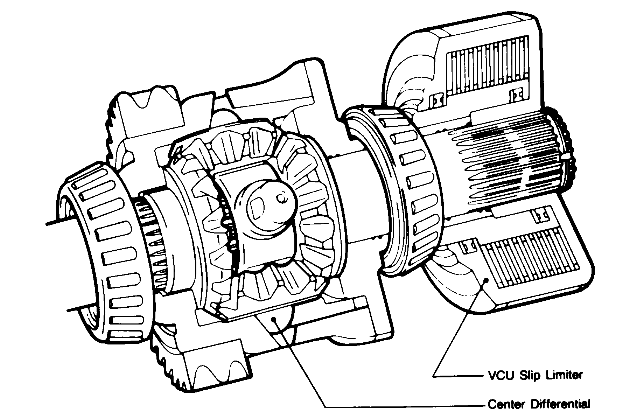

It is viscous lsd

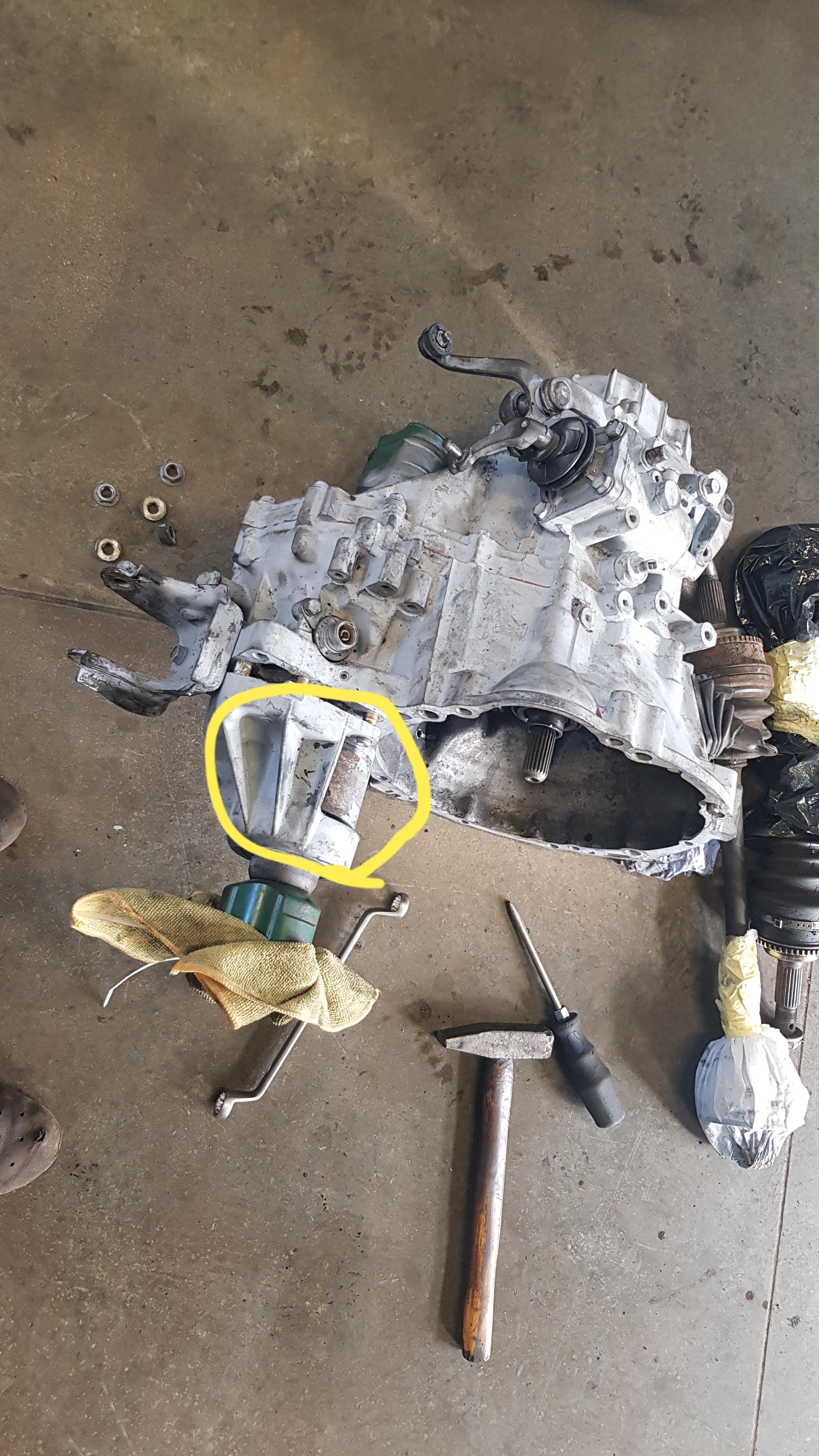

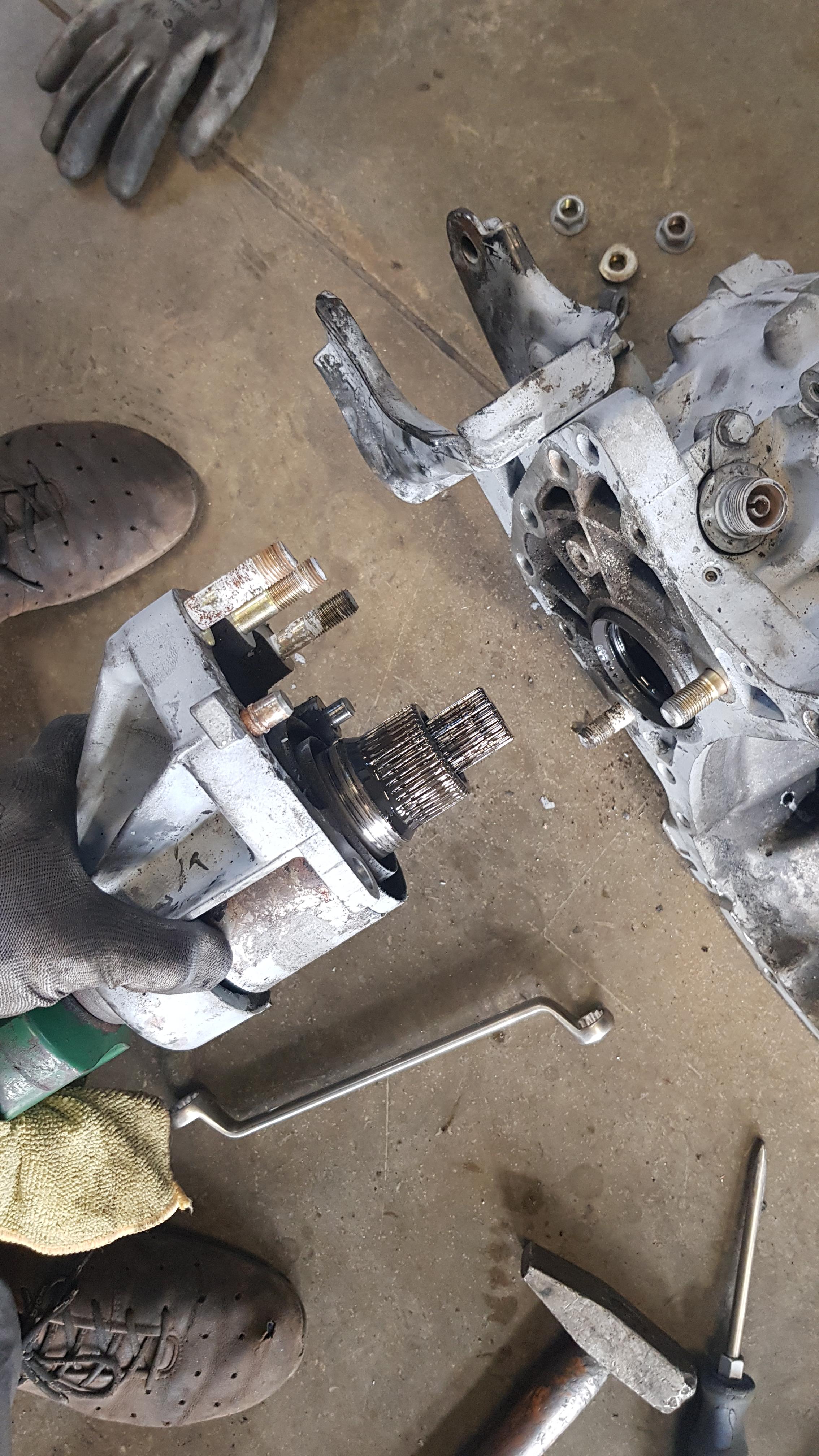

Actual lsd is mounted outside gearbox, that "extention" part. That is why right shaft is shorter than non-lsd one.
This gearbox does not require lsd oil, because viscous lsd is seperate sealed unit with silicone fluid inside.
