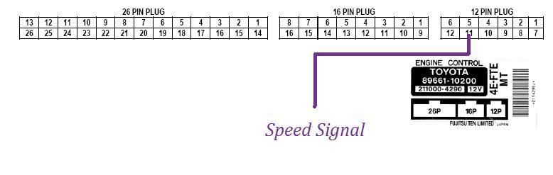

Spoonz Posted June 4, 2008 Posted June 4, 2008 Sup,I got myself a Greddy turbo timer and was wondering where dose the wire go for the speedo on the timer its purpleCheers Quote
RobSR Posted June 4, 2008 Posted June 4, 2008 yup make sure you are looking at the ecu the right way when you count the pins ;) Quote
RobSR Posted June 4, 2008 Posted June 4, 2008 so the one next to the ignition pin?no...hold on ill get a pic up.. Quote
