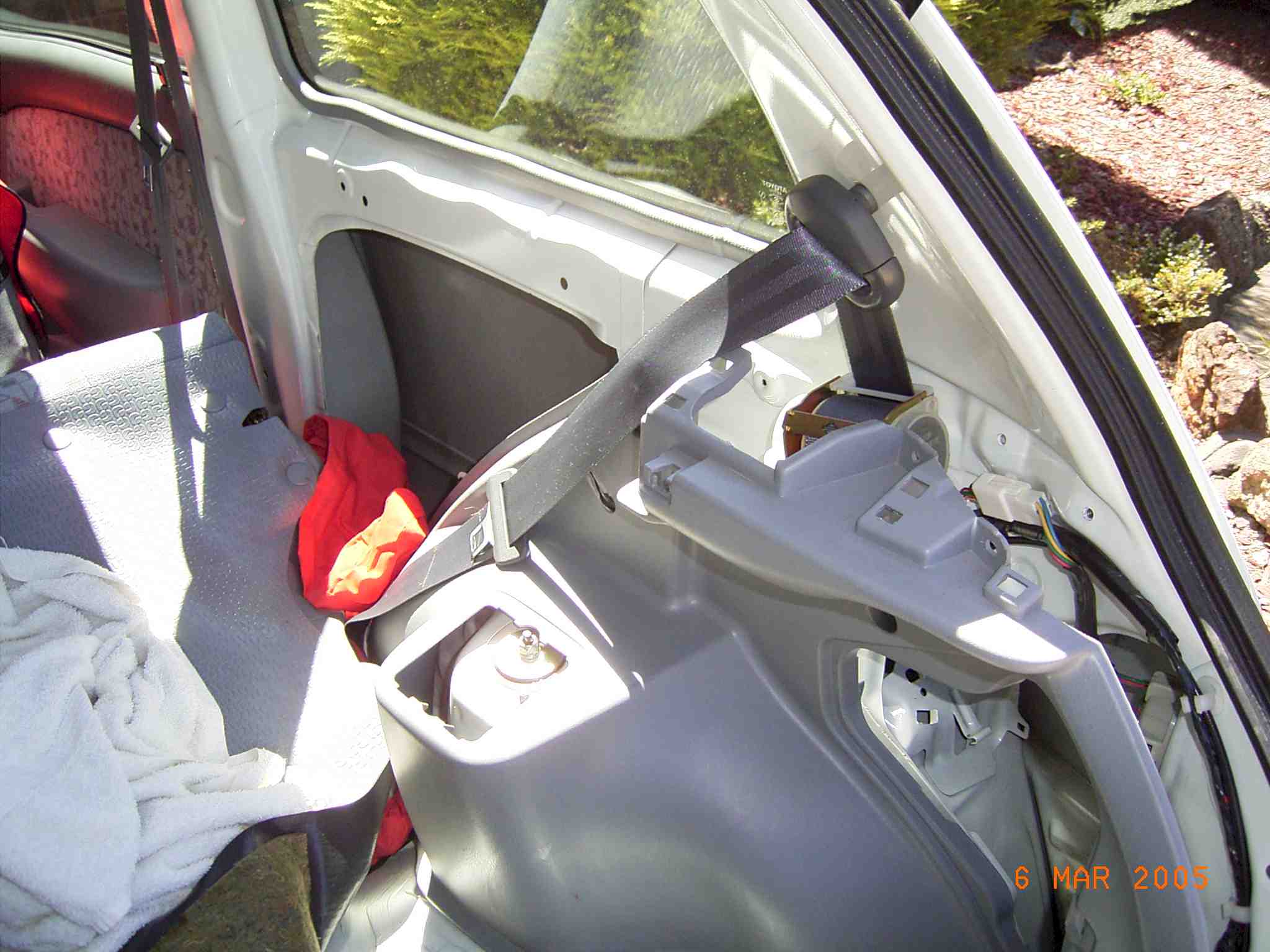

adrenalinmotorsports Posted February 28, 2006 Posted February 28, 2006 heres a photo I took when i did mine. it may help you to see what panels to take out and where the plug is hiding...hopefully see the big hole next to the red back seat cover...thats where the wiring loom is hiding, from memory - hope thats correct its there sumwhere anyways!

adrenalinmotorsports Posted April 4, 2006 Posted April 4, 2006 I've just got some rear speakers myself, doing a bit of googling, and found a post on the australia version of the toyota owners fourm that claims if the car didn't come with rear speakers, then the cable won't be there,.....Does anybody know if this is the truth or not?I'm with Joz, removing the step-in panel doesn't reveal any screws, it needs to removed anyway as it clips onto the rear passenger panel, is it a case of undo screws at rear and pivot it out? has anybody else tried to remove this panel?<{POST_SNAPBACK}>nope, my starlet didnt come with rear speakers, and the loom was there. im pretty sure that all models would have it.I posted that info ages after i had done it myself, so some of the steps could be a bit off, sorry my bad! but generally they should give you a bit of an idea of how to get to the loom....hopefully cheers,Craig
