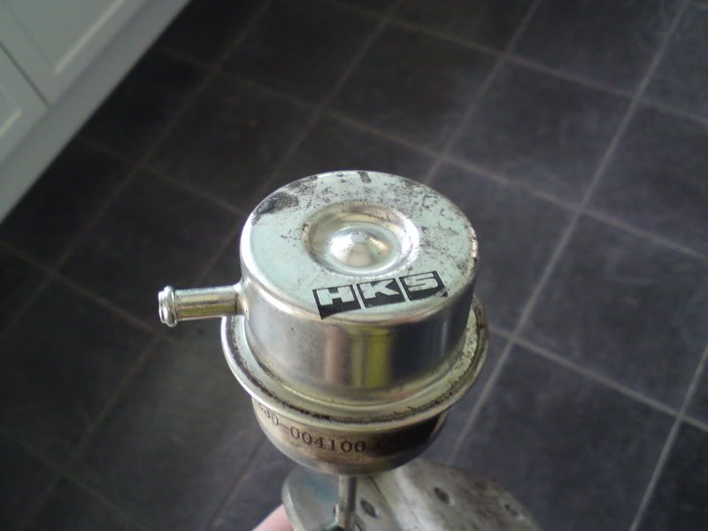

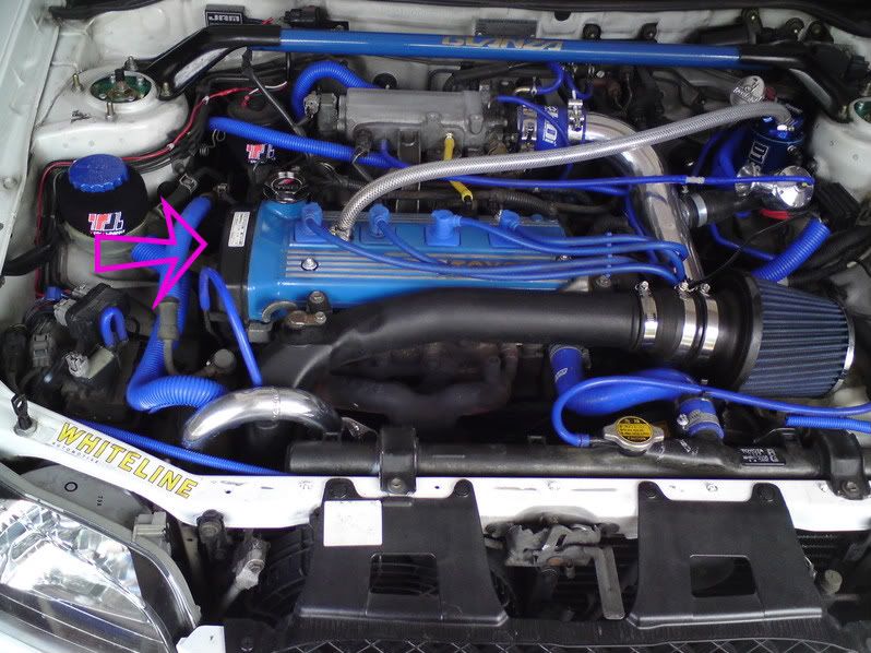

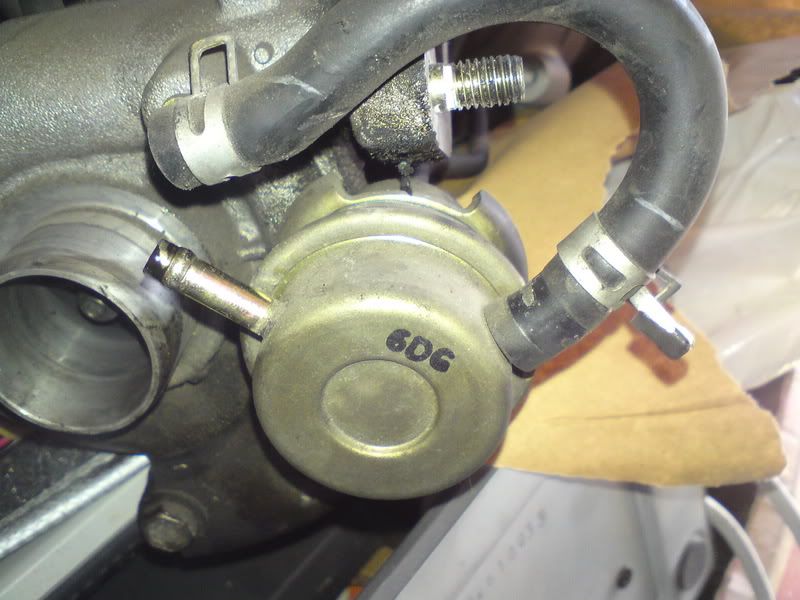

Glanza Al Posted July 20, 2008 Posted July 20, 2008 Hi chaps, thought Id paint the plastic pulley cover on the side of the engine, I know its fixed with 4 bolts, but after removing them, it still wont budge ;), cany anyone point me in the right direction?Also, another thing is confuzzling me, the standard actuator has 2 terminals, one going to the turbo, and the other going to the thin metal pipe into the engine. Whereas the new HKS one only has one :s, which pipes do I need/not need and what can I remove?Any help is greatly appreciated ;)Alex. Quote
WallaceGlanza Posted July 20, 2008 Posted July 20, 2008 I think you need to take off the bottom pulley cover to get the top one of too, not 100% sure though.With the actuator you should have a t piece with the kit which you use to connect up all the original vaccum lines, or if you have a boost controller you just have two lines coming from it, one goes to the nipple on the turbo and the other to the actuator port. Quote
