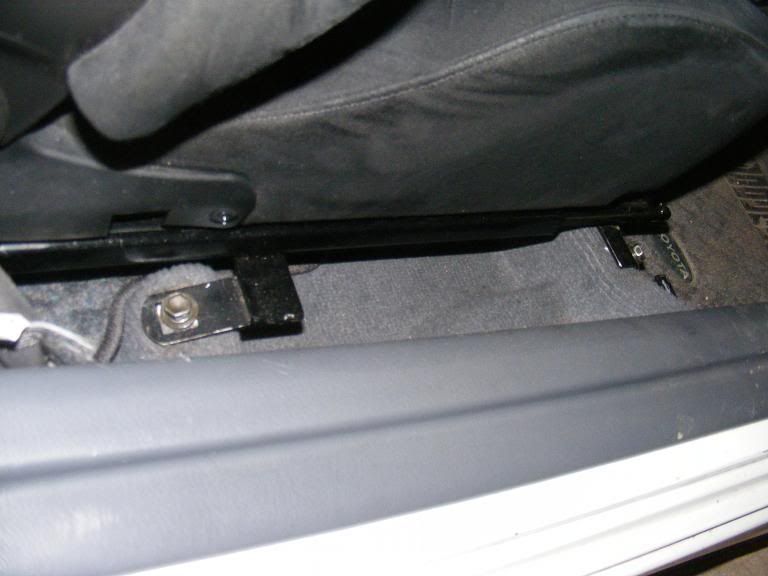

shelly_star Posted March 9, 2009 Posted March 9, 2009 Ok guys, i got a set of standard glanza seats rails right to modify to fit the recaro seats, manage to get one in.... BUT...... they are sitting way too high, so any suggestions peeps?Has anyone had this sorta problem too when doing so?because no way i want to drive sitting higher than the standard seats HELP!Shelly Quote

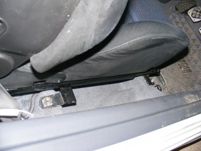

shelly_star Posted March 9, 2009 Author Posted March 9, 2009 This is how it looksThis is how high it is compare to the passenger side Quote
Bildo Posted March 9, 2009 Posted March 9, 2009 Hi Shelly, the main problem seems to be the part where the subframe mounts on the car, they raise it up quite a lot. I have some aftermarket subframes on my Recaro's, I got a couple of pics of them for you. As you can see the part I'm talking about is flat, where yours are raised. If you can get them a bit flatter the seat should move down. Hope it helps in some way! Quote

shelly_star Posted March 10, 2009 Author Posted March 10, 2009 Cheers for the help guys, am trying to fink round this again, my uncle suggested getting some recaro frames off a ford cossie and mod those in if Recaros fit all recaro seat rails, but i doubt they do right???Geo, i feel as though iam 6ft tall driving my car now LOL no joke, yep i find it better to drive if i sit lower to the ground Quote
mattgtt Posted May 10, 2009 Posted May 10, 2009 well i have just fitted 2 recaro fishnets and this is the best way i have found! i got these uni runners off ebayhttp://cgi.ebay.co.uk/UNIVERSAL-SUBFRAMES-...1742.m153.l1262they required 1 extra hole drilled then bolted straight to seat and welded some feet to them and bolted them in they sit very nice and low perfect for me and im quite a wee lad! and are fully adjustable! hope this helps!! matt Quote
