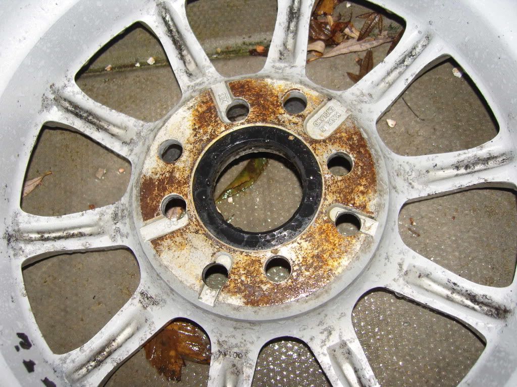

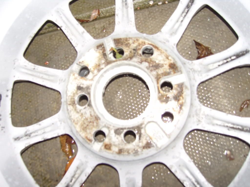

anup67 Posted November 29, 2009 Posted November 29, 2009 i bought these alloys, but one of them have this rubber thing in the inside of the wheel, but the other 3 dont. I dont know what it is, would i need this when i fit my alloys??rubber thing...no rubber thingHELPP PLEASE!Thanks Anup Quote
Idrees Posted November 29, 2009 Posted November 29, 2009 That's a spigot ring mate, what wheels are they?The reason its there is because the centre bore of the wheel was too big for the car the wheels came off. The ring fills the gap in the centre, and makes it safer. You need to measure the centre bore and then we can tell you if you need spigot rings for these wheels to fit your Starlet. Quote
anup67 Posted November 29, 2009 Author Posted November 29, 2009 That's a spigot ring mate, what wheels are they?think they are team dynamics diablos got them off starletrick 4 cheap what do these 'spigot rings do?? and do i need them?ThanksAnup Quote

Idrees Posted November 29, 2009 Posted November 29, 2009 Yes mate you need them. Measure the ring and buy the rest of them. Rick had them on his Glanza so I'm assuming the black ring fitted well on his Glanza, you can probably pick up a set off ebay. Quote
