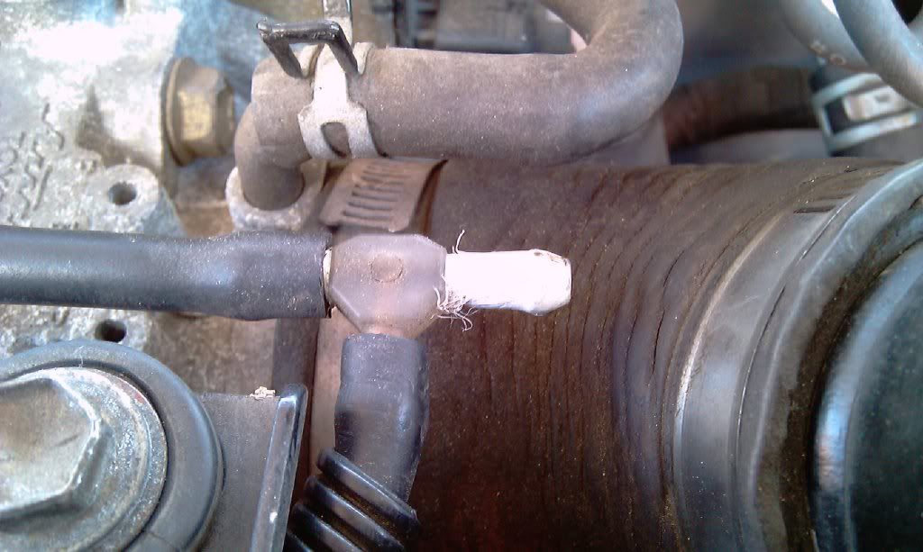

Josh@TunerLifestyle Posted May 22, 2010 Posted May 22, 2010 hey guys i have a problem with my glanza still, there is no boost! I've checked all the pipes and they are nice and tight with no splits or cracks , my exhaust is fixed so no longer blowing aswell. however i have noticed there is a pipe off the inlet with a T junction on it, and 1 of the ends is open. when the engine is running you can put your finger on the end of the pipe and it sucks in, is this ment to go somewhere? here is a picture jus to see if you know what im on about.random pipehope i can get my boost sorted cheers josh Quote
Steve GT Posted May 22, 2010 Posted May 22, 2010 thats your problem then mate. that pipe should run from your inlet to the actuator. im guessing the t-piece was used to pipe a boost gauge in with. take the t-piece off and join the 2 pipes together that are on it and it should be finethats pretty much your problem mate your boost will be just pissing out that hole and that isnt good for your turbo Quote
Josh@TunerLifestyle Posted May 22, 2010 Author Posted May 22, 2010 glad i spotted it! been driving it for a month like that so lets hope thers not any serios damage =S il go do it now cheers mateyour a starlet saver! (y) Quote
Josh@TunerLifestyle Posted May 22, 2010 Author Posted May 22, 2010 and i just want to add, i do have a boost gauge still? so dose that mean the pipe from the inlet to the acturator is missing?cheers josh Quote
Steve GT Posted May 22, 2010 Posted May 22, 2010 haha doctor starbo happy to help haha. think you'd be better off buying a 2 piece pipe connector and joining them like that or buy a longer bit of pipe to join them. you might be lucky and the pipe on it may be long enough but dont stretch it too far or kinj the pipe etc wants to be as straight and smooth as possible. kinks mean trapped boost and you dont want that Quote
Steve GT Posted May 22, 2010 Posted May 22, 2010 and i just want to add, i do have a boost gauge still? so dose that mean the pipe from the inlet to the acturator is missing?cheers joshdoes your boost gauge work? if so there wants to be 3 pipes. one going from the t-piece to the actuator, 1 going from the t-piece to the boost gauge inside your car and one going from the t-piece to the front of the inlet manifold Quote
Josh@TunerLifestyle Posted May 22, 2010 Author Posted May 22, 2010 1 goes inside the car and the other one is on the inlet, i just had a look at the acturator and i cant see any pipes free? looks like im not out of the mist just yet!and yeh the guage dose work Quote
