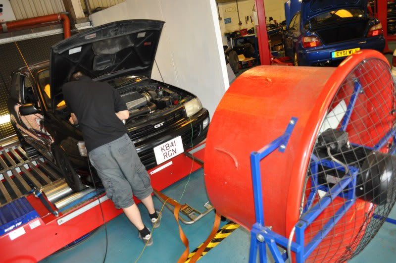

So ive had my ep82 on the road for a few months now and ive been wanting to know how and what its running.

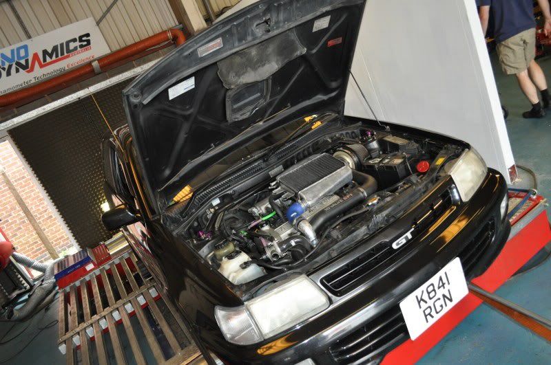

Current engine mods;
race tech mani
zisco screamer
japspeed cat-back
stock ct9
hks actuator
blitz sus
sytec fuel pump
greddy type-s
RX-7 tmic
Never been re-built and is at around 100k miles.

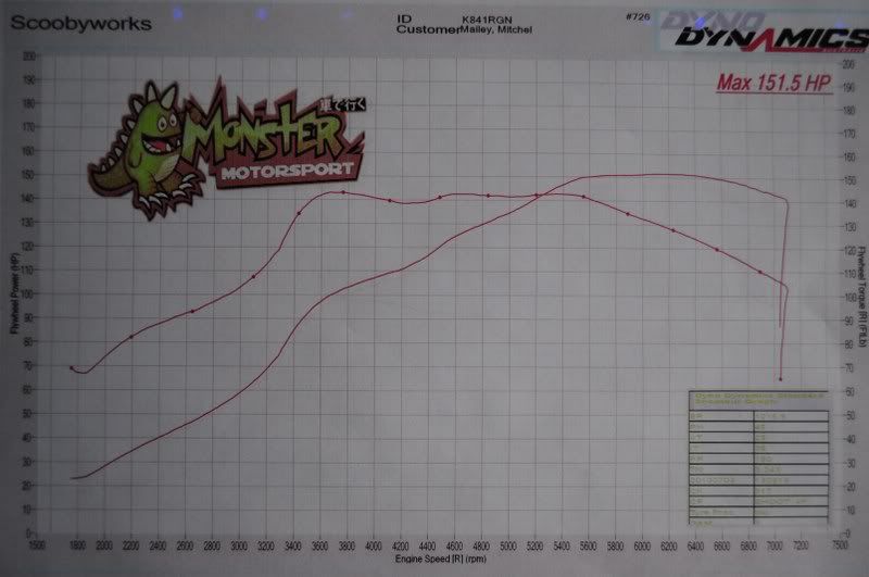

Running just over stock boost. 0.77bar or somthing
Little more smoke produced than i had hoped but compression tests indicate that the rings are ok and i now think its obvious the lil ct9 is dying. I may of gotten a little on Mike nerves 'whats the smoke why why is it bad oh god its bad is it normal thats not normal'
Either way, big thanks to Mike at Monster Motorsport. Im a very critical and obsessive person when it comes to people touching my car but Mike and all the other guys at Monster Motorsport take the greatest of care and allow you as the customer to chill out and have peace at mind.
Over all im pleased with the power it produced and the way in which it ran, fueling was good. Not bad for a 17 year old 100k+ engine.

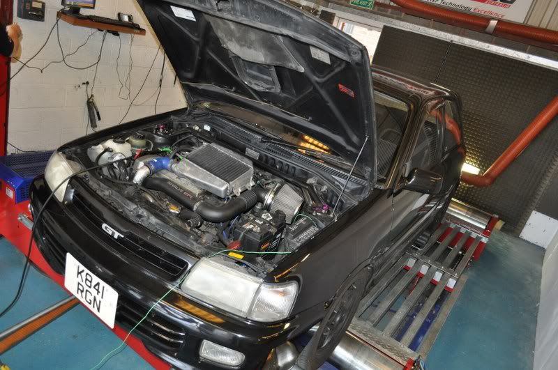

I do believe i can squeeze more power out of the 4e with the said boost. Tmic needs getting rid of, new HT leads also as they appear to be quite old and shagged, fresh oil/filter/plugs, front mounted filter. Ive also got a Mines ecu to fit which should hopefully fuel it ok and see some nice gains.
Thanks for looking.
