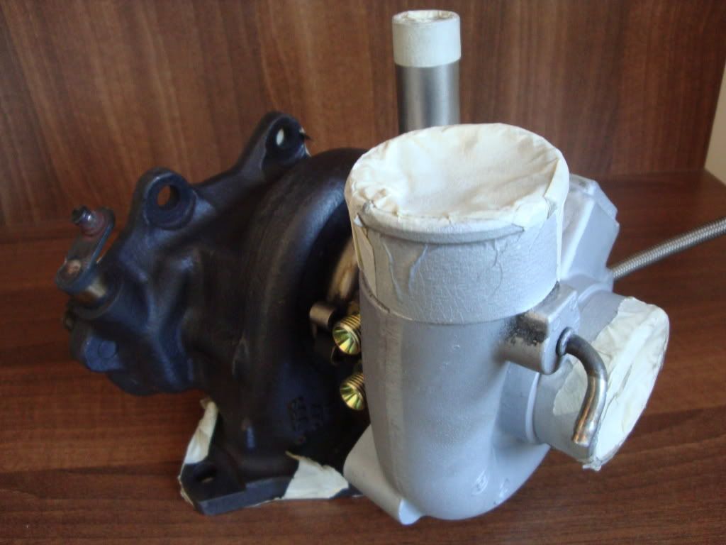

iamlegend Posted October 23, 2010 Posted October 23, 2010 heyjust bought this race tech turbo recon from a member,i noticed it is missing these two parts ??? oil and water return clips??where can i purchase this from? 2 gold bits...circeld in pinkheres the tuby i got any thing else? Quote

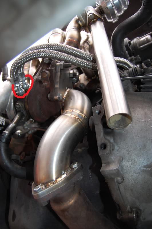

Sparky Posted October 23, 2010 Posted October 23, 2010 They are the water feeds. Not necessary on the TD04 but they would probably come with the braided lines if you ask Ricky?You will need the oil drain and return too, i'll see if I got a pic of mine now.EDIT- You can see my old drain with samco which goes to the sump, and the feed which is the braided line close to it. Quote
DannyGlanzav Posted October 23, 2010 Posted October 23, 2010 You can get an oil return pipe off Ricky, you will also need a gasket for it and oil feed banjo bolt Quote

Idrees Posted October 23, 2010 Posted October 23, 2010 Ricky didn't include those gold bits when I bought the turbo from him. He gave me a cheaper style of braided line fitment for some reason, where they attach to the turbo with banjo bolts. You won't need the gold bits if you get the same style of braided pipes that I did. You'll also need an oil return flange/pipe, that's it. Also yes the turbo is rotated to suit my manifold setup, if it needs rotating more you can do it very easily by opening the clip that holds the inlet housing. Quote
