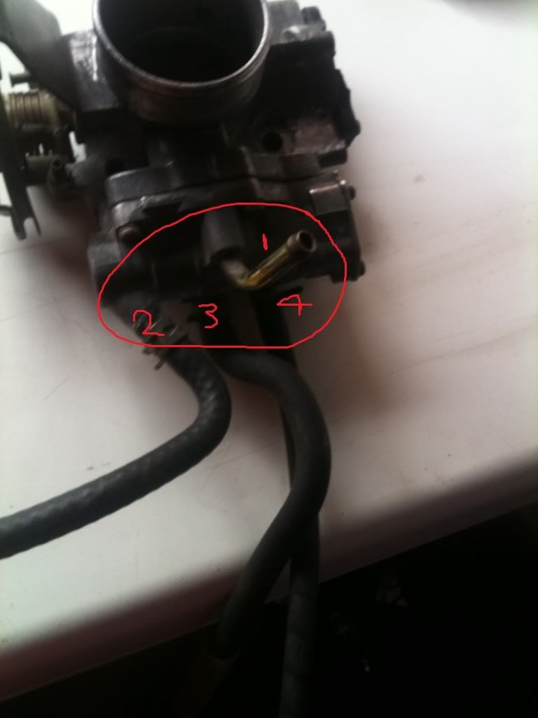

the 4 pipes circled in red we dont know what to do with them as the n/a one only has 2. thats the first inquiry.

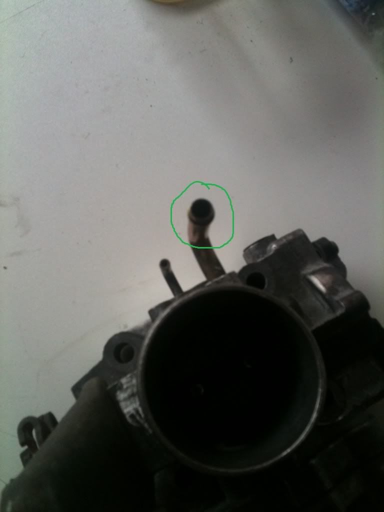

the second inquiry is this nice pipe sticking out that isnt there on the n/a one. what do we do with this?

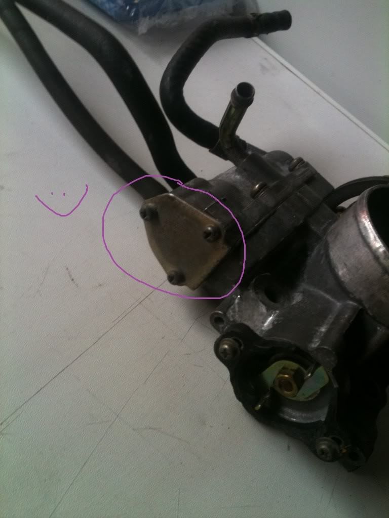

the thrid inquiry is the blanked off bit circled purple. where this is on the n/a one i have a sensor how do i go about it lol.

the N/A should have 4 pipes at the bottom not 2 check again
the pipe can be blocked off
not sure about the sensor tho
ah yes my mate missed the blanked off one hidden behind. thank you :)
anyone else know about the blocked off sensor etc?

Well it should all fit on with the 4EFTE inlet mani but the TPS is missing off the 4EFTE TB and as far as I am aware this would of been 4 pin anyway and the 4EFE loom plug is 3 pin. Is there any way that a 3 plug TPS can be fitted or modded onto the TB. I still have the N/A one but it doesn't fit obviously.
