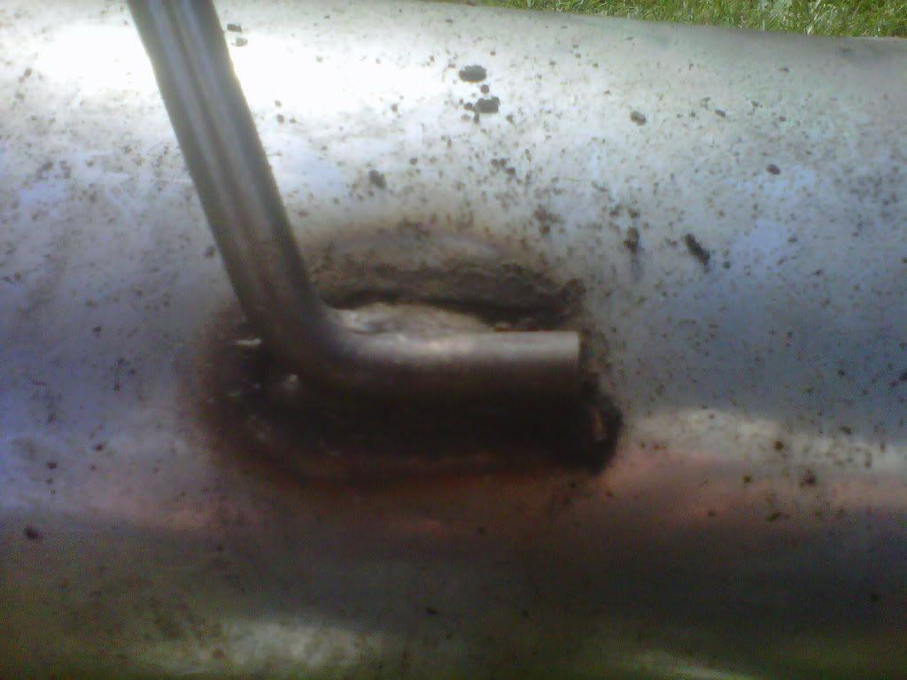

Basically its still secure just a crack near the hanger and theres a little bit of movement...
Now the cracks literally only on the top bit, the rest is just dirt :)
Been told by someone that this cant be dont but cant see why not :s what you guys think?
haha who told you that rubbish.
it looks like stainless bar welded to stainless can with mild steel mig. thats the most amateur weld there is if it can't be replicated i'm a monkeys uncle lol.
i'd just clean it up and go over it with Tig and stainless rod
