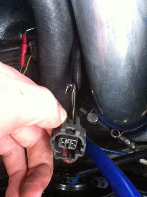

Jamie1st Posted January 31, 2012 Posted January 31, 2012 Looks like it to me bud, unless that's near your clutch arm on the box and it isn't used (Well mine isn't). Quote
Nads Posted January 31, 2012 Author Posted January 31, 2012 what you use to connect your rad up jamie ? Quote
Nads Posted January 31, 2012 Author Posted January 31, 2012 I see in your pic you have a civic rad, you useing a slim line rad fan? wondering how you connected up urs mate? Quote
Flaminsam Posted January 31, 2012 Posted January 31, 2012 if i can remember thats for the cat overheating sensor? when you fit a decat they are no longer required. its originally fitted to the lower of the two sensors on the standard cat? some one please tell me if im wrong........ Quote
Jamie1st Posted February 1, 2012 Posted February 1, 2012 I see in your pic you have a civic rad, you useing a slim line rad fan? wondering how you connected up urs mate?At the front near where the Civic rad sits, there should be a plug that looks identical to the one you pictured. Get 2 small flat electrical connectors, put them on the fan cables and shove each one into the correct point in the plug (+ to + / - to -)This is the electrical connectors that will push straight into the plug (You'll need 2, and they might need a slight trim)/>http://www.ouros.co.uk/image/dproducts/econnect/4.jpgIf this makes no sense ill grab a picture when I'm next up with the carJamie Quote
