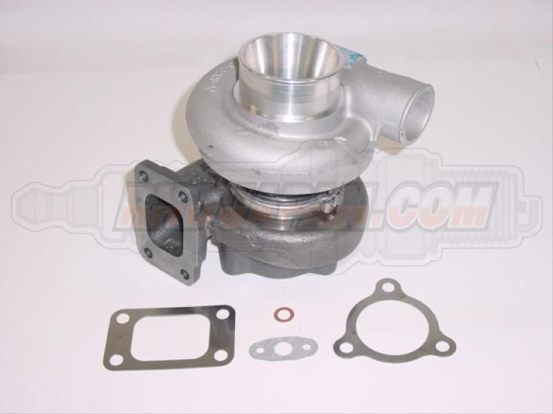

need to get a manifold made up for this turbo, and was asked wether the greddy td05 flange is the same as the other tdo5's because sometimes they differ
had a look on rhdjapan's site and the one they have advertised looks like this -
others seem to have the angled 3 stud fitment!
what would i be getting? im confused!!
Depends on the turbo mate, my current IHI TD05 is the same as above but my old Mitsubishi TD05 was 3 bolt, same as most TD04 turbos.
