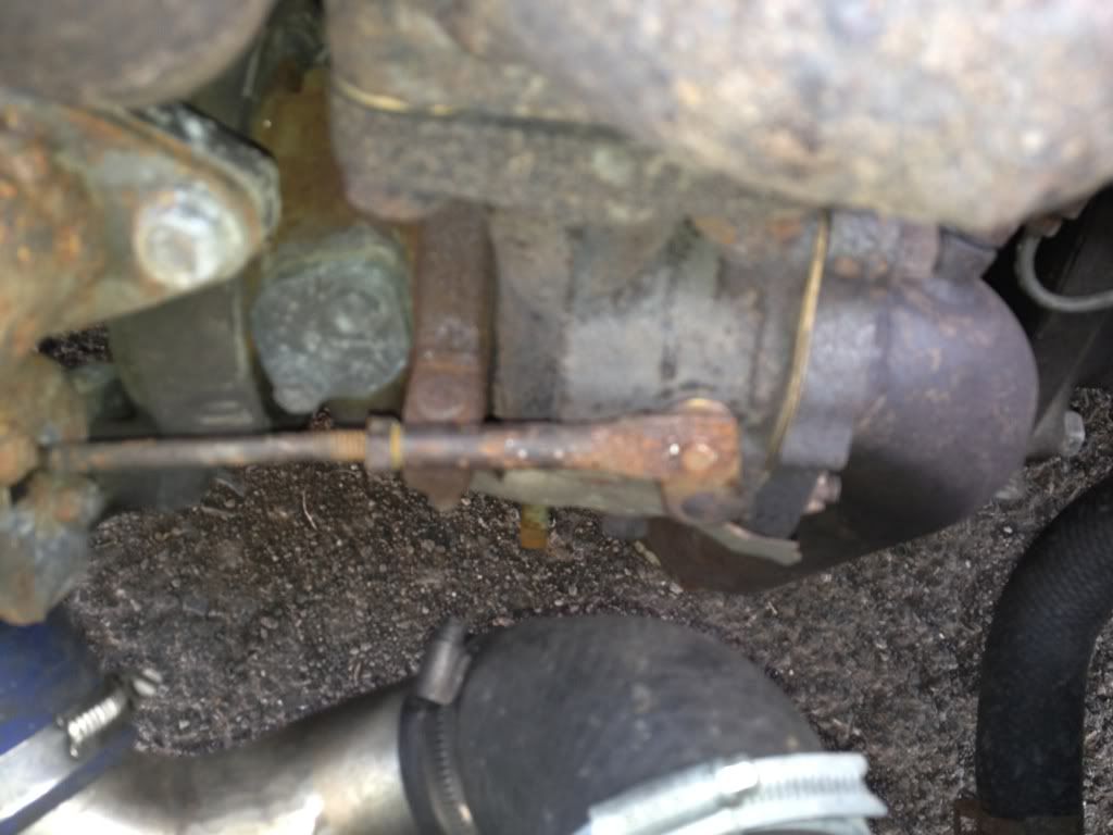

Hawwy Posted April 21, 2012 Posted April 21, 2012 HiMy boost was 0.8 barI have turned actuater making less threa show and its still showing 0.8? And here a pic of when i put it backIs it proper where it clipped on to the hook thing or do i have to make that hook thing on the right its at top at the moment if that makes senseCheers Quote
starletburkie Posted April 21, 2012 Posted April 21, 2012 lenghten for more boost shorten for less boost Quote
