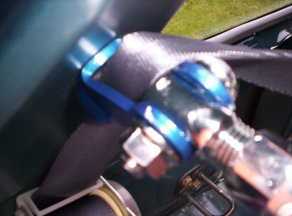

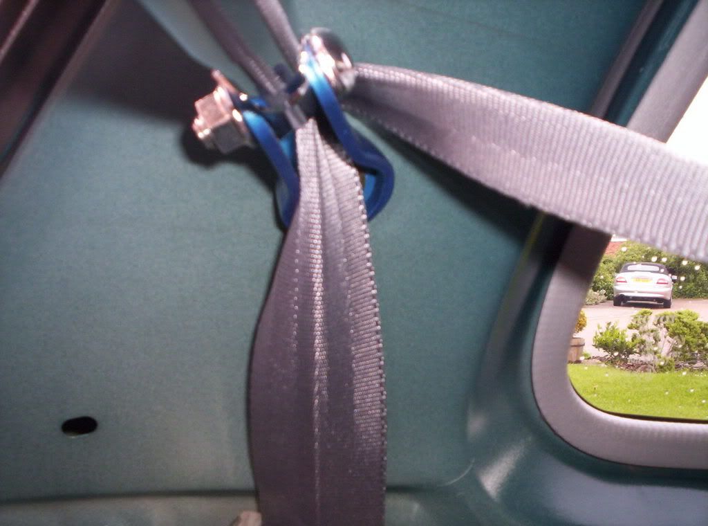

keirz Posted May 28, 2007 Posted May 28, 2007 god damn it idress!!!!!!!!!!!!!!!!!!!!!!!!!!!!!!!!!!!!!!!!!!!! i told you joz has the mr chu one!!!!!!!!!!!. the mounting points are different mate. have you got it now. different mounting points and again for good luck........ DIFFERENT MOUNTING POINTS. ;) ;) i have the zep brace mate. i have not attached the plastic holders but have ran the belt through the mounting points on the brace. i will get a pic if you dont get what i mean dude. just give me a shout. Quote
keirz Posted May 28, 2007 Posted May 28, 2007 i sure did. the ones on the mr chu ones are flat and so fit nicely under the seat belt holders but the zep one has a rounded mounting point that doesnt fit flush with the plastic holders. i managed to fuck up both bolts and holes trying to force them on with the holders in place. lol Quote
keirz Posted May 28, 2007 Posted May 28, 2007 i cant say about the legality of doing this but, the plastic things are just to hold the seat belt at a certain level and this way they are in the same place, also the seat belts still work fine as i have tested them and they still run smoothly and stop when jolted. this was the only solution to the problem that i could find. hope this helps keirz Quote

keirz Posted May 28, 2007 Posted May 28, 2007 it makes sense mate. this is complex as hell and it took me ages to figure out how to get it right. lol. i will do a quick how to from memory.1) remove both mounting points from the brace. just them two bolts, so you just have the blue things2) attach these in the car both sides. look at my pics to get the right angle. !!!WARNING!!! be very careful not to go in at the wrong angle or you will completely fuck up the bolt and hole, if you do this you will probably cry. i did. then have to re thread the holes and get new bolts.3) adjust the bar so that it is really short.4)attach one side in. put the belt there then bang the bolt through so the bar is attached to the mounting point but dont fully tighten as you will need some movement to get it to line up with the other side..5) now you should have the bar in but it will be too short to reach the other side. keep adjusting till it reaches the right lenght to bolt the other side in.6) now just tighten every thing up and bobs your uncle.7) stand back, crack a beer and admire........the plastic holder things are just loose on the belt at the minute as i will be putting the car back to normal when i sell it.keirz Quote
jon5698 Posted May 28, 2007 Posted May 28, 2007 looking at the way the seat belt is i would say he out the belt through before he bolted the brace together. Quote
