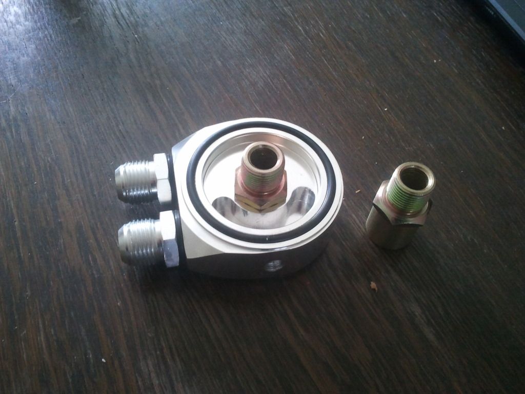

Starlet Wayne Posted July 19, 2012 Author Posted July 19, 2012 I've got a new one here mate £10 + postage ;)You got any pics? It's for a glanza ?
td04 glanza Posted July 19, 2012 Posted July 19, 2012 You dont really get car specific ones but yes the thread size and all are suitable for the glanza, you know that you need to grind away a small amount of the pas bracket dont you?
Idrees Posted July 19, 2012 Posted July 19, 2012 That's for an oil cooler mate, it has the fittings for pipes to run to an inter cooler. Link to buy ours here: http://www.id-workz.co.uk/index.php?main_page=product_info&cPath=3_8_106&products_id=369&zenid=e33ce20337ede8089a1b8763d3ecc6e8
td04 glanza Posted July 19, 2012 Posted July 19, 2012 All you do is unscrew them and screw your sensor for your gauges into it do you not, any unused ports get blocked off?
zebedee Posted July 19, 2012 Posted July 19, 2012 All you do is unscrew them and screw your sensor for your gauges into it do you not, any unused ports get blocked off?Depends on how it's designed if it's designed to flow oil to the cooler then back in if you block those fittings off with a plug or a sender then you will restrict the oil flow or stop it completly.
